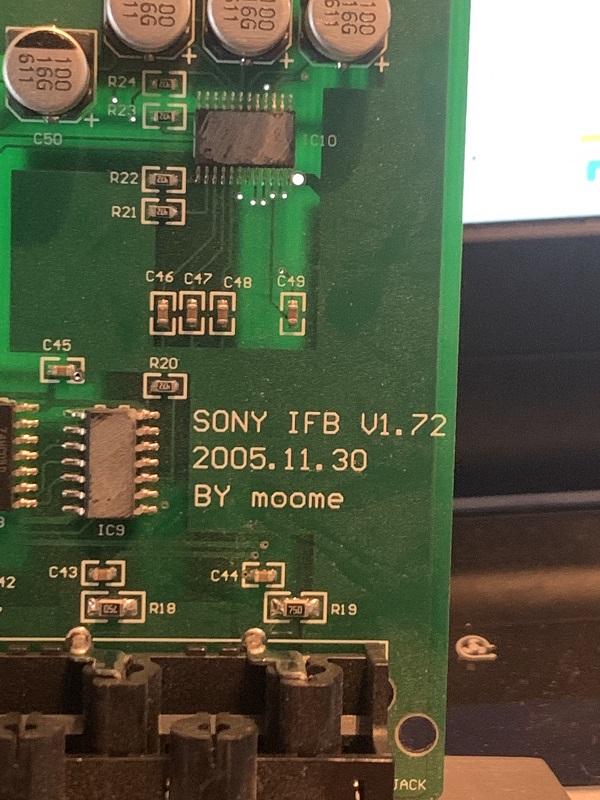

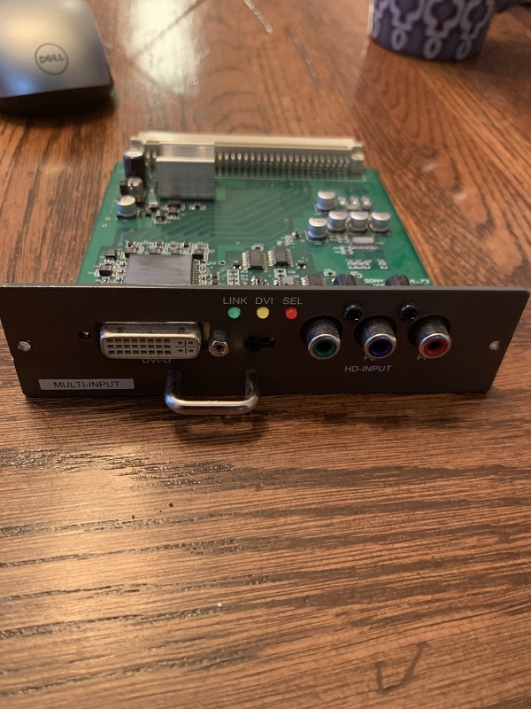

Hey Guys,
Finally got my G70 running. YES!! Now I’m trying to figure out how to get the Moome IFB-3D card working. I’ve tried three different sources, and looked through the latest manual. I can’t get an input signal. The link lights come on, and the remote works, but it seems somehow the signal isn’t getting where it needs to go. Any advice? Thanks!
Dan

The card was already installed in the projector when I acquired it. There was no box, or manual. Only the remote. I was going by what looks like the model number printed on the back of the card, which is IFB-3D. It looks identical, as far as I can tell, to the one in the link you provided (which also has IFB-3D printed on it), so I’m assuming it’s the same thing.
I’ve tried with all three sources: Apple TV 4K (720/60P), Nintendo Switch (720/60P), and Oppo BDP-103 (1080/60 and 720/60P)i). At this point, I’m convinced there is some setting in the G70 that I need to adjust. Either that, or something is wrong with the card. I’ll continue fiddling, and see what I come up with. Thanks again!

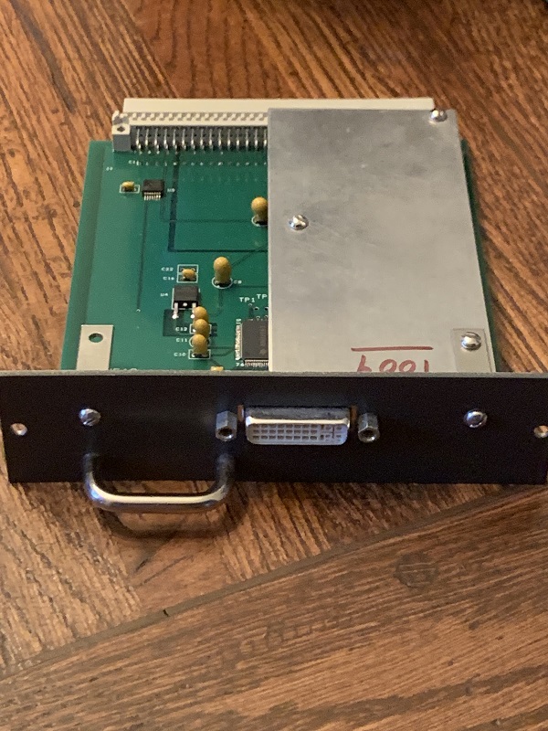

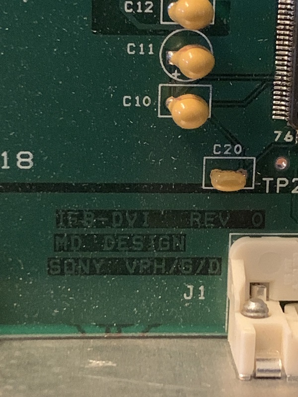

I have a couple of cheap options for you to keep in mind.
Dan

Ooooohhhhhhh…neat. I emailed Moome. Hopefully he’ll get back to me. Whether I have to replace it or not, I’ll definitely keep that in mind. PM me a price? You don’t happen to have a set of spare tubes you’ll part with, do ya? Thanks!
Dan
