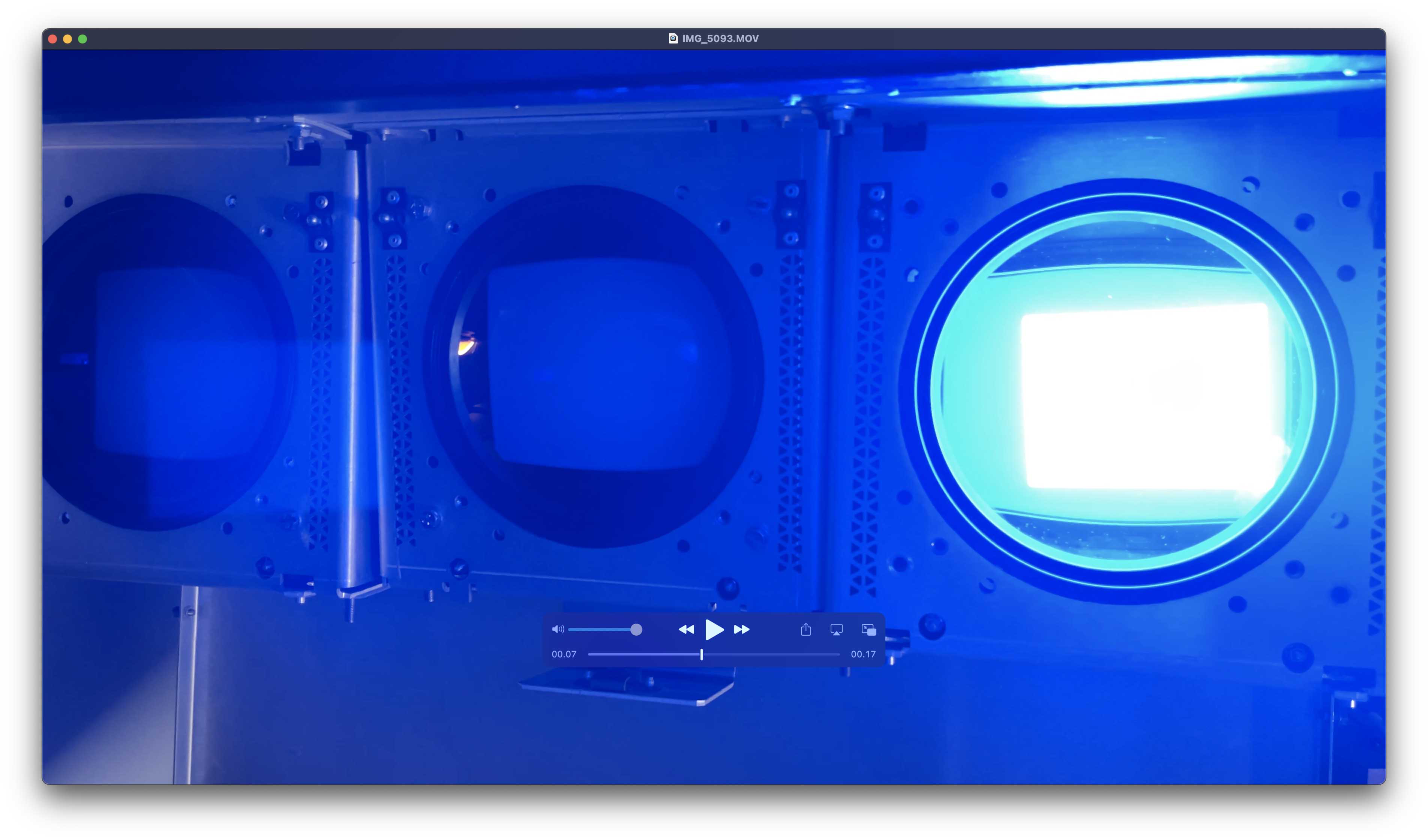

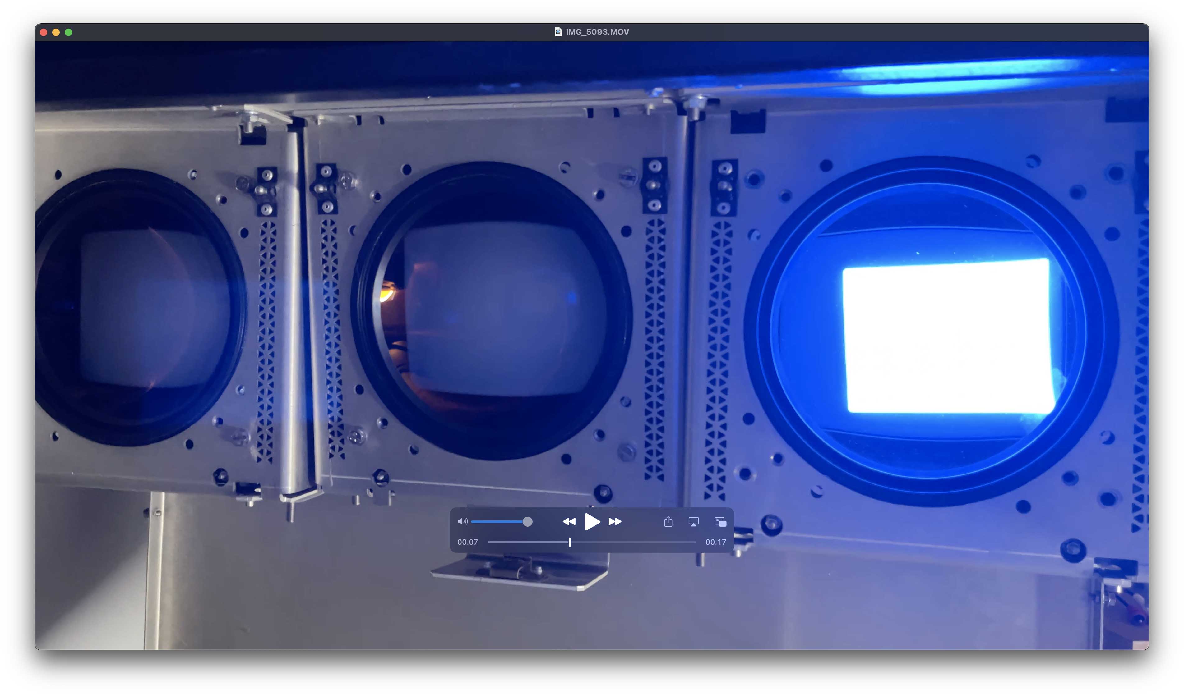

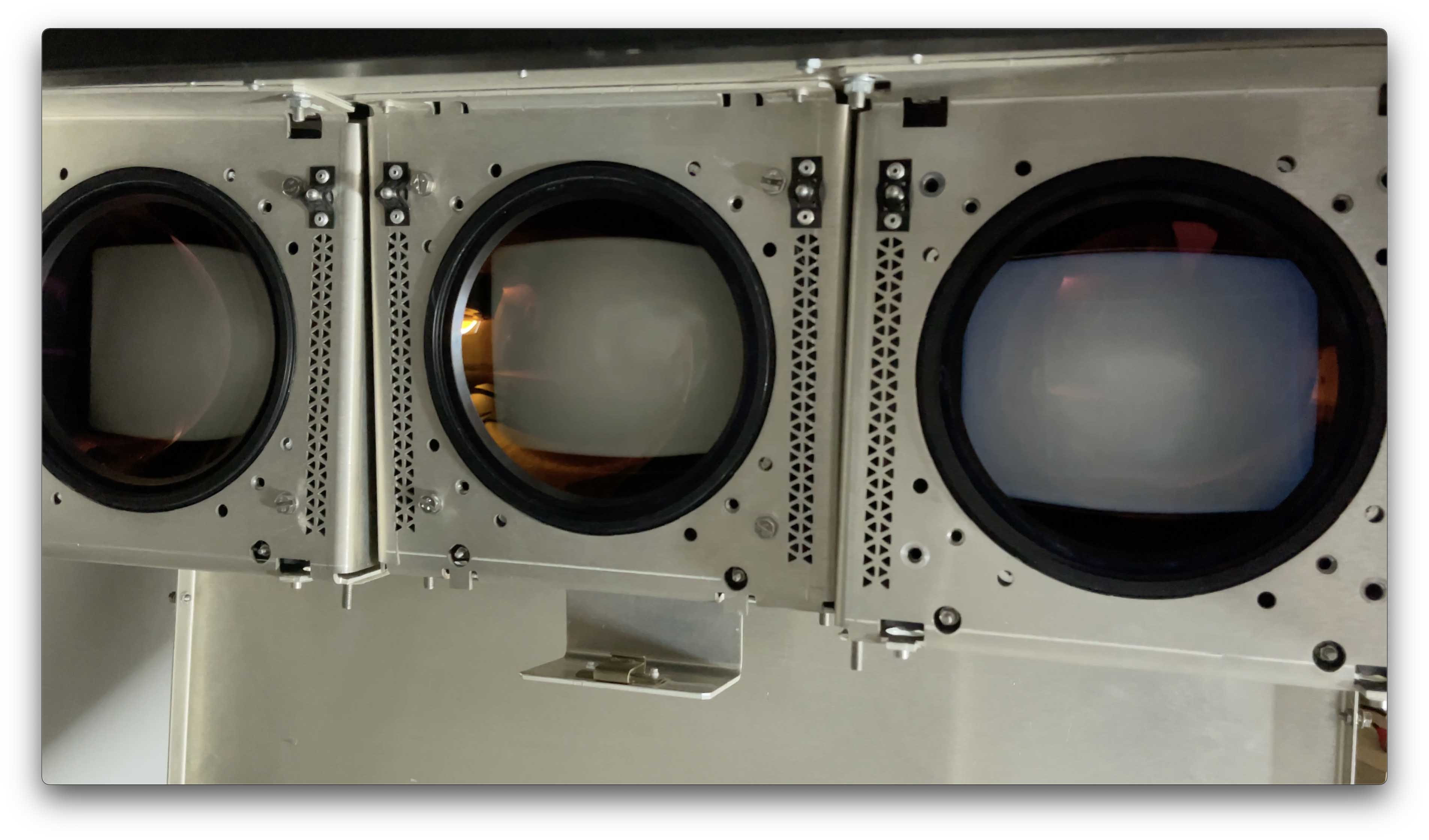

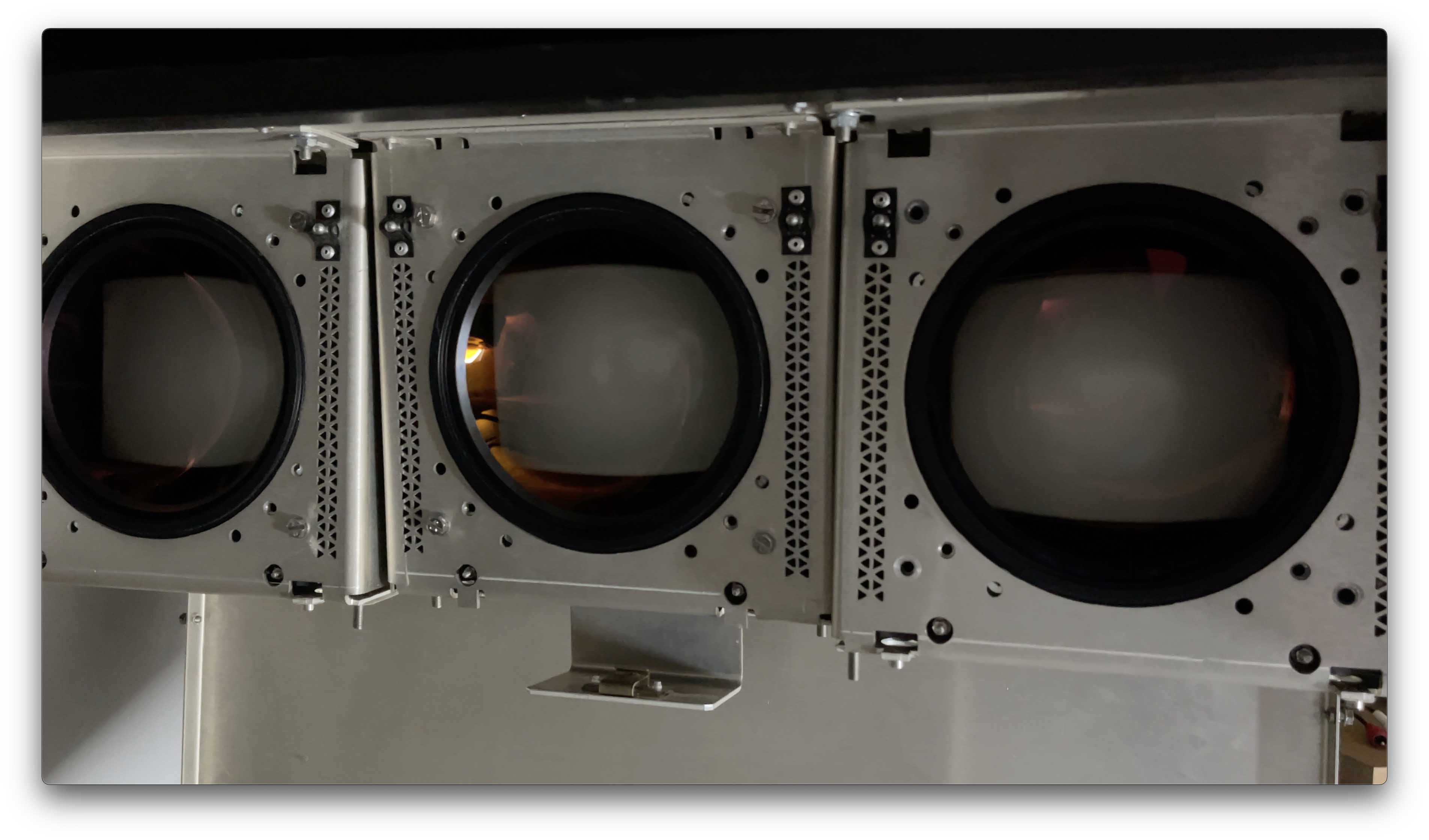

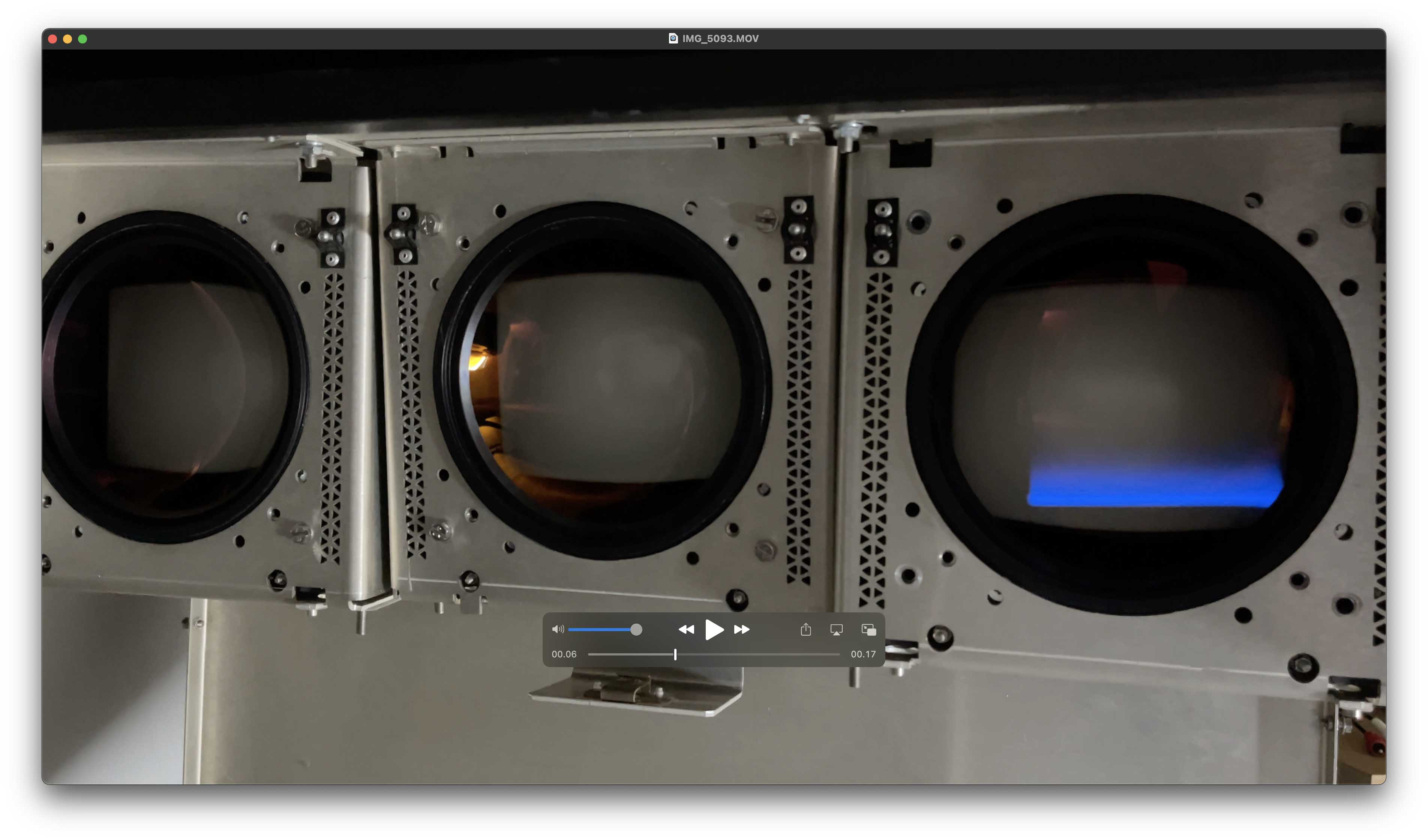

Finally, after searching for more than 1 year I got a new blue CRT tube. But when I turn on the projector after installing the new tube the following happens:
1. The new blue tube turn on first.
2. The blue tube get very bright.
3. The projector shuts down (I think this a safety feeature).
4. No light in the green and red tube.
When I disconnect the blue tube again, the green and red turns on normally.
I have attached 5 pictures showing the start up process of the projector until in shut down ... takes totally around 5 sek.
Any ideas ? Smile
Cheers frem Denmark
Flemming
... and brighter
 Filename:  Photo 4_ 2021-07-01 kl. 12.51.00 copy.jpg
 Filesize:  208.36 KB
 Downloaded:  246 Time(s)
Blue CRT gets brighter
 Filename:  Photo 3_ 2021-07-01 kl. 12.50.39 copy.jpg
 Filesize:  234.84 KB
 Downloaded:  256 Time(s)
Blue CRT fires up
 Filename:  Photo 2_2021-07-01 kl. 12.50.31 copy.jpg
 Filesize:  221.12 KB
 Downloaded:  229 Time(s)
Projector just turned on
 Filename:  Photo 1_ 2021-07-01 kl. 12.50.20 copy.jpg
 Filesize:  211.37 KB
 Downloaded:  239 Time(s)

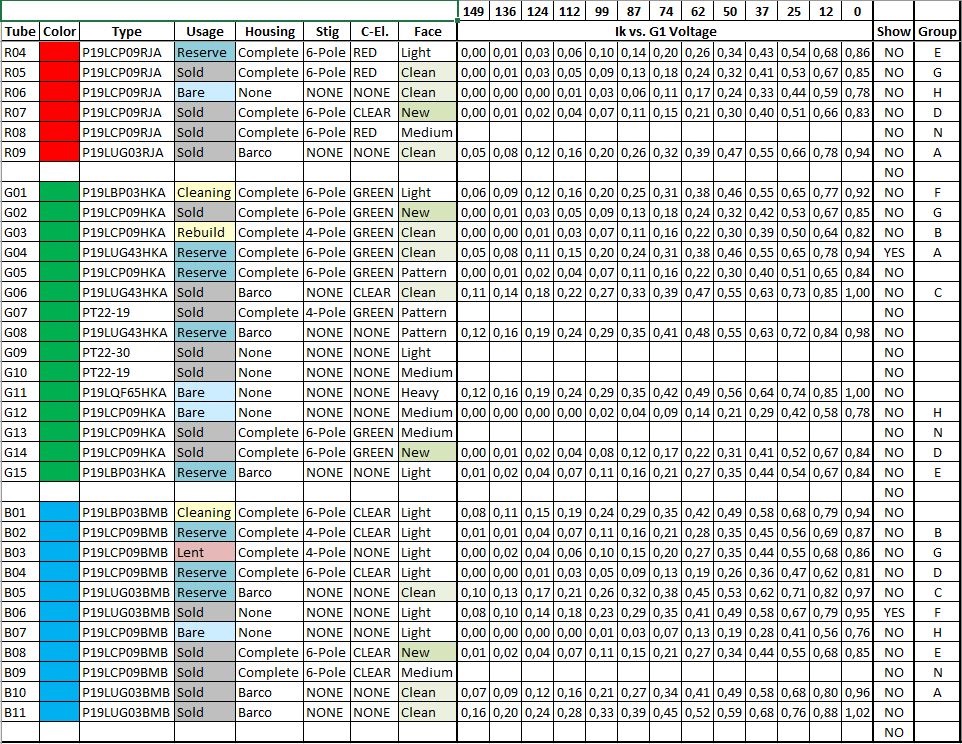

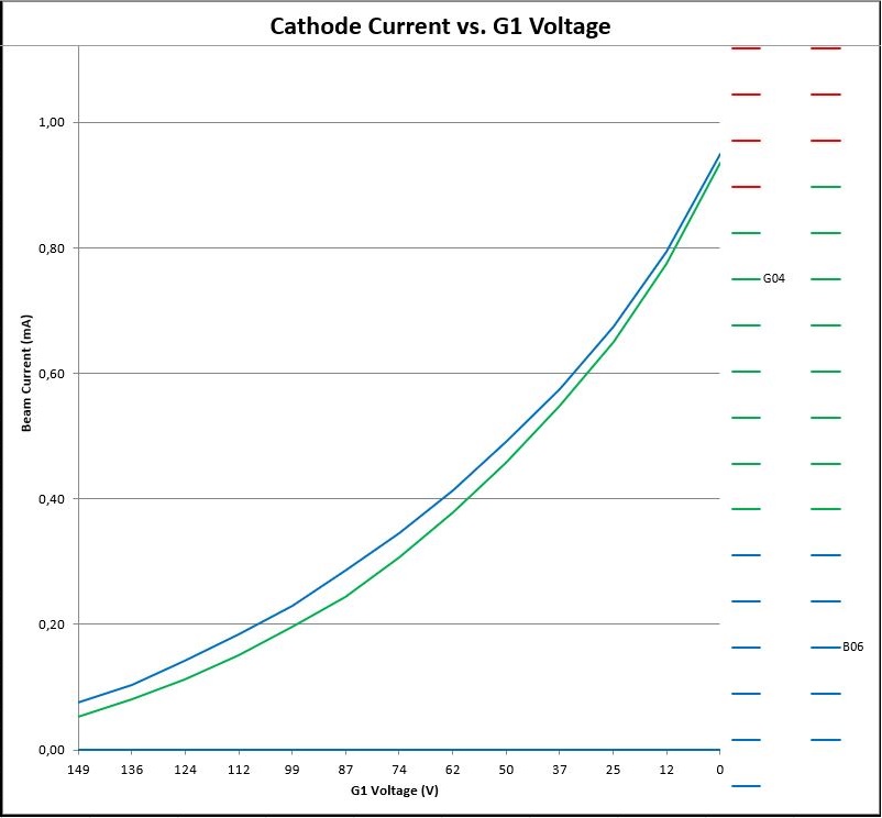

I had this bare blue LUG with minimal wear sitting on a shelf for a few years (intended to be used in my Marquee which never happened). When I purchased this tube I had connected it to my tube analyzer/restorer and checked it. It didn’t show any anomalies (shorts etc.) and I was able to plot its sensitivity which looked nice and normal. So I offered it to him and tested it before mounting it into the Barco housing that Flemming provided.

Adding here the measurements for the blue tube in comparison to a green LUG...
 Filesize:  74.21 KB
 Viewed:  7128 Time(s)
 Filesize:  471.46 KB

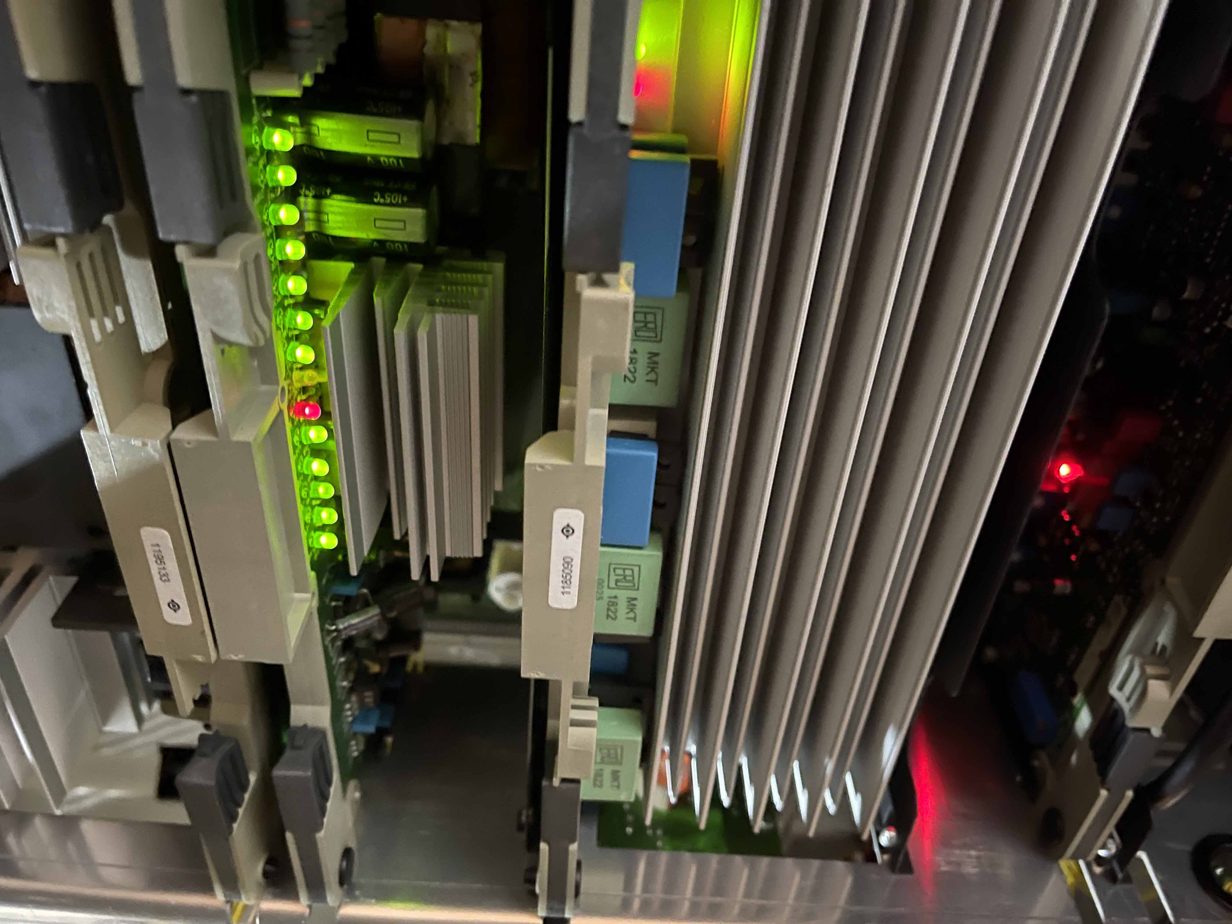

Posted: Sun Jul 04, 2021 3:22 pm    Post subject:
Hi again
Did some testing:
1. Disconnected the blue tube and took it out of the projector.
2. Disconnected the green tube and then attached all the wires from the green tube to the connections for the blue tube. So now the green tube is connected like it was the blue tube.
3. Turned on the projector ... and now NO picture at all (nothing in the green and nothing in the red ... blue not connected). Same result with and without videosignal connected and no start up Barco picture.
4. Then reconnected the green tube to all its original connectors and now still NO picture (so now in a worse position than when I started).
I notice that it dosent sound like high voltage is supplied to the tubes ... but not sure.
I have attached a picture that shows that now 3 red diodes is turned on (one on the mome HDMI card).
Any ideas?
Thanks for all your help!
Cheers
Flemming

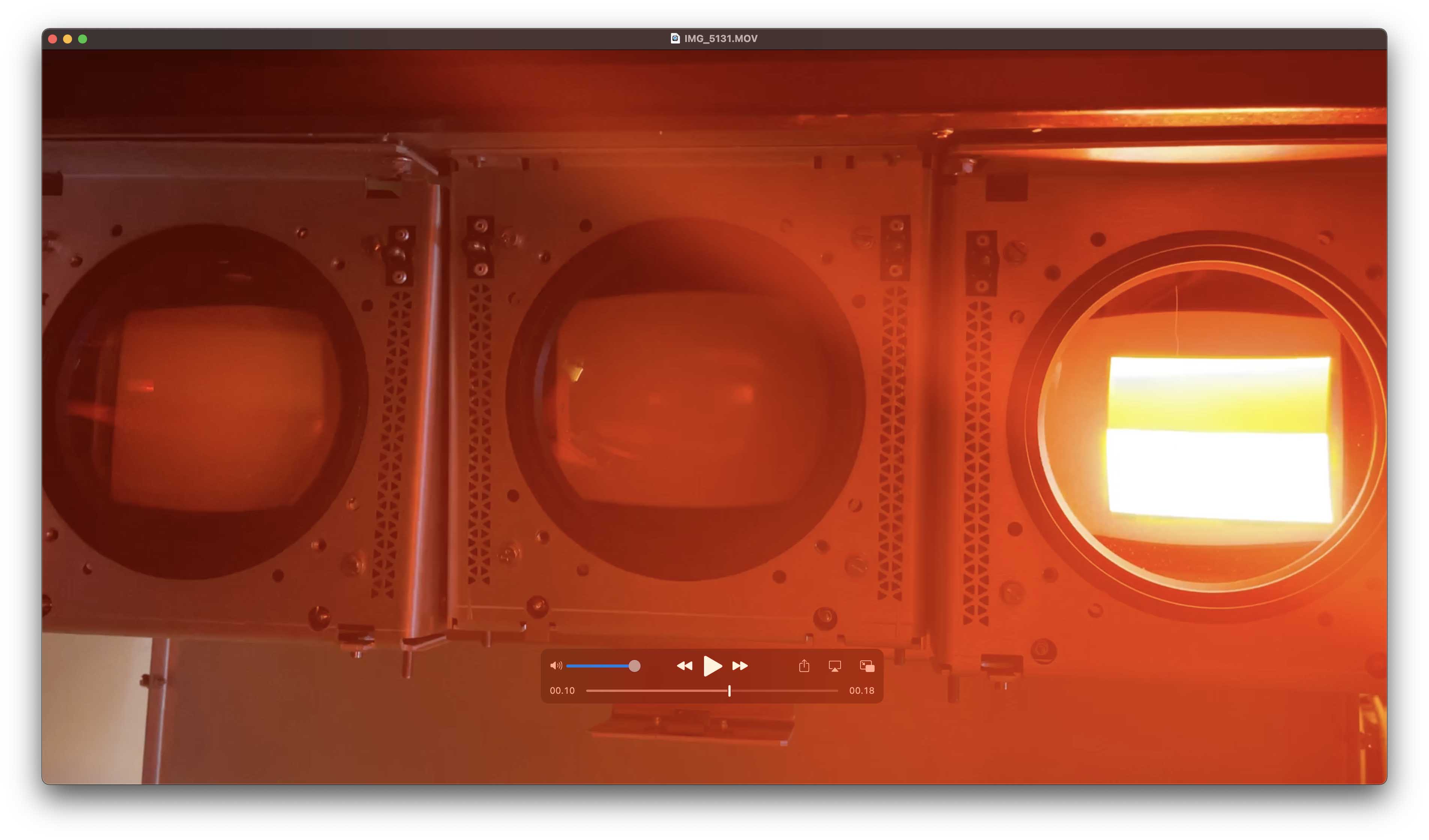

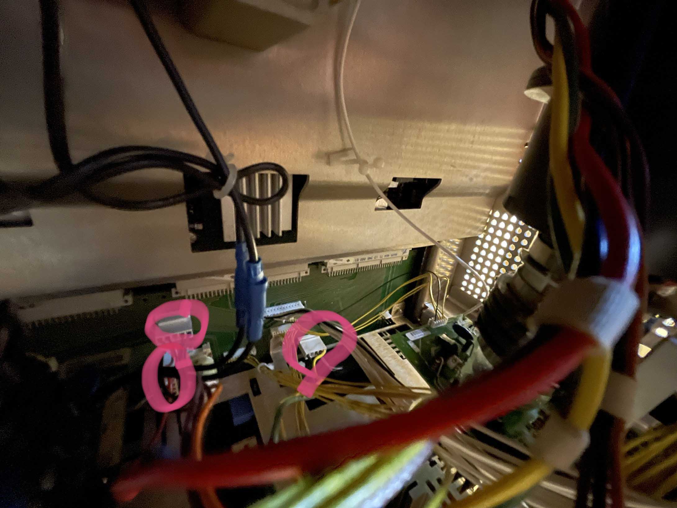

I have now swapped the red and the blue tube so that the red now uses all the blue tubes connections (found it easier so swap those two instead of the green and blue).
And now the red tube does what the blue tube did ... it turns on as the only one ... gets bright and the projector shuts down (see attached pic).
Then I disconnected the red tube and turned on the projector with only the green and the new blue tube (in red's place). And the blue tube works perfectly ... so NO problem with the blue tube.
One issue that are making me a little worried. Could I have connected one of the wires for the blue tube wrong? ... especially the 3 connectors with 4-5 pins makes me worry as they can be placed in both directions ... and as it is a long time ago I removed the blue tube I am not 100% sure I remember correctly. I have looked at how the 3 connecters are turned on the green and red tube and done the blue tube the same ... but is this correct? The connectors for the blue tube are not placed the same way (similar order) on the motherboard as the green and red ... so one of the connecters might be turned 180 degrees (see picture 2) ??
All ideas wellcome Smile
Cheers
Flemming
the 3 connectors I talk about
 Filename:  IMG_5133.jpg
 Filesize:  193.57 KB
 Downloaded:  221 Time(s)
Red tube in blue tubes place
 Filename:  Red tube 2021-07-04 kl. 19.58.11.jpg
 Filesize:  179.35 KB
 Downloaded:  211 Time(s)
Posted: Sun Jul 04, 2021 7:20 pm    Post subject:
Those are yoke connectors, Worst case, the image ends up being upside down or backwards.
Have you put the blue CRT board onto the green tube?
