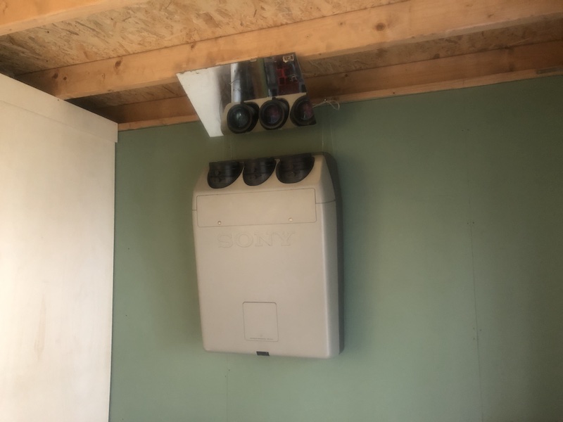

Hello i have recently succeeded in mounting my G70 and I am running into some things that i am yet to comprehend.
I realise its a long post on information that is not used a lot anymore so any pointers you can give me are greatly appreciated.
First off i know i am doing things backwards. I first mounted the PJ and screen and now i am starting to do the setup.
The PJ is hung on the back wall of my shed to have as much throw distance as possible. I am bouncing it via a first surface mirror i got from a rear projection tv.
I measured everything with a laser measure
3,43 metres from wall to wall
3,63 from wall to screen
3,29 from lens bounced of mirror to screen
From a diagram i found in the manual from the previous owner i think the PJ was calibrated on a projection distance of 2,52 metres, so maybe i should mount it on the ceiling ?
Because if I subtract the length of the PJ from my distance wall to screen i get 363 - 94,8 = 268,2 which is a lot closer to what it was initially calibrated

What i can do in the limited space i have is i can move the PJ around on the back wall or even mount it on the ceiling.
The idea that i have now and is that i need to get the projection square and aligned so i can actually read the menus and then move the projector a bit to centre the image on the screen.
So to sum up my situation to give as much info as possible.
Distance between the 2 walls of the shed is 3.43 mtr
The throw distance is 3,29 mtrs.
If mounted on the ceiling it would be 2,68 metres
I havet a first surface mirror.
The screen is 107 inch 16:9 format and can slide to the right if necessary or i could make a permanent white wall and ditch the screen.
It looks like my PJ has nec tubes so they are not bell shaped so i can not put the raster all the way to the side.

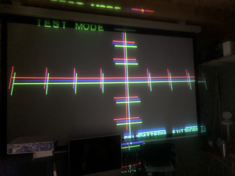

1.Looking at the pictures is it safe to make all the adjustments through the menus ? As to not damage the tubes.
2.Is it possible to make the the projected image smaller to fit the screen or is this mainly done by moving the PJ ?
3.Do i need to mount the mirror at 45 degrees or can i see what works ?
4. If i need to do the rasters with my nec tubes how do i know i went to far ? I cant put them all the waty to the sides ?

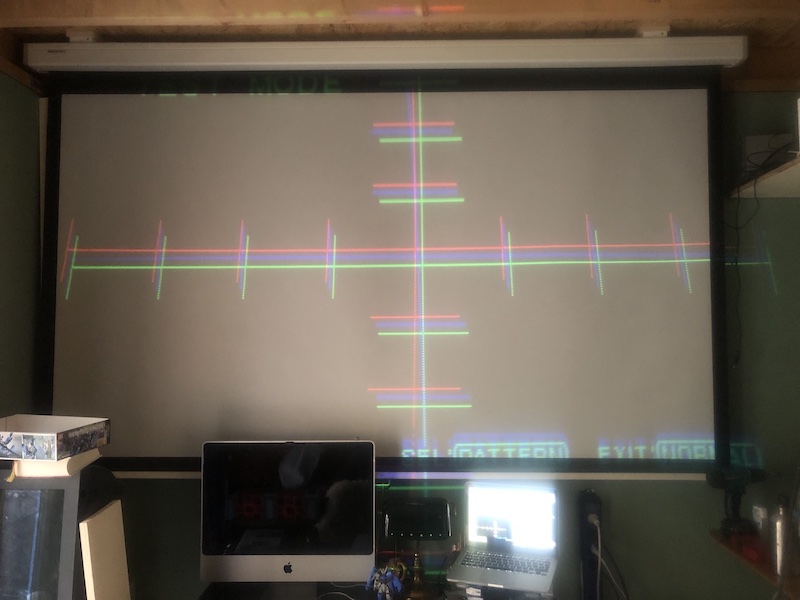

Judging by the misalignment i think i have to move the PJ closer to the screen and a little to the left.

Posted: Mon Apr 12, 2021 5:37 pm    Post subject: Re: G70 set up Questions.
Just so that you know (you may be fine), CRT projectors have a FIXED throw distance for a given screen width. There is only one correct throw for a specific CRT projector model for a specific screen size. Everything else will either not fill the screen horizontally (projector too close) or use too little of the projector tube phosphor width (projector too far).
See the instructions here: http://www.curtpalme.com/TubeCondition_PoorInstall.shtm
to maximize tube life even further do the following steps:
Put the projector on the cart or simply leave it on the floor so that you can move it.
Display something that fills the screen entirely (like a grid test pattern).
Using only the green (middle) tube, look into the tube and increase the image width on the tube face until it is around 1/8" to 1/4" from the edge of the white phosphor. Under no circumstances should you allow the image to go off of the white phosphor surface!
Move the projector back and forth until the image fits your screen.
THAT is the correct throw distance for optimal phosphor usage.
It'll usually be 5-8% closer than what the manual tell you because the manual throw instructions are conservative since they make you install blindly without even looking in the tubes at all.
No different than if you're using mirrors. They just allow you to have the throw you need in a tighter space.
Ignore all the math and calculators. Actually look into the green tube and do it that way. It's more accurate as you can actually SEE where the image is in relation to the tube surface instead of blindly relying on calculators (which tend to be non-optimal/pessimistic).
Keep the active image on the phosphor surface and you'll be fine. Your raster (the 'canvas' on to which the image can paint) can go off the surface, and is often done to reduce ringing on the left side. You then use blanking to ensure that you never move it off accidentally. All this said, having an active image off the phosphor surface for a few seconds or even a minute is probably not going to do any harm. Over time the heat can damage/crack the glass. Keep your contrast down low while doing all this setup (which you kinda need to anyway as you'll be looking directly into the green tube) and you'll be fine.
Again, there is only one correct throw distance for a given screen width. That's where the phosphor usage is maxed horizontally.
Not sure what or why you're asking. Use a mirror any way you like or need to to get things to fit.
Look in the tubes, keep the active image area on the phosphor surface. You'll know you've gone too far if you're off the tube surface. You'll really know you've gone too far if the tube cracks and you have coolant leaking out. Wink
Make sure you understand the difference between raster and active image area. Read everything here: http://www.curtpalme.com/TubeRasterSetup.shtm
Good luck!

Hey I like the air conditioner you have mounted on your rear wall. Do you know it has Red Green and Blue light bulbs in it? Laughing
I would go ahead and set all the setting in the menu's to 128 with the exception of color balance. You need the green cross hairs in the middle of the screen. The red and the blue will align to them.
Your first step is mechanical tow in for the lenses and tube assemblies . I think the G70 uses spacers like the other series but don't quote me on that. I've had hands on with D50 and G90 but never the G70. The reason for mechanical alignment is so you have enough electronic set up range. That's why I say set your menu settings to 128 ( this is mid point ) and do the mechanical alignment first them do the electronic. It's fun once you get the hang of it. My fist setup on a 1252 was hours and hours. Now I can have one to 90% setup in 10-15 minutes. Then you let it all heat up and do your final tweaks with the covers on the projector.

Ok thanks, i double checked and my screen size is 104 inch 16:9 which translates in mm to 129 x 230 so i should probably calculate my measurements with the formula from the manual.
Just to check for shure. This beamer is intended for 4:3 viewing right ? If i want widescreen I would have to set the rasters to widescreen and lose a lot of upper and lower fosfor ?
I saw someone who solved this by apperantly sliding his pj forward on rails if he wanted widescreen and backwards for 4:3 or did i understand that wrong ?
I am felling less daunted now. much thanks.
Posted: Tue Apr 13, 2021 12:50 pm    Post subject:
Again, throw away the formulas / calculators as they're not optimal. Set your throw this way:
- Put the projector on the cart or simply leave it on the floor so that you can move it.
- Display something that fills the screen entirely (like a grid test pattern).
- Using only the green (middle) tube, look into the tube and increase the image width on the tube face until it is around 1/8" to 1/4" from the edge of the white phosphor. Under no circumstances should you allow the image to go off of the white phosphor surface!
- Move the projector back and forth (increasing/decreasing throw) until the image fits your screen.
- THAT is the correct throw distance for optimal phosphor usage.
The phosphor tube surface is 4:3. You can any aspect ratio you like, you just use less height. Most people who used (or still use) CRT had (or have) 16:9 screens. I always did.
Correct.
If you do constant image height (what SMPTE recommends) when switching between the two that would work but would be very odd as CRT projectors are pretty fussy about exacting position never mind that they're very heavy and having precision rails to do this easily would be expensive. I would never do that myself nor have I ever heard of anyone doing that. I've always done constant width like most other CRT projector owners (CRT projector doesn't move).

Your first step is mechanical tow in for the lenses and tube assemblies.
I would say that toe-in is the second step.
First step is getting the right throw distance using only the green tube. Get that throw perfect. That's then where the projector lives forever.
Then angle the other two tubes in (called toe-in) to get them to line up with the green and continue with the setup.

BTW, the one confusing thing on Sonys is that the V shift is done on Zone 1 in convergence. The V shift on the keypad, with the individual buttons is fine tuning only. set those to midposition (128), and then use Zone 1 in the convergence for the master V shift. I used to get tons of emails about that from first time G70 and G90 owners.
Posted: Tue Apr 13, 2021 5:24 pm    Post subject:
You are correct, however since the air conditioner projector was already hanging off the rear wall I made mechanical tow in the first step.
He's already got the projector and bounce mirror set up, the screen is hung so if he did need to get throw distance I guess he could just change the projectors spot on the wall.
So yeah, he needs to set the active image area to the phosphor ( or wear pattern ) then slide the projector forward and aft to get the screen filling size. Then fold that number to get the throw distance from projector to mirror, and mirror to screen.

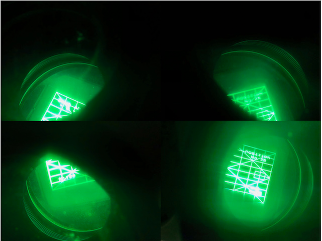

When i started i was hoping i could somehow finagle it so that i could make the projection fit the screen but after seeing all the horrible horrible tube wear pictures i am realizing that would be bad.
I tried going as wide as possible with the built in raster test pattern but i cant seem to get over the edges of the tube. I am using the size registration buttons. Because i wanted to see the wrong way real quick so i know what it looks like.
Does the raster need to be perfectly square when i look into the lens ?
The only v shift i can find in the manual is on the input settings menu is that what you mean ? Ill probably know what you mean when i come to that.
I have been peering into the lenses with a flashlight and to my disbelief i cant discern any burn in pattern the look completely uniform, no rectangles whatsoever not even a hint of any of the tube wear photos.

Then comparing the big grid green picture from the article to mine i would say it is ok, a little more would be nice. I made a collage because of the lens i cant capture the whole grid at once.
Also when i look into the lenses with a flashlight i cannot see any wear, so i got an 8 if not a 9 on the tubewear scale
Thanks.
 Filesize:  367.03 KB
 Viewed:  7491 Time(s)
Posted: Thu Apr 15, 2021 6:31 pm    Post subject:
Hard to tell where the phosphor ends in your pics.
Easier to see if you take the lenses off during the initial green raster setup, like so:
Don't remove the curve c-element (the lens element stuck to the tube face).
More: http://www.curtpalme.com/SonyG70_Layout2.shtm
