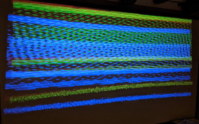

Well now I'm confused, I reset all the settings and now my input is messed up. It's like it can't sync the signal or something. I don't recall ever seeing this before and I've definitely reset the convergence in the past. Any idea what's causing this and how to fix it?

When selecting input the video signals and sync signals are handled separately on the VIM. The video signals are switched by the big blue relays, the sync signals are switched through electronic switches.
I've encountered once, that this electronic switch (well its driving logic) was not working properly.
Try to toggle switching input back and forth.
You can also check that without input signal does the built in test frequencies (UTIL-1-6) are working or not?

Posted: Wed Feb 17, 2021 11:21 am    Post subject:
Ok, seems to have fixed it by toggling inputs back and forth, thanks for the tip! I probably should have thought of that myself...

Posted: Wed Feb 17, 2021 11:25 am    Post subject:
bpdski wrote:
Thanks, I'll try that later today. I believe the built-in frequencies work fine, I can pull up menus and change settings fine. I tried two different sources into the Moome card with the same results.
Just to make sure I mean here switching input on the Marquee (SOURCE-0-1 then SSOURCE-0-2)

Posted: Wed Feb 17, 2021 11:28 am    Post subject:
Yep, that's what I did and that fixed it, thank you!
