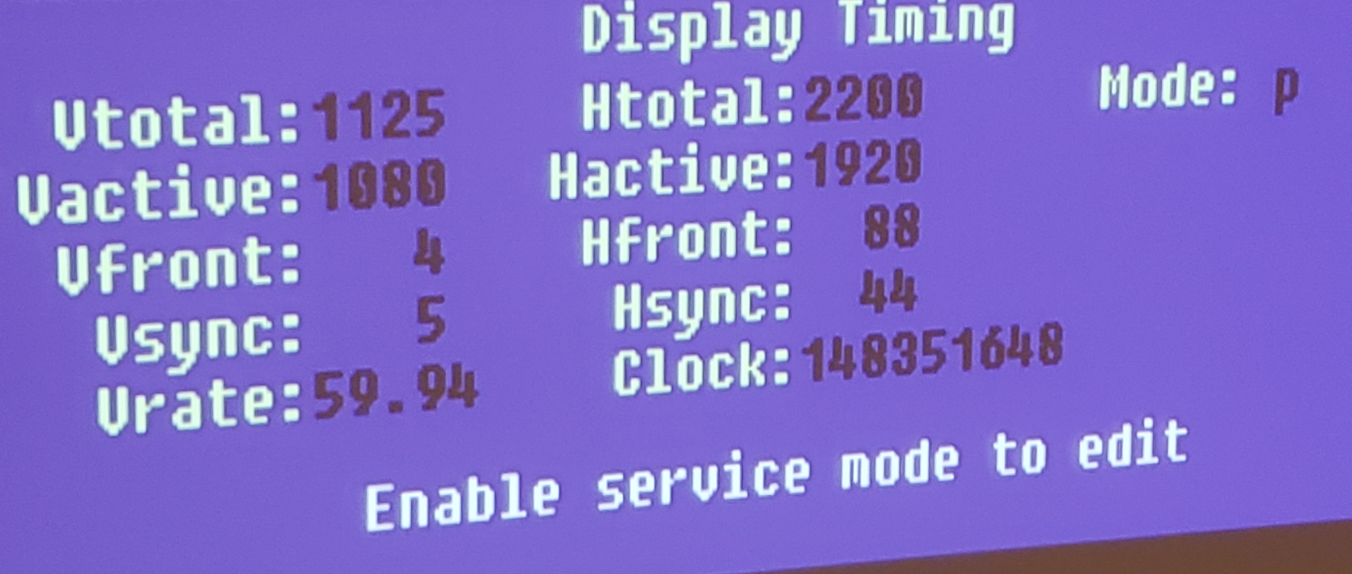

Here is the current timing...
 Filename:  20210213_203330.jpg
 Filesize:  480.16 KB
 Downloaded:  294 Time(s)

Firstly, you do definitely need a better HDMI cable and I would strongly recommend Ruipro sold on Amazon. They are active fiber cables and work almost 100% of the time. You should not be getting the drop outs you describe regardless of the timings in the Lumagen. You can't overclock 1080p 60Hz when your cables are already giving you problems.
The 2123 has limited timing output compared to the 2143. Jim and I talked about this years ago, and I know we decided to set the clock quite a bit higher than 1080p 60Hz's standard clock rate so that CRT people could do things like increase porches to reduce ringing. What I don't recall is where we set the max clock. Maybe we went all the way up to 195 MHz, but I don't think so; I think we set it at 155 or 165 MHz or something around there. When you increase the clock and Htotals, always check in the Marquee menu that the signal is indeed stil 60/1.001 Hz and not something lower. If it is lower, that means you are beyond what the 2143 is allowed to throw.
You can download my clock calculator here:
http://www.cir-engineering.com/bin/clock_calc.xls
With an Htotal lines of 2300 lines the clock requires 155094905 Hz. I think the 2123 may be able to do this. If not try 2275 lines and recalculate the clock. When I had Patrick modify the firmware for a higher clock, the primary goal was to allow LG projectors to properly run 1080p 60Hz without cropping the image so it wasn't for Marquee optimization.
2300 lines won't be enough to remove the ringing, but it may be enough to push it further off the screen and improve things for you. Try 2400 lines and see if the 2143 will do it, that would be better. Also, don't center your image in the raster, push the image far to the right to get it away from the ringing. Use a small cross hatch patter though and watch the squares on the right as you move the image in the raster. On the Marquee, the right side of the image will start to get compressed (the squares will turn into rectangles) before you make contact with the far right side.

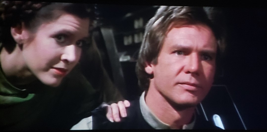

Here's a shot captured with a cell phone from the 1080p60 LD upscale while it was playing... I haven't messed with anything yet. It's just scaled with default settings on both the DVDO and Lumagen. Yes, it's SD, and you can tell it is, but it's definitely something I don't mind watching on a 120" screen. This is upscaled from a 2.35:1 letterboxed CLV disc. Actually kind of impressive!
