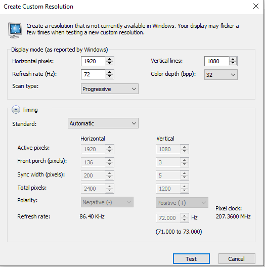

After setting up / aligning everything I wonder why my testing screens are so much bigger than my actual 1080p/72hz (PC) is so much smaller - I am already @ Max RGB size but not able to fill up my screen while in the test screens go way over my screen borders.
What am I missing?
Thanks for helping:)

The question is what timings do you use?
Display devices have a so called retrace time that is needed for the electron beam to return from the end of the line to the beginning of a new line. This time is specific for each display, and often dependent of the actual scanrate too. Display timings have to accomodate to the display's retrace time to properly fill the raster.
Unfortunately the 1292 brochure does not tell the actual retrace time, but I believe it should be farily short. Anyway, you have to experiment with advanced display timings if your VGA card allows to do this from driver, otherwise you have to use some external tool, like CRU.
You have to get familiar with porches and sync width etc. you can find some explanation about these here.
I guess that you would need a total horizontal pixel count around 2400 for 1080P 72Hz, now you have much more therefore you can't properly fill your raster.

THANKS!
I never knew this was something, thank you so so much for all the advice / help you have provided!!
Running HDMI from my PC to an Amp and from my Amp to the Moome card.
I cannot get my head around CRU- it's too complicated I am afraid.
The Nvidia panel - I suppose offers something similar and changing the 'total pixels' here made the difference I have been looking for.
If you have more suggestions on how to improve, please let me know.
The explanation on sync times etc- I understand it but not sure how I can influence this through the Nvidia control panel, and even if I could.. how would I know what to add.
Once again, thank you so much- truly appreciate it!

Posted: Wed Jan 06, 2021 6:53 am    Post subject:
For 1080P 72Hz aim for horizontal pixels around 2400 and for vertical plane to around 1125, as for porches and sync just distribute the numbers evenly Smile This will save you some bandwidth.

Posted: Wed Jan 06, 2021 3:10 pm    Post subject:
Dear Gjaky,
Will try 1125 in the evening- what do you mean with distributing the numbers here evenly? - what are those numbers doing anyway?
While the image is large and filling up the screen I want to, with these settings from my previous post I do get horizontal scan lines- not very visible- but visible.
Lastly, I have a Lumagen XE video processor as well, however would you recommend using this box at all or is what I am doing through PC > AMP > Projector just fine?

Well I do have horizontal scan lines that I'd like to get rid of, so I do need to tweak the settings I suppose.
What do you mean with the distribution of those sync figures, they should be equal?
Why is it good to have more bandwidth anyway- what does that do to quality?
Can you snap a picture what you mean?
roughly yes, so if you have total number of lines say 1125 and the active image is 1080, then you have 45 lines left to distribute among front porch, back porch, and sync width. You can make it 15-15-15, or 10-10-25, the point is do not make too much difference eg. 1-1-43 or the like.
With raster scanning the electron beam draws the picture line by line. If you consider horizontal lines those are toggling on and off your perceived resolution depends on how much the lines are overlapping, which is mainly depending on optical parameters (like meam size and lens resolution). If you consider vertical lines those are changing on and off pixel by pixel, then you still have the optical limitations as previously PLUS you have an additional factor that is how fast you can control the intensity of the electron beam, obviously this is limited by the electronics within the projector.
Take a look at here 1080P 60Hz looks resolved on the NEC 9PG xtra on the picture, as the vertical 1:1 line box and the horizontal 1:1 line box is about the same brightness, at 1080P 75Hz and beyond this is not the case anymore. In practice this means the picture will loose fine details if the bandwidth is insufficient, it is not just sharpness, more like better color tracking in a dynamic way.
