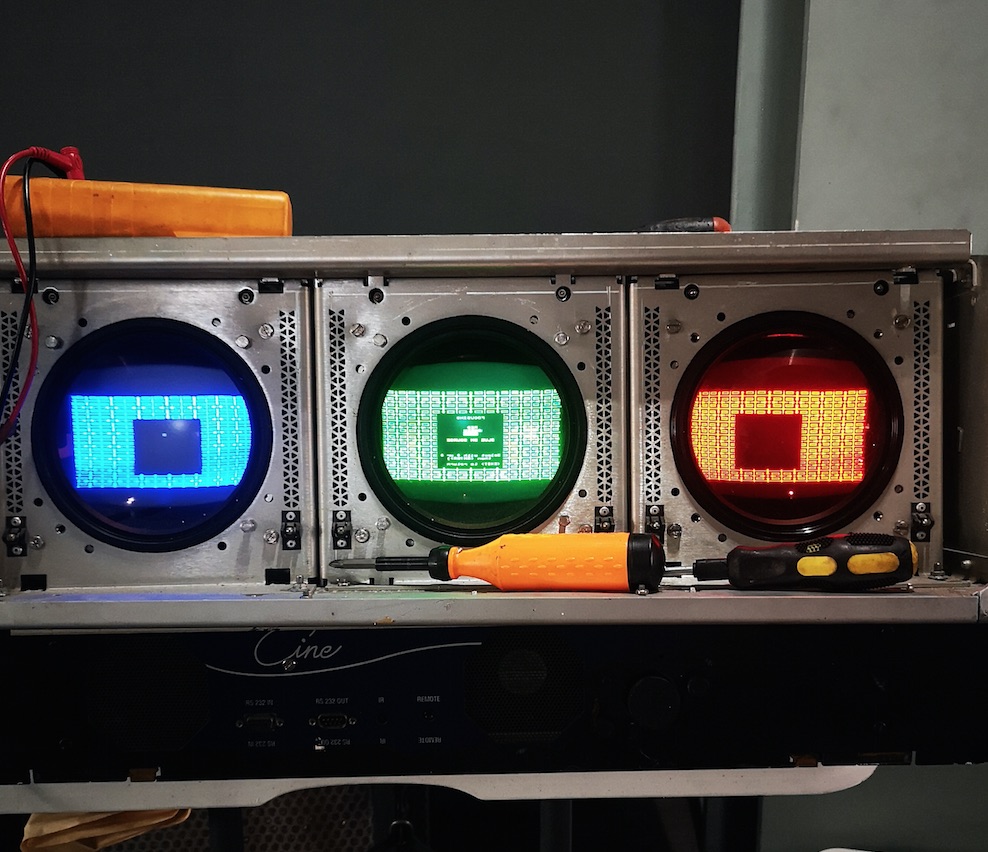

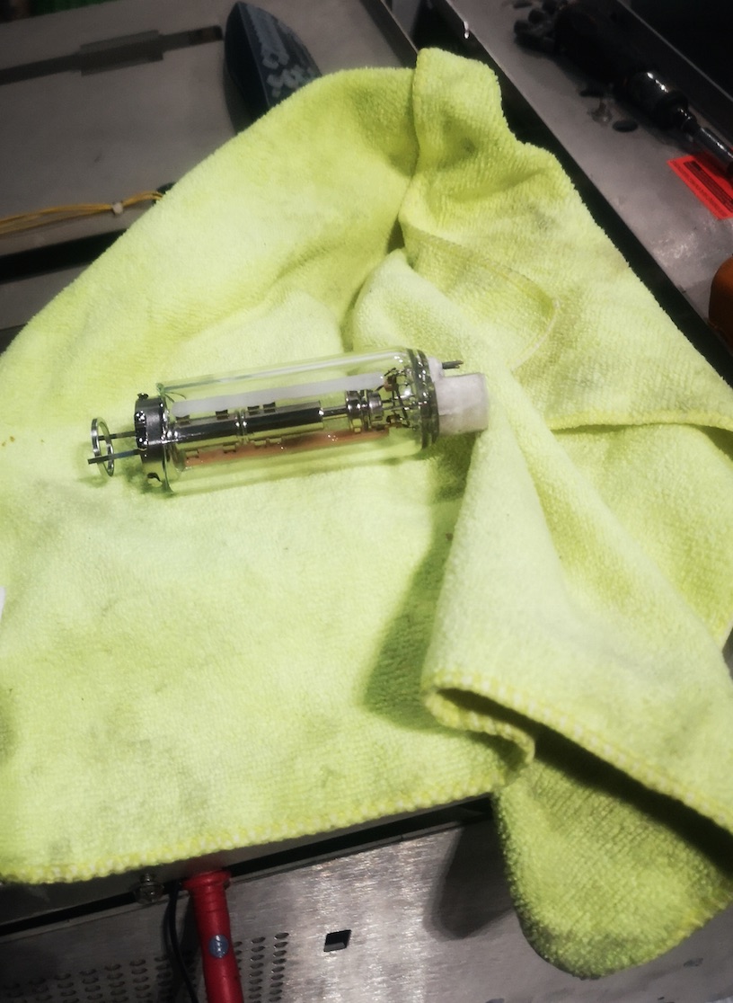

Posted: Sat Apr 17, 2021 4:04 pm    Post subject:
after 7 months,
This other cinemax is now fixed.
There was a crack in the red CRt, hidden iniside the focus/ deflection Unit.
Very excited and planning to replace the Barco tubes with rebuilt simulation grade CRTs,
Looking for offers and suggestions for CRTs source.
