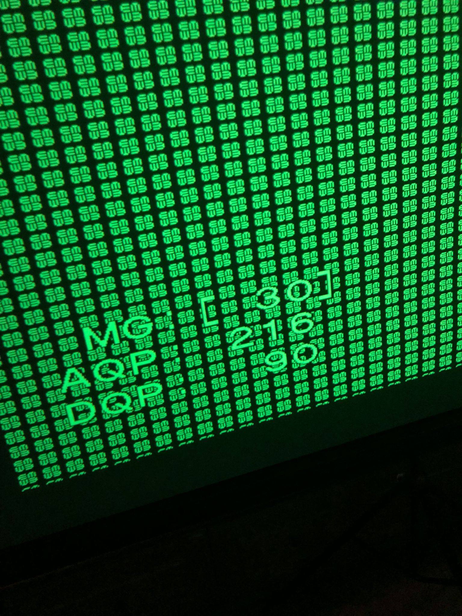

My Sony VPH-G90 sadly has focus issues on all three tubes. The fine focus controls, specifically the MG focus, AQP, and DQP just isn't working for at least 50% of each tube. I pulled out the YA Board from my projector to find that it has one of the good serial numbers on the IC421, 836A01E. Other details include that the Dallas Chip is about 22 years old and never changed.
Some people told me that it could be another issue on the YA Board that is not related to the IC421 chip, but also have told me that there could be another issue with a different board that relates to focus.
(There are some other issues on my projector, weird outlining, wavy horizontal lines moving, trouble with overscan, and a finger print smudge on the inside of the Red tube lens, but the main issue is the focus)
I'm no expert so I wouldn't know where to start, all advice and help is greatly appreciated!

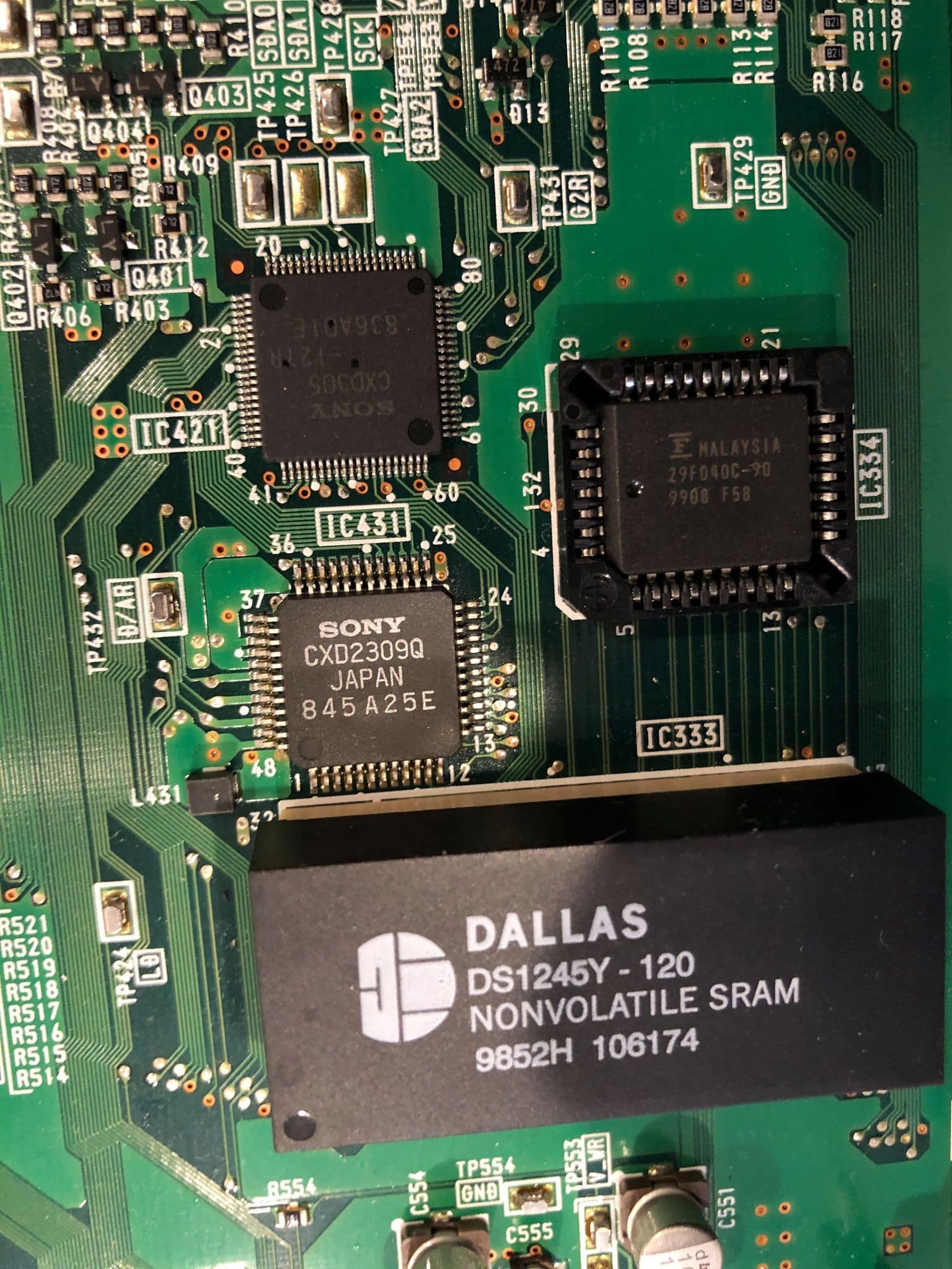

Whats the SN on the Dallas? I have a hard time believing yours is working after 22 yrs more than twice the theoretical life expectancy.

Posted: Mon Oct 12, 2020 1:17 am    Post subject:
Here is a picture of the Dallas Chip on the YA Board

HaydnG90
Joined: 22 May 2006
Posts: 1356
Posted: Mon Oct 12, 2020 1:53 am    Post subject:
Wow, you weren't kidding week 52 1998. That battery must be nuclear powered

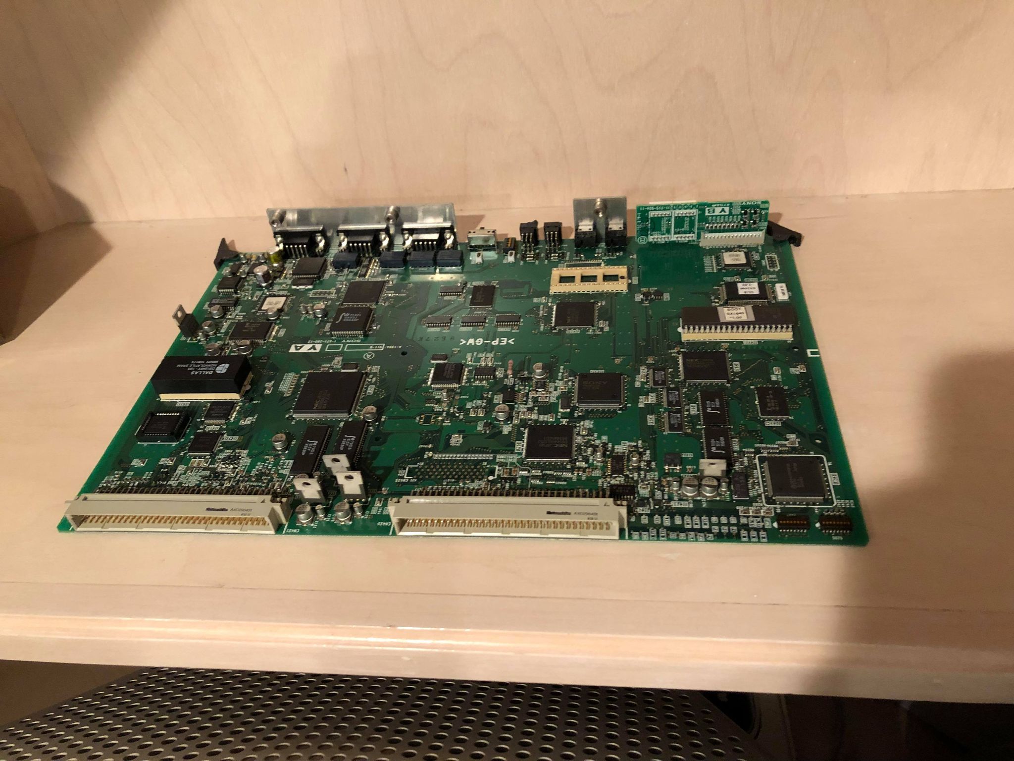

 Filename:  YA Board Alone.jpg
 Filesize:  350.04 KB
 Downloaded:  315 Time(s)

Posted: Tue Nov 03, 2020 4:33 am    Post subject:
harry27 wrote:
I can't believe the battery isn't even bulging on that Dallas chip. I hope it still has it's data when it gets to me Embarassed
