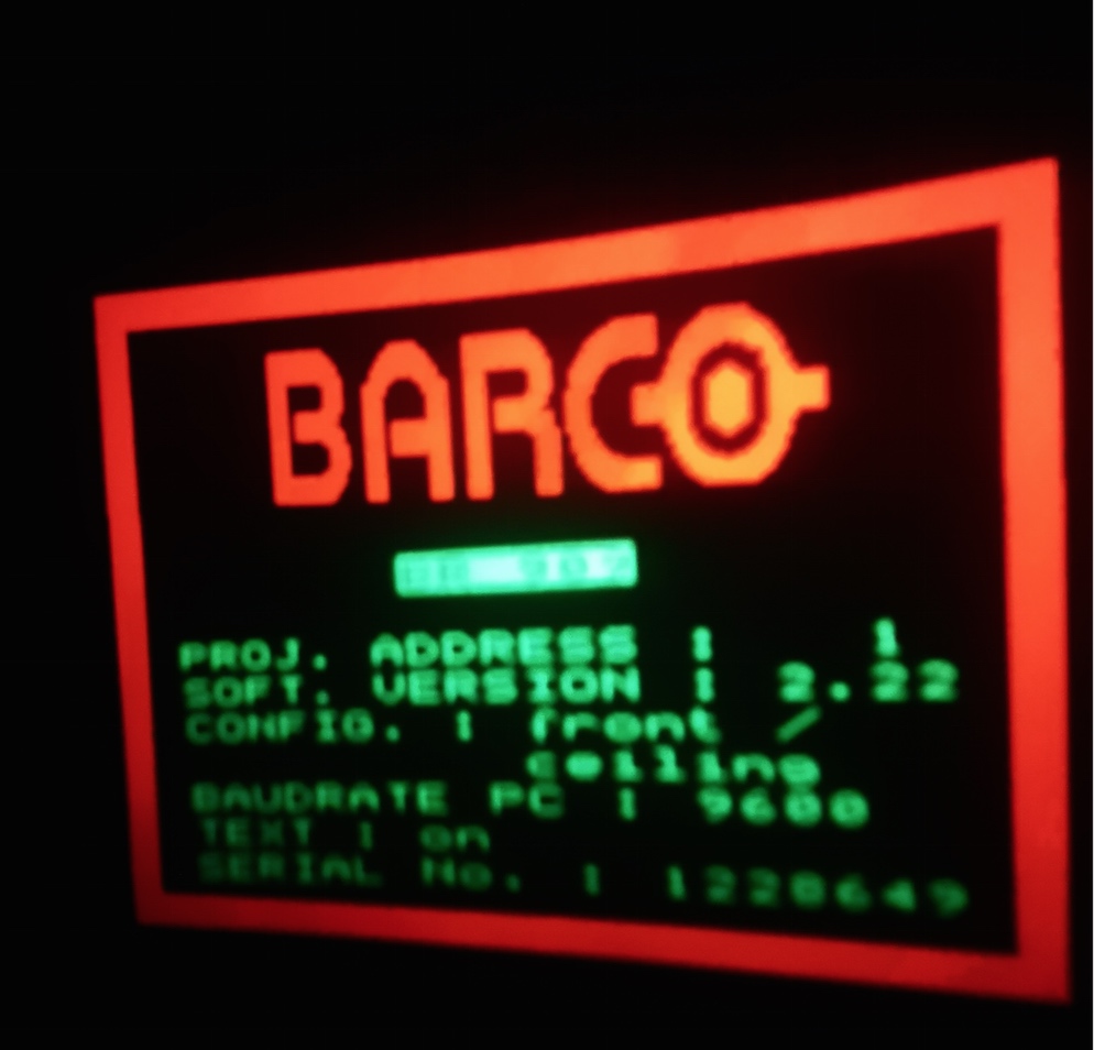

Posted: Tue Sep 15, 2020 3:39 pm    Post subject: out of focus pic
Here is the picture of my out of focus 909,
It is also shaky or modulating,
real HV issues that i can not find.

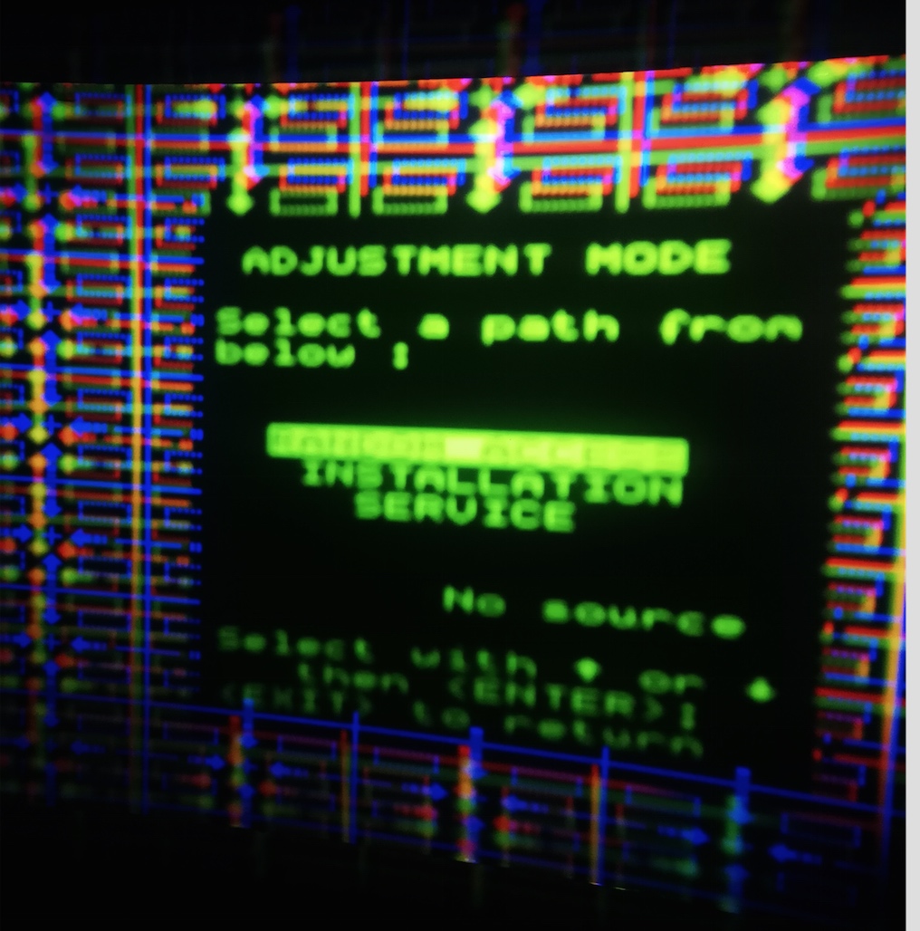

Posted: Tue Sep 15, 2020 3:44 pm    Post subject: another pic
here is another shot

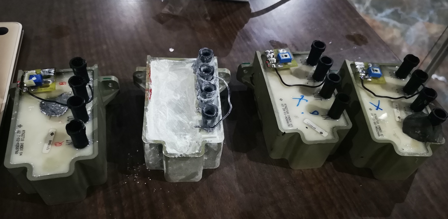

Posted: Wed Sep 16, 2020 3:16 pm    Post subject: the line up of guilty splitters
the line up :
the second one is up for an operation
