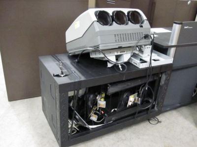

Go for the Sony D50, looks like a super famicom Smile
A flawless result with NES and Cine 9
https://www.youtube.com/watch?v=hcFlXATEiS8
