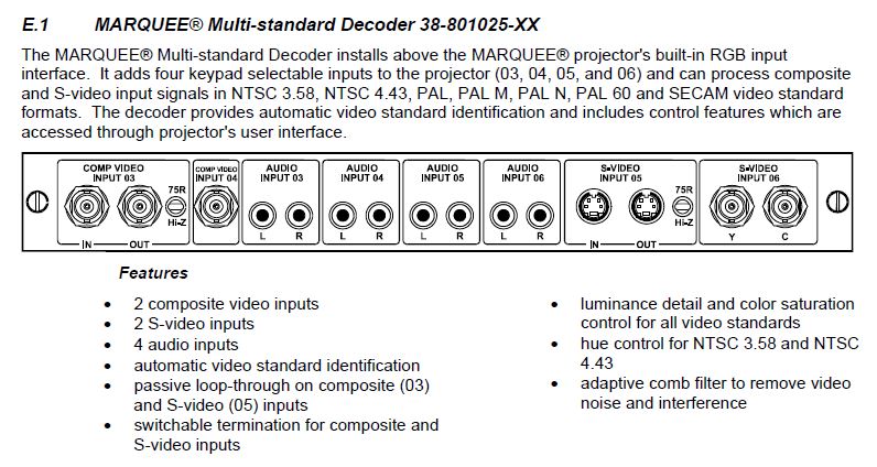

There is the Marquee Multi-standard Decoder which allows for displaying composite and S-video in various formats. Judging from the schematics, it does some kind of line doubling or de-interlacing using two programmable gate arrays and some memory.
Ah, and I have one...
 Filesize:  97.75 KB
 Viewed:  9845 Time(s)
Posted: Wed Sep 02, 2020 2:56 pm    Post subject:
Well, that's definitely news to me! With every module I've had here, it was always set to 480i output, the scanning lines were REALLY clear on the screen. Smile
Posted: Thu Sep 03, 2020 3:50 pm    Post subject:
Guys
I have never heard mention of line doubling with Marquee decoders. Fire one up and look at ** for the scan rate. Likely 15.75.
