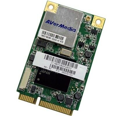

What is this antenna connector called?
Posted: Sun Jun 14, 2020 6:53 pm    Post subject: What is this antenna connector called?
What is the antenna connector on this AverMedia card called? It's to the left of the right screw hole beside the silver shield box.

Hirose U.FL, I-PEX MHF, IPX, AMC, or UMC

Now where do I find some 90 degree crimp on female connectors? I have to make a Hirose U.FL right angle to 75 ohm co-axial to panel mount F connector

Hmmm this connector is designated 50 ohms. I always though most TV applications needed 75 ohms. Interesting. That makes it easier to find cables.
