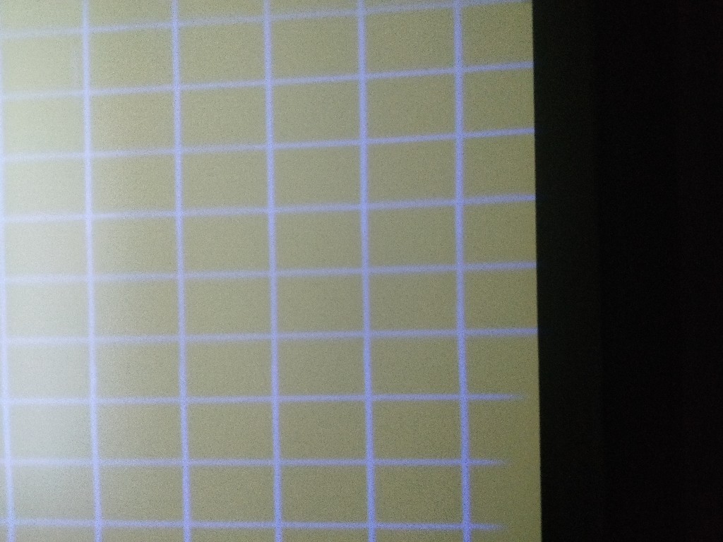

Posted: Mon Jun 15, 2020 7:35 am    Post subject:
All 3 are LCPs. They're a mixed bag age wise but that shouldn't be a problem.

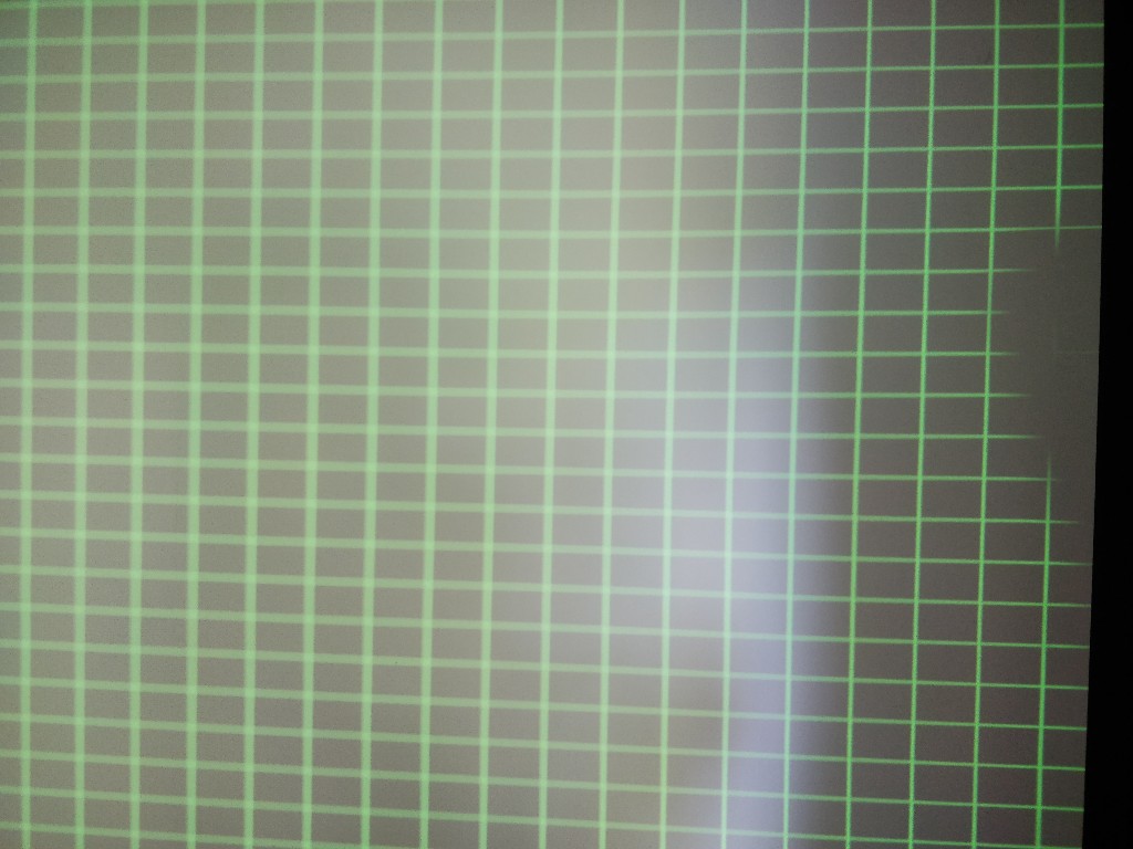

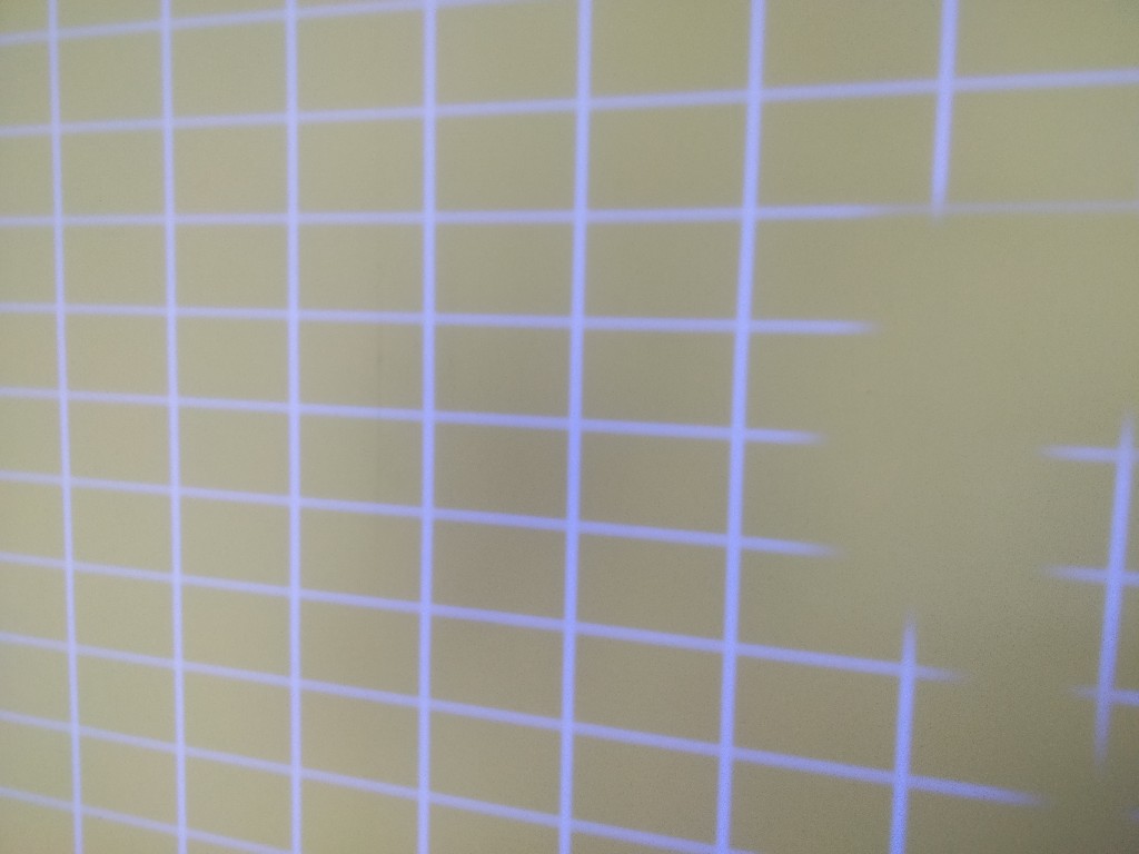

The behaviour is identical on all 3 tubes. Posted some pics with Focus coils unplugged and the sharper edges are evident.
Thanks!
 Filesize:  147.89 KB
 Viewed:  6817 Time(s)
 Filesize:  122.31 KB
Posted: Mon Jun 15, 2020 7:52 am    Post subject:
And how is it look like when the focus coils are plugged in, but all focus adjustments are neutralized in software?

Posted: Mon Jun 15, 2020 8:44 am    Post subject:
Yeah somethings definitely off. My rgb static focus for red and green was around 20 for sharpest picture, that's quite low afaik. Blue wasn't bad at all and was around 45. Actually, I can achieve okay focus for blue in the edges around 78.
Could this indicate a problem with green and red yokes? If I recall correctly, they have newer magnetics.

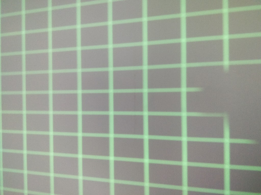

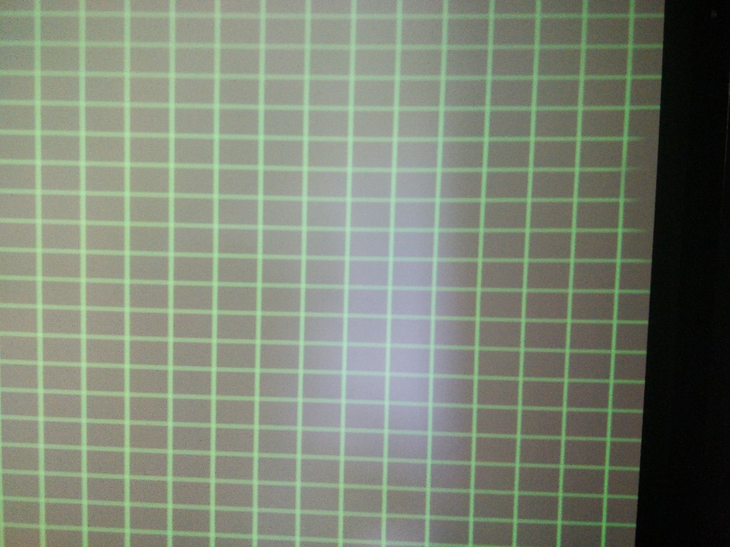

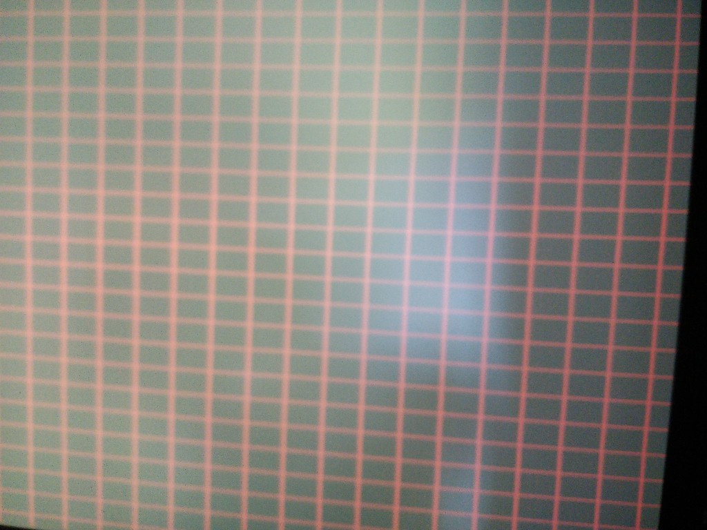

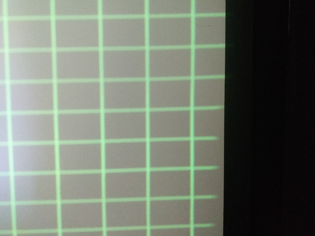

Here's some pics with focus plugged in and 50 settings:
Blue side
 Filesize:  163.24 KB
 Viewed:  6806 Time(s)
Blue center
 Filesize:  78.65 KB
Green side
 Filesize:  133.29 KB
Green center
 Filesize:  130.1 KB
Green center and side
 Filesize:  150.25 KB
