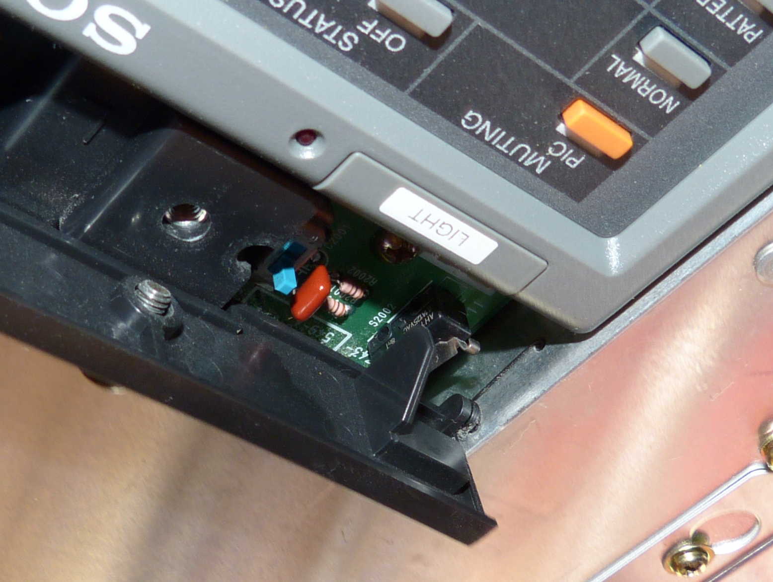

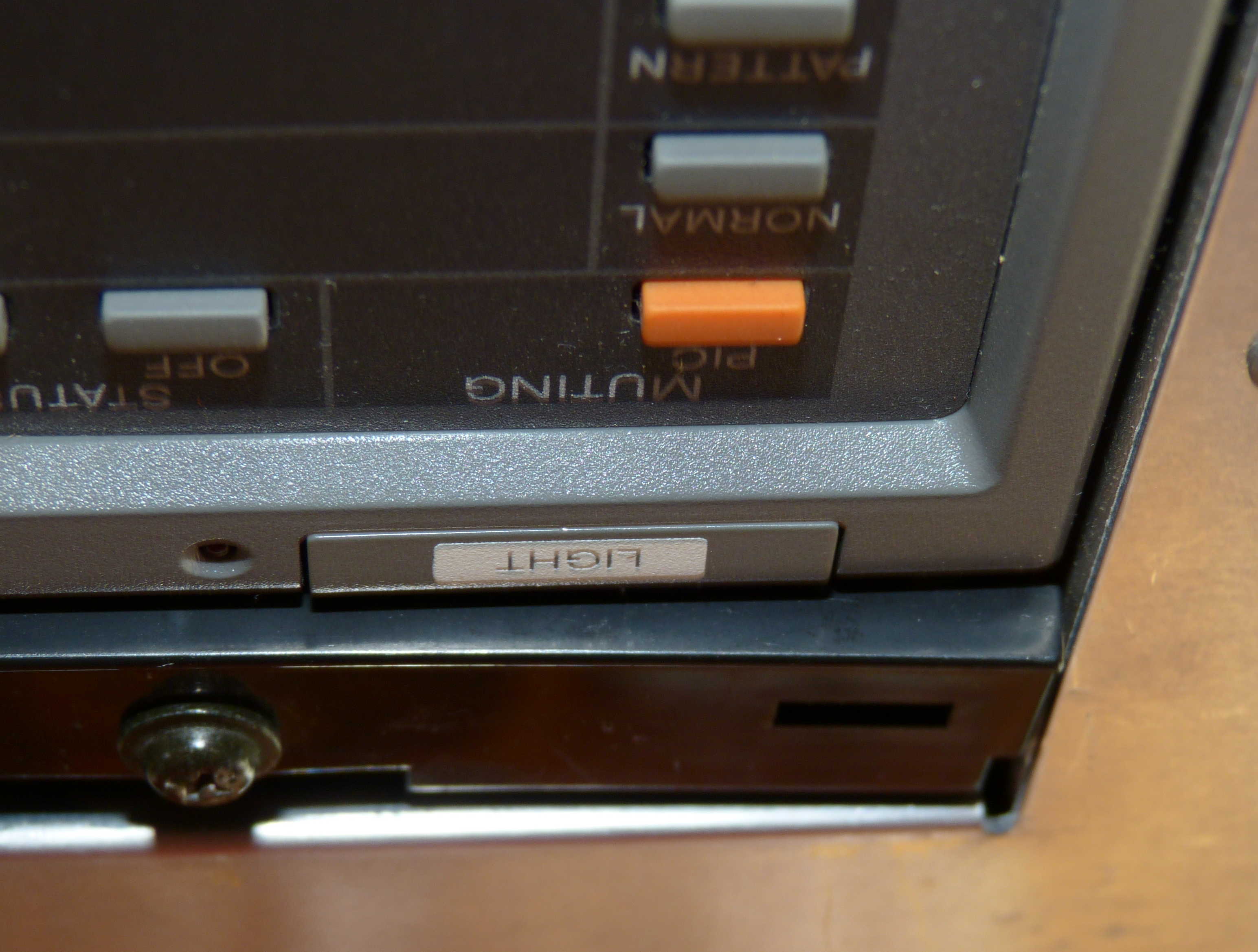

the error 65 came up again, so I took of the gray cover and had a look. Under the polarity-switcher-flap is indeed a microswitch, holding it down and releasing it during running gave the error 65... OK so far.
The flap is bent outwards some millimeters to the side where the microswitch is. See the pic. Thats certainly why the microswitch failed to remain closed. I wonder why its bent so much, since there is nothing below that may put pressure on the flap. Except for the spring to the very right that holds the flap open when manipulating the polarity switches.
I'm trying to bend it back, but I doubt that will hold for a long time.
cheers

Posted: Sat May 23, 2020 7:11 am    Post subject:
Warm plastic gets soft and tends to bend. Perhaps has had a small tension on it for years as well (the spring of the switch).
Or the part where the screw is attached has always been pushed lower than the corner with the hinge -> tension.
I'd take a thin piece of plastic (some packaging waste?) or wood (wooden stirrer, slice of firewood?) and glue it to the plastic rectangular 'block' so that it pushes down the switch again after the lid is closed.

Posted: Sat May 23, 2020 9:22 am    Post subject:
Hello Boet,
thats what I will do when the back-bending will not remain. For now its rather straight.
You mention heat: that makes me think that I noticed a faint but unusual hot-plastic-like smell, when I had a closer look at the trap (my nose bein very close to it), although the projector was in standby and merely ran for some seconds before.
I immediatly took my IR-cam and checked the underside as well as inside (projector still in standby) but could not find anything.
