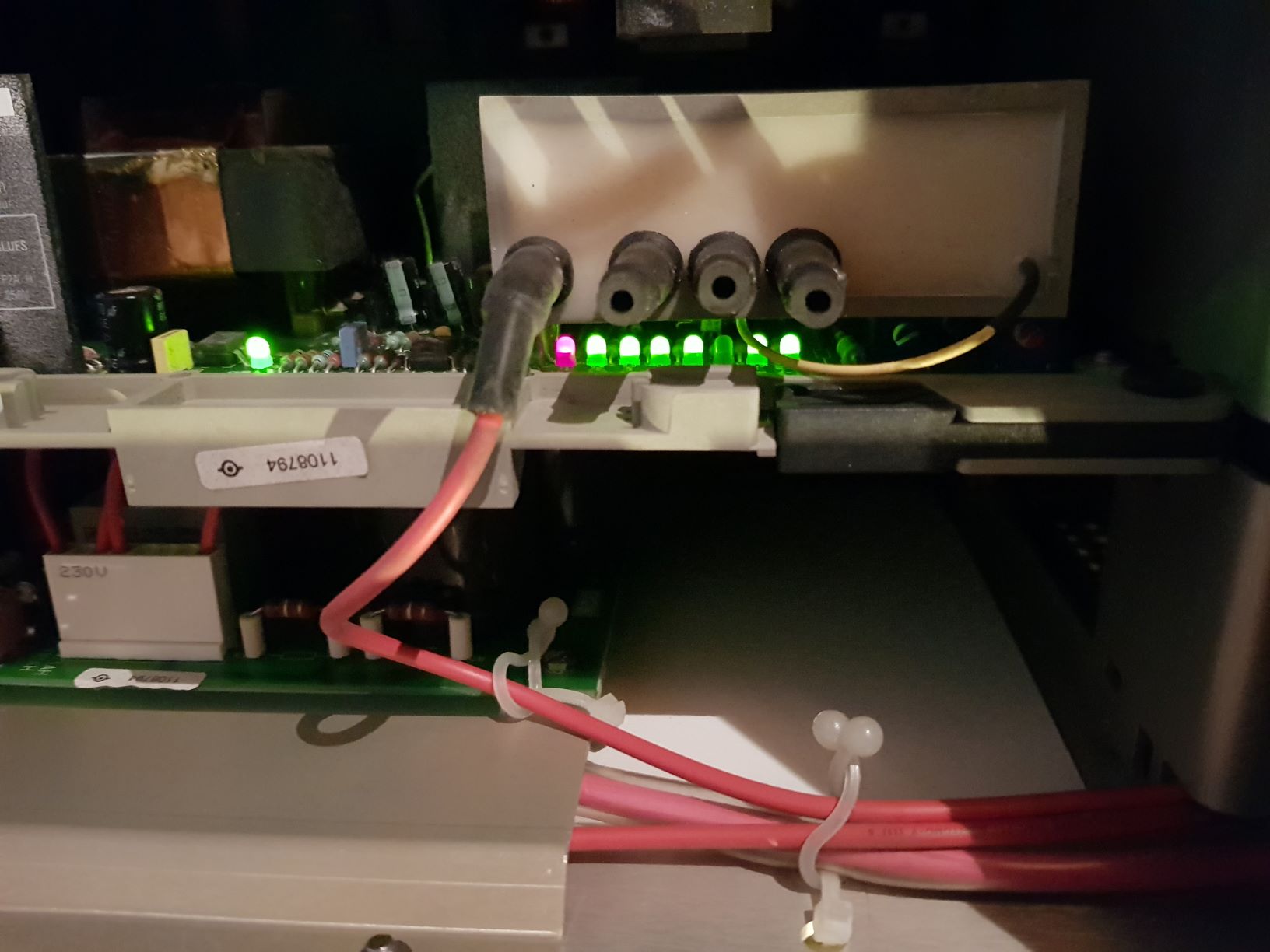

Apologies if I didn't give enough information.Colour status of all diagnostic LEDs (left to right) on the G2 diagnostic board from the Tube side is led 1-on, 2-on , 3-off, 4-on, 5-on, 6-on, 7-on, 8-on (red scan failure) 9-off and 10-on (this one is away from the others).

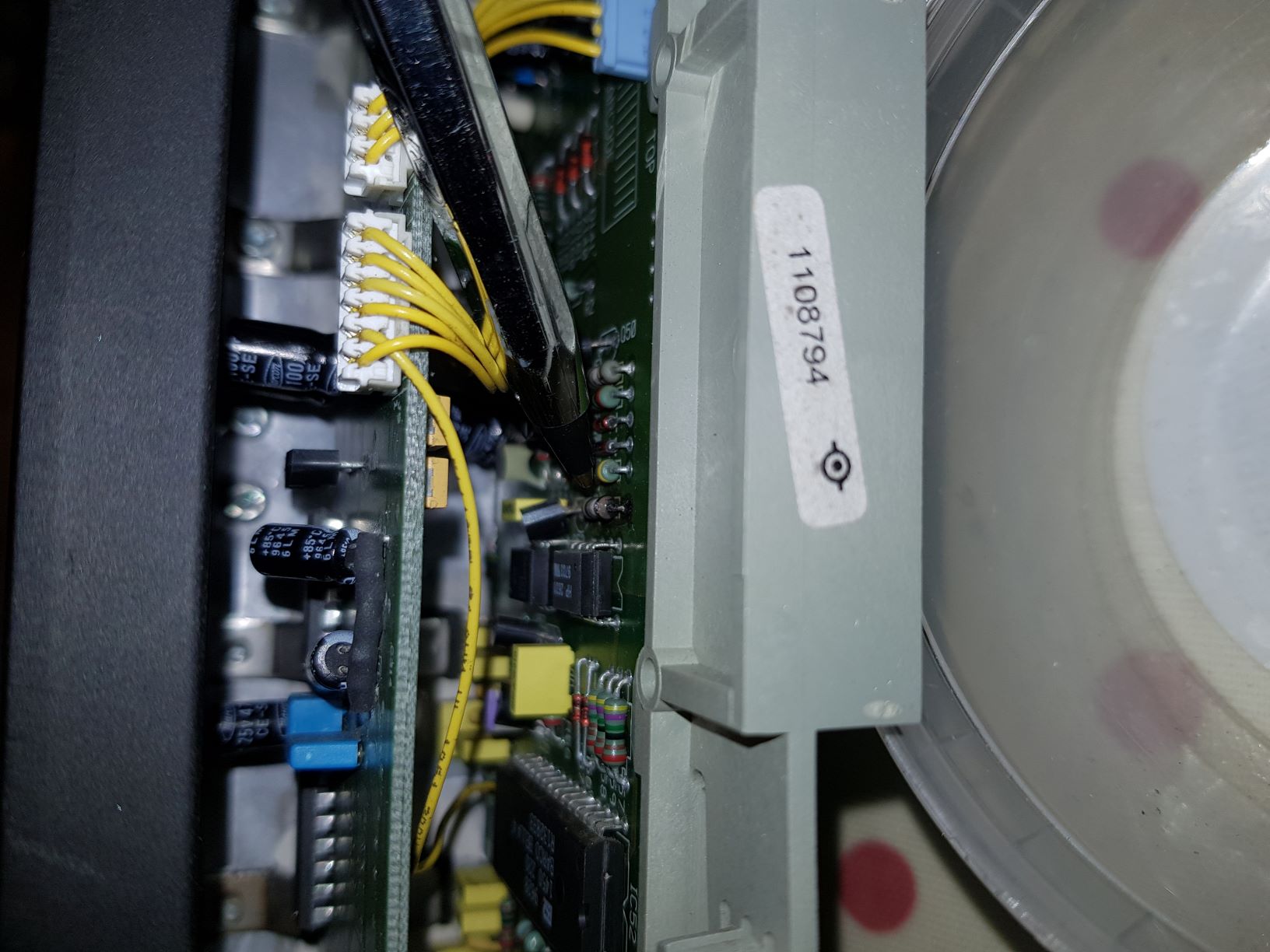

The Horizontal outboard has red led on constant.
The vertical board has a red led on sometimes if you select input e.g s-video it will flash, if you select adjustment mode it will go out.
I did some more checking last night and found that the spring on the vertical switch for changing the ceiling to table projection has come off the switch. I managed to put it back on and it appears to be mechanically working O.K. but I would like to check it but I don't know which pins should have continuity when the switch is in or out. I am wondering could this switch have cause the horizontal shift board to fail?

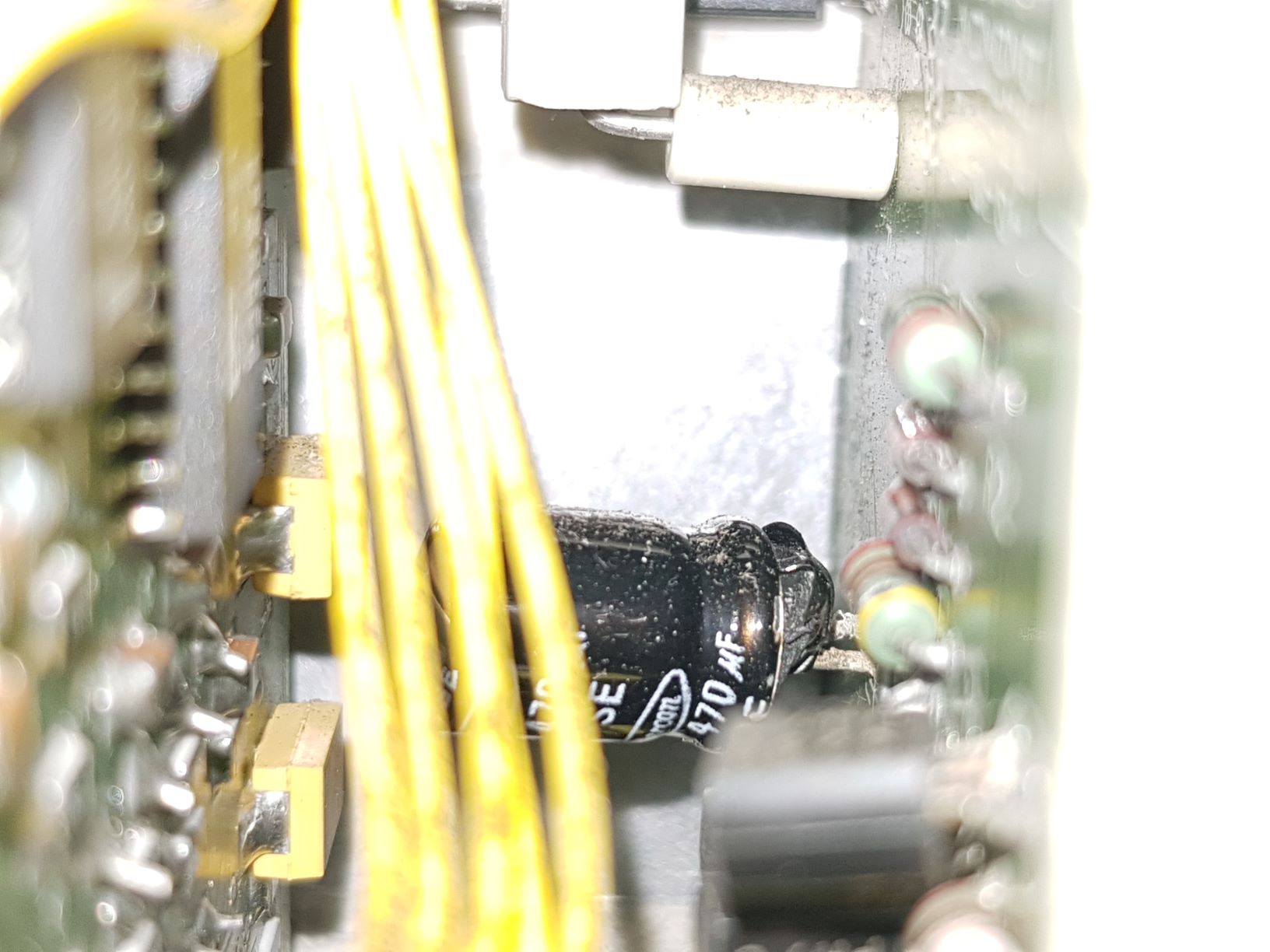

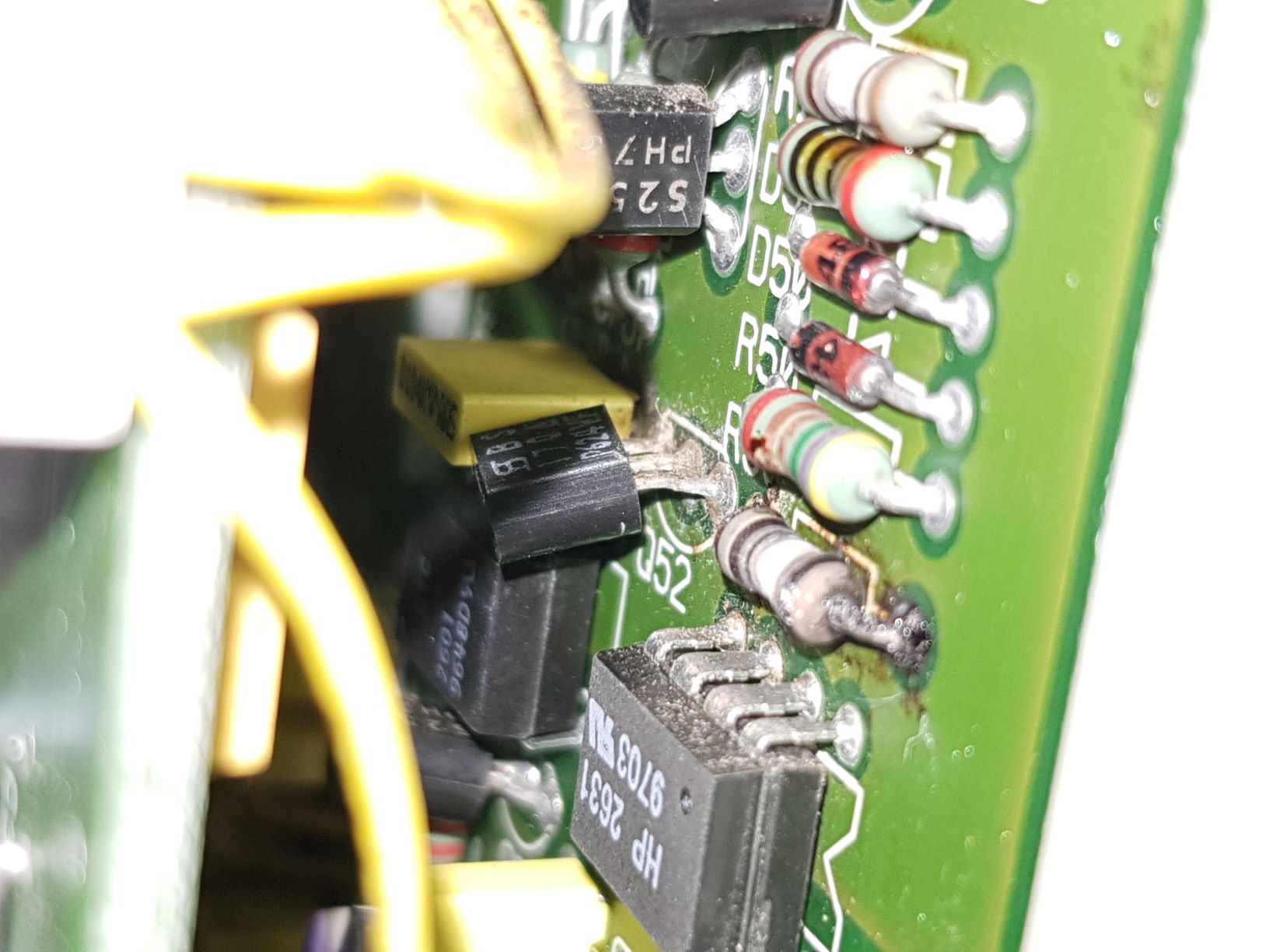

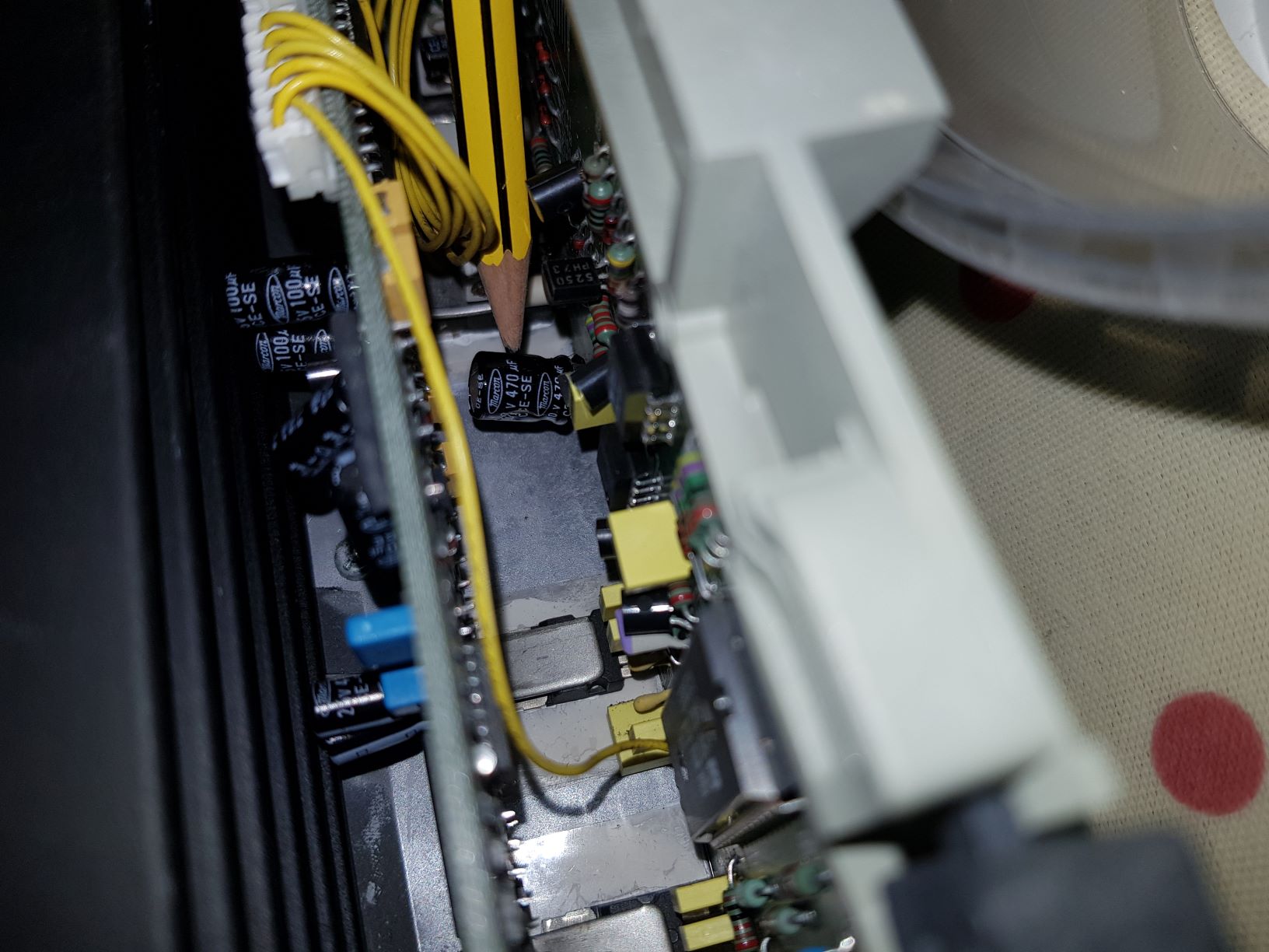

The failed Capacitor is located behind the failed resistors on the lower (main board) of the horizontal shift board R7625035
I have a multimeter and an Oscilloscope, I don't have a service manual.
best regards Tom

Posted: Sun May 17, 2020 6:07 am    Post subject:
Certainly looks like a few bad parts on your H-Shift and Focus board. I have attached the Scan Fail Circuit so you can see the boards that would affect that.

Now, I haven't yet looked into the status LEDs, but let's think aloud with the R7625035 circuit in front of us.
Current path around R53 (330 Ohms):
+5 V -> mosfet Q51 -> LED of opto isolator IC50 -> R53 -> mosfet Q52 -> ground.
Q51 and Q52 make some totem-pole construction, driving an opto isolator from an incoming SDA line.
The SDA line is always high when no data is transmitted, so that the P mosfet doesn't conduct and there's no current through the resistor (after the opto, the line is high again).
In order for the resistor to blow, the P mosfet must've conducted. Assuming the incoming SDA line being 5 V, this was only possible if the +5 V rail went higher than 5 V (so the the gate becomes voltage lower than the source voltage).
Else I don't really see why a 330 Ohms resistor would fry there. Even if the opto LED would be shorted, the resistor would see only about 75 mW of dissipation with 5 V across it.
Could be the 7805 started acting weirdly because of the failed capacitor and sent a higher voltage or crap (oscillations?) down the +5 V line.
With 12 V across the 330 Ohms resistor, it could slowly burn (440 mW). But this resistor burned spectacularly.
Or the resistor developed a (near-)short failure and fried itself.
Strange. Let's look further.
Now, the secondary of that opto seems to drive an SDA I²C data line again.
I would think that a failed SDA line (because of R53) simply results in a loss of communication down the chain (even gibberish aren't valid commands), instead of bad things happening. We can forget about that part of the circuit.
The +5 V does however feed some more circuits on the board, and it has diodes going to the horizontal focus coils.
Could you check if D180, D160 or D140 has failed short? That could've injected signal from the horizontal focus coil into the +5 V line, or vice versa.
That could be a cause of R53 frying and the electrolyric capacitor leaking as well.
(And might've taken IC5 (7805) along with it. If that one's shorted, likely it took the fuses in the power supply in the +FOCUS and +CONV lines.)

G2 board LEDs:
third one off = no HD voltage (horizontal deflection).
8th one red = Scan Fail.
9th one off = no +CONV voltage.
No HD voltage = no HTHD voltage. Automatically disabled as a result of Scan Fail (protection).
No +CONV could be a burnt fuse, which resulted from the focus board failure. But it also receives feedback from HTHD.
Perhaps the focus board took something in the power supply along with it, we'll see.

I removed the top board to give better access and now i can see that resistor R51 is Fried as well as R53.
I did some measurements on D180, D160 or D140 and they are faulty, D180 is reading .460 forward bias and 1.130 reverse bias. the other 2 are reading .480 forward bias and 1.540 reverse bias.
Hi Tom, thanks. Confirms my suspicion the +5 V line went higher than it should've.

I cant' find D461, there is a D20 led lit on the vertical board, it will flash if you select adjustment mode and will stay on constantly if you select source e.g s video
and also D10 is lit on the horizontal output board. I soldered some test wires on the horizontal output board so I could test the board for power while it is in the projector 17v is present on board, also 12v is present on IC4 and 5v is present on IC5.
I will measure the voltage on the +5 V line on the focus/shift board, with the projector turned on.
Also I may have jumped the gun on finding bad diodes on the Horizontal output board, you were right about my multi-meter, it was giving me strange readings so I am using a different one and the diodes look o.k now so that is good.
I wonder if I have created another problem by using the (R762503) board instead of the original focus/shift board (R7625035) I was told by the seller that this board was working fine. does anyone know if there are interchangeable.
I read in another post that the projector should start with the focus shift board removed from the projector, but the image will be all over the place.
I will keep checking, when i get a chance.
thanks Very Happy
Which R... board do you have? I was using the R7628085-3 / R781121-3 schematic, and I don't see D20.
That one's "Deflection hold down".
It will light up under these two fault conditions:
D10 is on the middle-right of the schematic (R76226715_0_Diagrams).
If either pin 7 of IC6, or pin 7 of IC3 is pulled to ground, D10 will light up. Also DEFL_OFF gets pulled low, shutting down deflection (circuit is on the next sheet).
This is the case if HDL_REF gets higher than LIN_REF (IC6), (likewise if LIN_REF gets lower than HDL_REF).
Or when pin 6 gets higher than pin 5 (IC3), that's when the 1900 V set by P2 gets too high (overvoltage protection).
The second situation cannot happen if the first situation is active (no deflection = no possibility for overvoltage across the scan coils).
To be sure, measure pin 5 and 6 of both IC3 and IC6, referenced to board ground.
Now, judging quickly, looks like this fault conditions can occur if H_DRV signal is missing (comes in from the Sync & vert. def. board).
If LIN_REF is lower than HDL_REF, measure with an oscilloscope if there's signal on H_DRV (page 3 of R76226715_0_Diagrams, left-bottom side).
You can solder a wire to the input capacitor again for that, the signal will be under 100 kHz.
If there's no signal at H_DRV, the problem is likely on another board (on/via Sync & vert. def.). If there's a signal on H_DRV, a fault on the hor. def. board is likely.
And as a result of above fault(s) -> no deflection -> scan fail is also triggered.
Sounds plausible, we can shift our focus then. ( Wink )
Good.
What could've happened on the shift board: 5V is connected to the focus coils as a sort of 'voltage clamp' it seems.
The way I see it, every cycle a peak current will be pulled from the 5V line (ripple current). This will wear out the electrolytic capacitor more quickly than usual.
With the el. cap. failed, the 7805 might've got unstable, frying the resistors.
But since you have a replacement board, repairing the focus board's not yet a priority.
