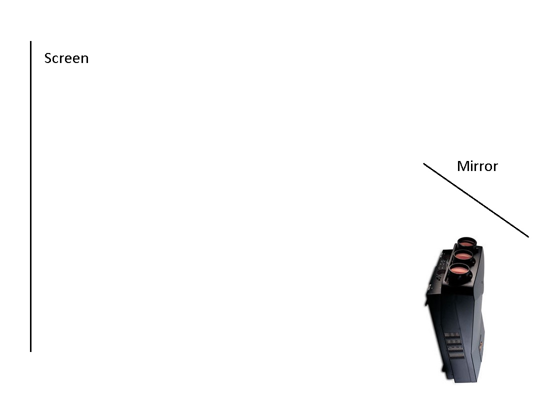

Hi all,
did someone ever tried to use a CRT in combination with a deflection mirror ?
cheers
ElTopo

Posted: Wed May 06, 2020 2:01 pm    Post subject:
Yes, see e.g. http://www.curtpalme.com/forum/viewtopic.php?p=488277#488277
Works best if you can get a first-surface mirror, otherwise you get slight ghosting from the front-surface reflections.
Posted: Wed May 06, 2020 2:04 pm    Post subject:
Sure, Draper screens and other companies offer these systems, and I've seen and serviced a few installations back in the day. As Gary says, you need a super high quality optical grade mirror, which aren't cheap.

Posted: Mon Mar 08, 2021 10:47 am    Post subject:
Yes, it works very well.
I've been using for years with first mirror surface (visible surface:31,5" x 15").

Posted: Mon Mar 08, 2021 1:25 pm    Post subject:
It's a 5 mm glass thickness mirror. The front surface is the reflective (aluminium?) surface and behind, it's the glass.
A conventionnal mirror (second surface mirror) is the opposite: The glass is on top and the aluminum behind.
The reflection is like this:
As you can see, on a second surface mirror, there is a ghosting reflection.
And on first surface mirror, as it has no protection, we have to handle it carefully.

Posted: Mon Mar 08, 2021 5:36 pm    Post subject:
Guys
First surface is preferred; clean sparingly and maybe dust with canned air, it is easy to scratch.

Posted: Mon Mar 08, 2021 7:46 pm    Post subject:
I used such setup in the past with a 808
I ordered the mirror on FirstSurfaceMirrors.com and it was about ~200$ without shipping&handling

Posted: Wed Mar 10, 2021 1:19 pm    Post subject:
Mirror bounce is very possible, but not good for best image from HD sources, and expect some light loss and elevated black levels

Posted: Wed Mar 10, 2021 5:15 pm    Post subject:
yes, very much similar or same thing.
In a proper mirror bounce setup, the room (environment) has to be painted a very special FLAT black. The room also must not have any shiny, reflective or small light source (LED's, CRT filaments, etc. It has to be PERFECT black to even achieve the very slightest ANSI or Low end performance.
I maintained a Immersive (Stereoscopic) CUBE setup that was three 10 foot screens and the floor. All three screen projectors were direct to screen. The floor was an over head mirror bounce to the floor from an over head projector. The four projectors were Christie Digital Mirage DLP.
The customer (Navy) complained that they could not see the flight deck on a carrier to land a plane. It was a mission impossible, because the setup was in a very large multiple use open room that made it near impossible to create or maintain complete black for the setup.
The better setups used very thick glass first surface mirrors that were about an inch thick and was VERY expensive because they were custom ordered and manufactured at a lens factory.
So a proper for HD mirror system would require a Perfect Black projector environment and solid first surface glass mirror (very expensive), and still you can kiss any usable contrast ratio good bye.
The higher end better systems did not use mirrors. They were direct to screen rear projector setups that also required Perfect Black projector environments. The use of an overhead projector/mirror for Immersion (three screens and the floor display) where the three screens were direct projector shoot, were high level setups, because the floor was not a primary viewing surface, the floor display was only needed to help create the floating image (immersive) system.
That plastic stuff is terrible. It will collect dust on its surface that CANNOT be removed, meaning you'll always have a diminishing display system.
