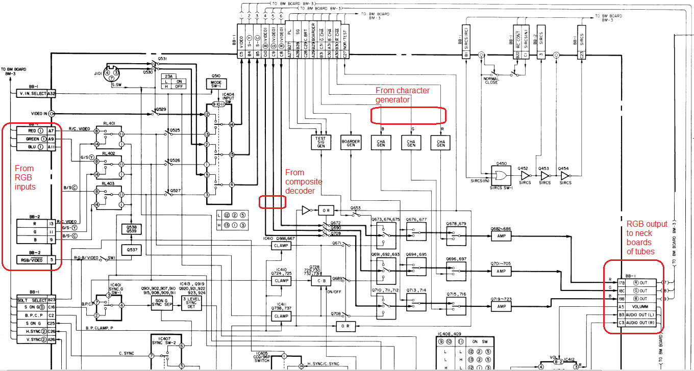

So, just to be clear: you have two input boards (IFB-12? and IFB-40). I've had a quick look into the schematics of those (and the VPH-1270).
You've tried the IFB-40, wired for RGB. I assume you've soldered the IFB-40 like on page 10 of the manual:
https://pro.sony/s3/cms-static-content/operation-manual/3858498031.pdf
No red.
IFB-12 -> no red over RGBHV.
And using composite, you DO get an image. But again only blue and green, no red?
This last check makes me very much doubt it's the input cards, since the composite video is connected to the R input and passes into the projector unaltered. Decoding the composite signal into RGBHV is handled deeper down into the projector, as well as the menu overlays.
Since the on-screen menu still works, the fault will likely be between the input board (but <after> the composite decoder) and the multiplexer (where the projector its internal signal and the external signals are mixed together).
This makes the BB board my first suspect in case of the VPH-1270.
See attached picture. Perhaps something faulty around Q673 - Q679. If that's the case, it shouldn't be too difficult. However, this is only an educated guess.
I don't have the schematics of the complete VPH-D50(QM) to dig deeper now, I also don't know the differences on circuit level compared to the VPH-1270. I've found the VPH-D50(QM) service manual for sale on a couple of websites though.
