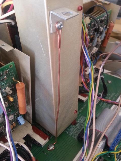

You may have a failed HDM, I have some new ones here NIB. I also have a small mod for securing the HDM sleeve into the mother board:
https://www.curtpalme.com/forum_archived/viewtopic.php@t=42250.html
Bend a loop in the wire for the bottom screw and tighten into place. Run the wire to the
top screw and form a loop around it, tighten the screw and cut excess wire. This keeps
the sleeve from moving.
