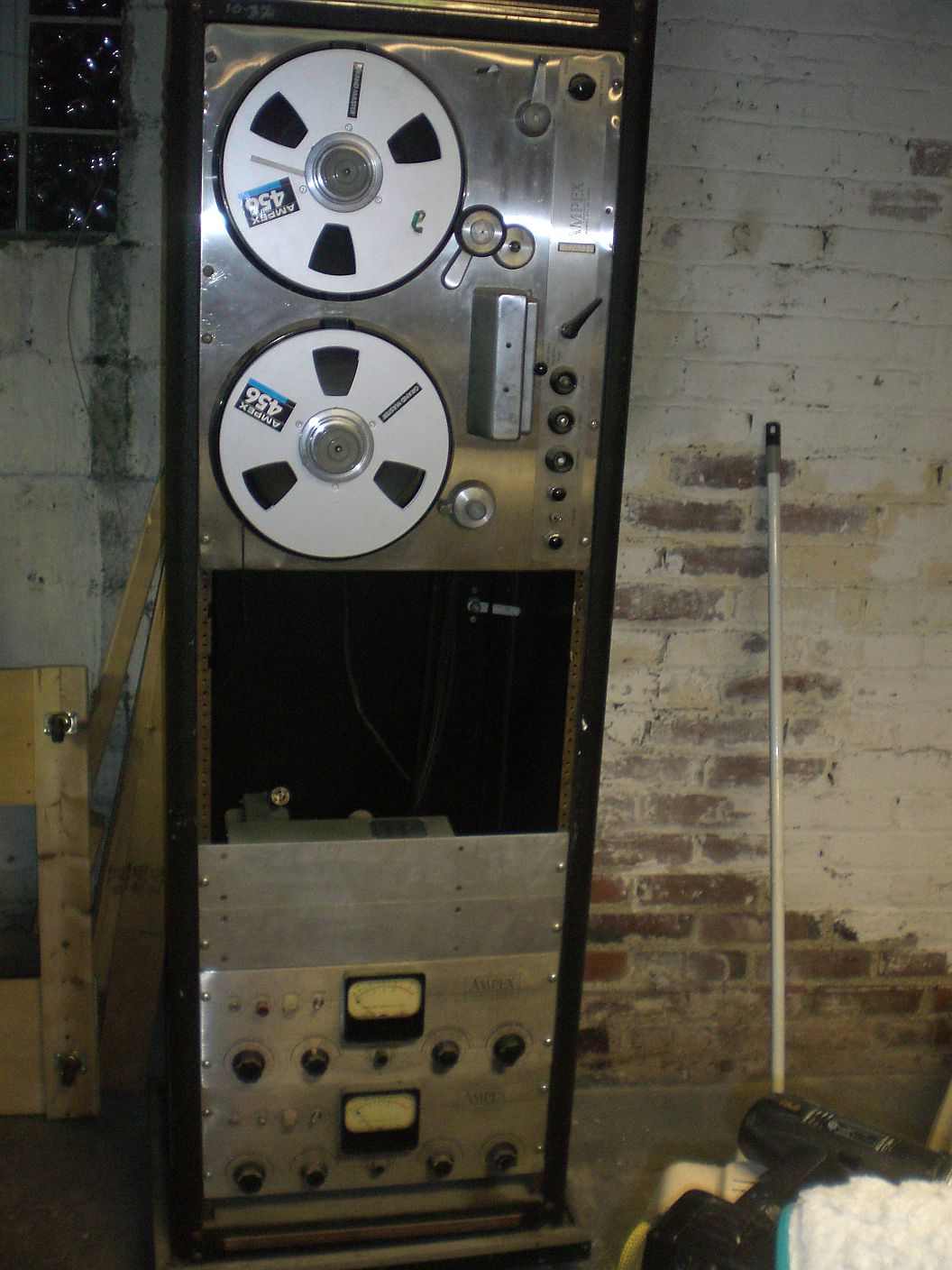

Thanks for the reel to reel link I'll check it out. My current inventory is a Tascam 48 with the Dolby units, Teac 3340s, Technics 1700 and an old Ampex 300.
