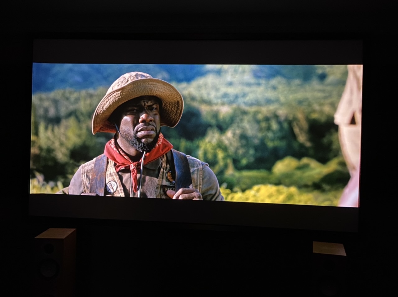

Posted: Fri Jan 10, 2020 4:13 pm    Post subject:
At last! It’s working! Thanks for all your help.

Posted: Mon Feb 10, 2020 9:06 am    Post subject: .
very nice detailed picture you got.
what resolution do you feed the barco?

Posted: Mon Feb 10, 2020 10:15 am    Post subject:
Standard 1080p@59.94. Either the card I have or the projector itself doesn’t like 1080p24, which means the panning shots can be a little jerky in some scenes.
The problem I have though is that it will only play Blu Rays properly. My original Denon player scaled DVD to Blu Ray but the projector displayed them stretched vertically but squashed horizontally. Assumed that this was an issue with the player, so I purchased a brand new Pioneer LX800 (the best there is), and the same thing is happening. Next I tried a Decimator Scaler and I can’t even get a picture out of it, even with Blu Ray.
Interestingly the projector will display modern very recent DVDs, for example it plays Fargo Season 2 correctly.
Now I’m suspecting that it may be the HDMI card in the projector. This is an Eisemann card. I also have that most recent version of the Moome card sitting unused in a box. So questions:
What’s the Moome Card rated at in terms of 1080p? Will it display 1080p24 correctly, or is the just beyond the bandwidth of a Barco 909? Any ideas what could be up with the Eisemann card?
