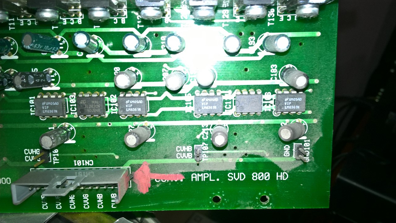

The problem is back again! Luckily I have found a working Svd 800, with screen burn, 6000 hrs plus on the clock but its working, I will try and change the convergence board and see what happens.

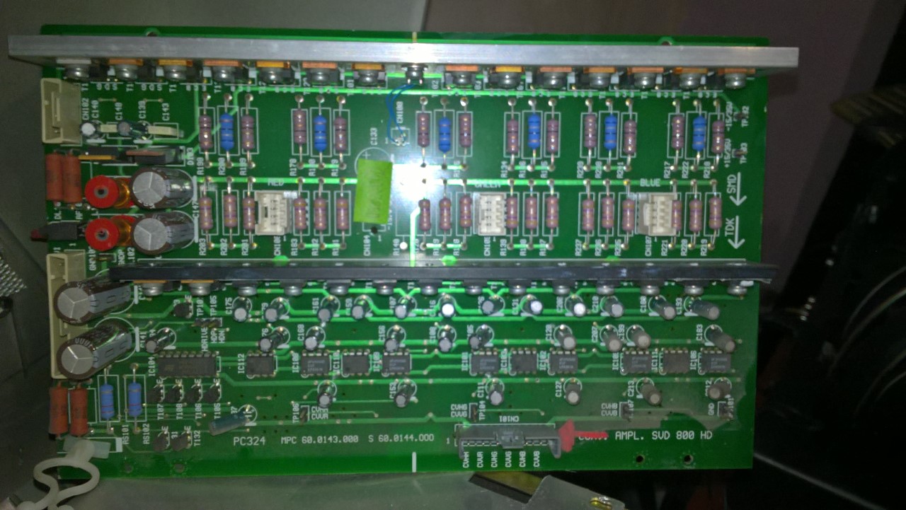

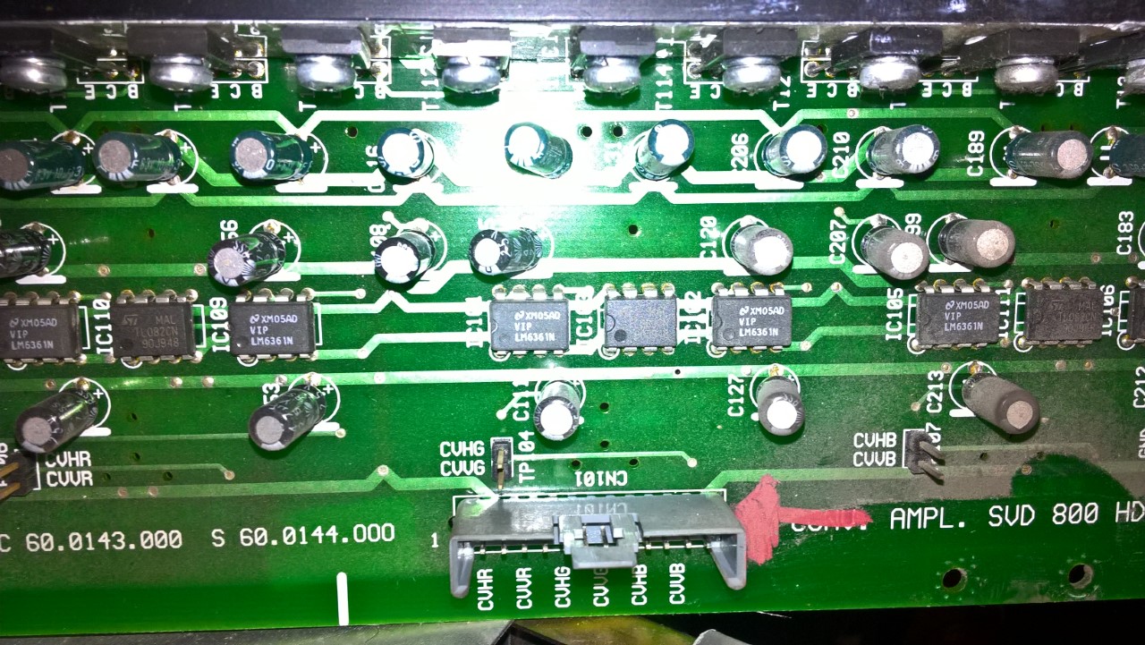

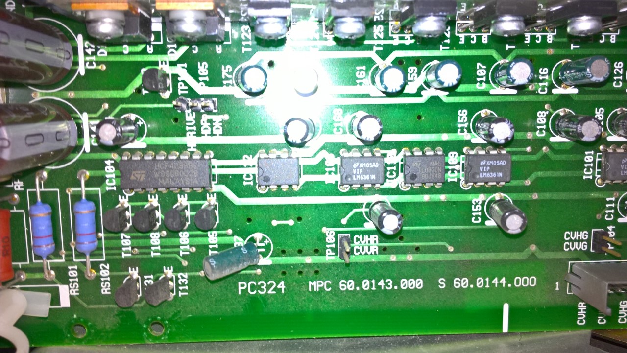

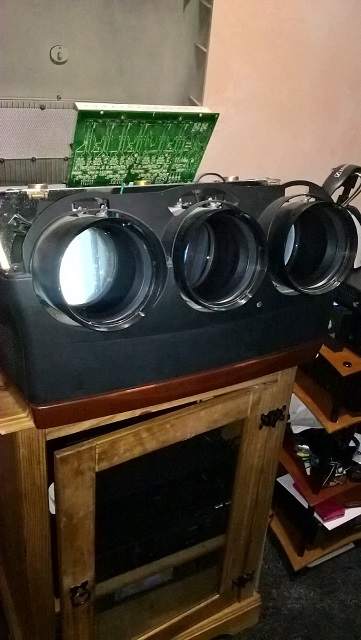

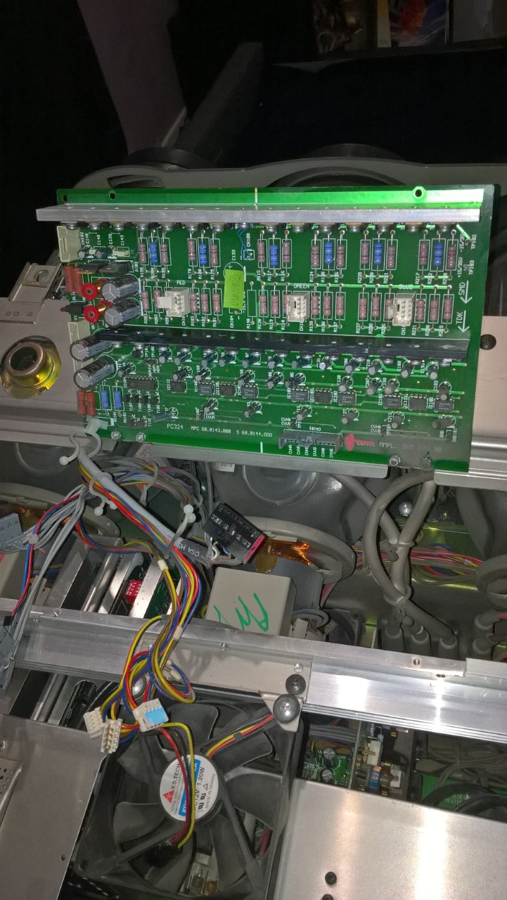

Posted: Fri May 29, 2020 12:57 am    Post subject:
Thanks Curt, I am finally having a good go on this! The board is off and hopefully its going to get fixed once and for all. Very fortunate to even find a working 800 not too far away in this day and age! Surprised I broke nearly all the connector clips removing the plugs as they're so fragile, any way wish me luck and I will post what happens!

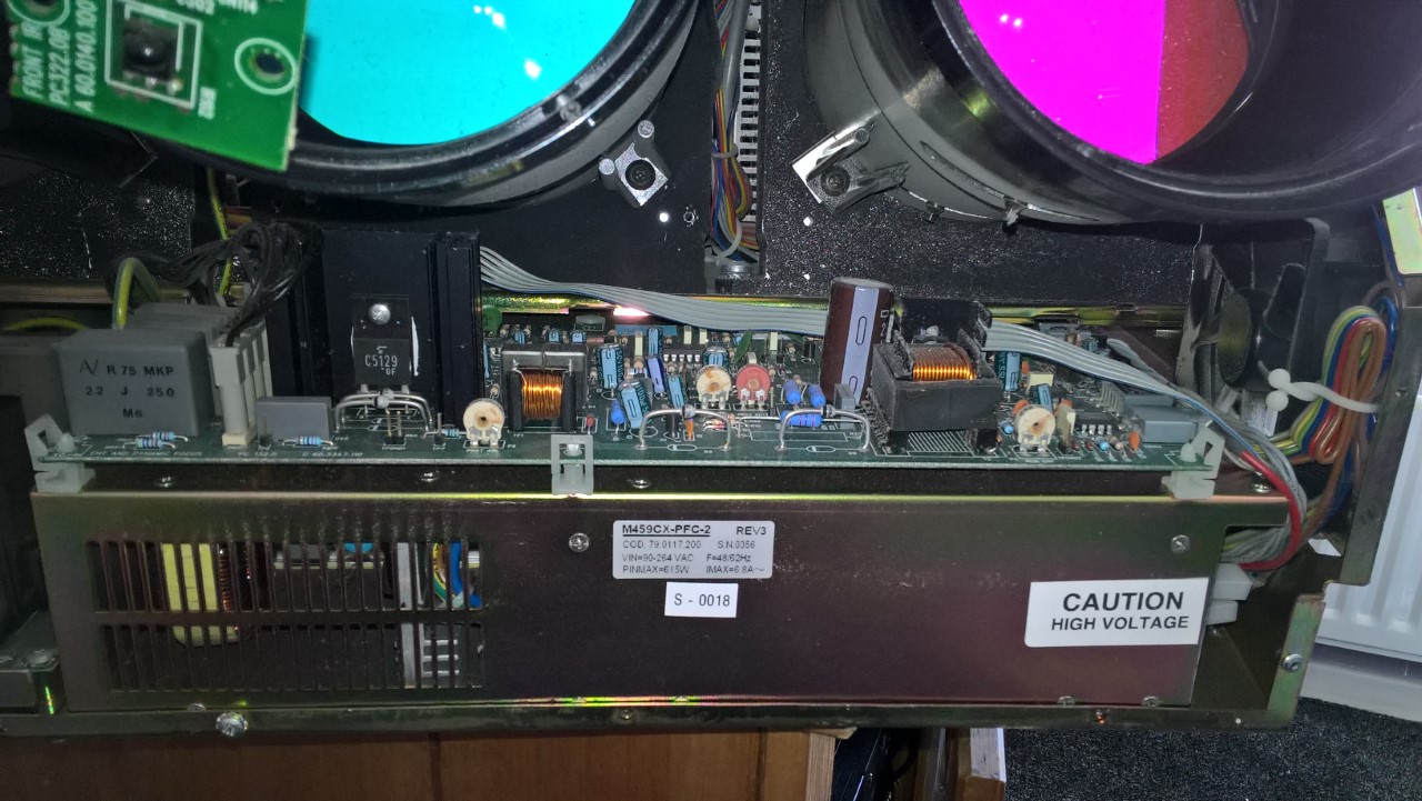

Posted: Fri May 29, 2020 11:26 am    Post subject: Convergence overload error on a sim2 millenium svd800 UPDATE

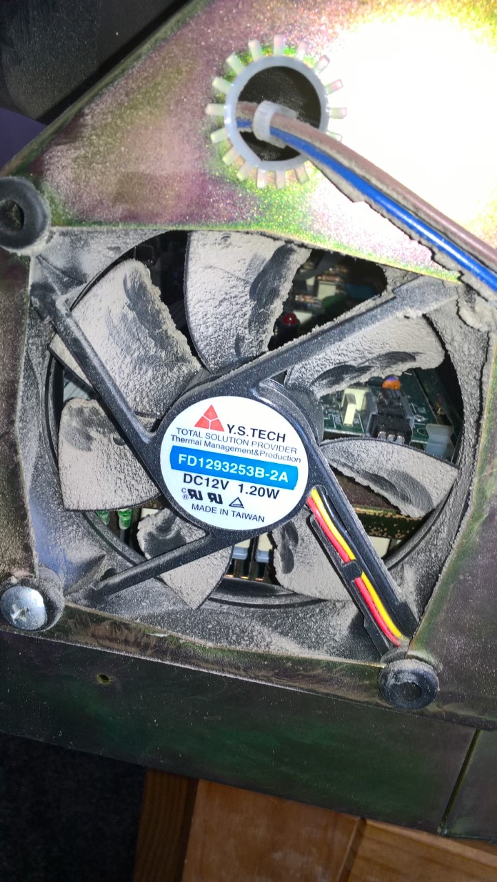

Is the power supply just the enclosed box or the board on top too?, the manual says the board on top is its EHT and Dyn Focus, any comments very much appreciated. Looks a bit difficult for me, as the supply is underneath, I may have to just swap the board and hope that does the job. Fans are very noisy on these according to reviews, and experience, but I will clean them first and then try change if still noisy. Very Happy
