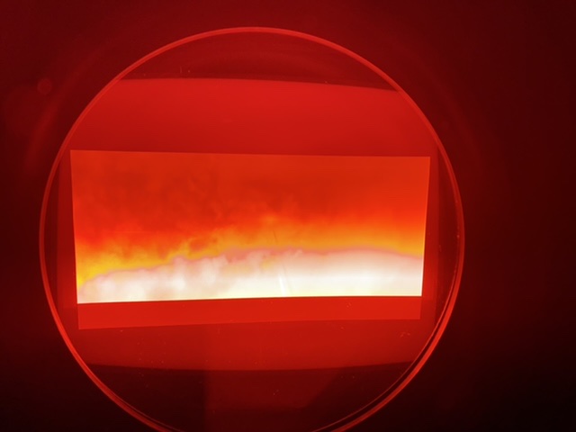

Here’s a photo of my image in the red tube. The green and blue are in the same position. Does this look OK, or is the gap around the image too narrow? The projector is a Barco 909, which is ceiling mounted. The image perfectly fills my 16:9 screen, so in order to make the image smaller in the raster it would be necessary to shift the projector back a little.

I'd say this is well done!

That looks like a wide screen image. Where are the top corners of the raster with a 4:3 image?
