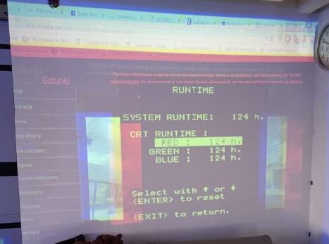

Used JVC RS46, displayed 1800 hours, costs around USD 1420 in Poland. The new RS46 costs 3710 USD. The new, never used CRT Barco 908 Baron retroblock, 124 hours, with the latest sharpest 3D graphics lamps, costs me $ 200. I will not be convinced to spend such a big difference in money, because the differences in the image will be small. The climate of the CRT projector and the dynamics of its image are still a priority for me. The new CRT means long years of lamp wear and the possibility of cheap repair. I like to watch faces and confuse people-friends who, seeing my "old, big, heavy basket" that they see for the first time in their lives, are delighted with the quality of the image and never again call the CRT projector old garbage Smile. However, you need to spend a lot of time to get the best good picture. Many cannot do this or have no patience.The crt projector should not be bought as a heavily used lamp and mask for hours - it certainly doesn't make sense
2019 rok , the new barco 908, it happens :)

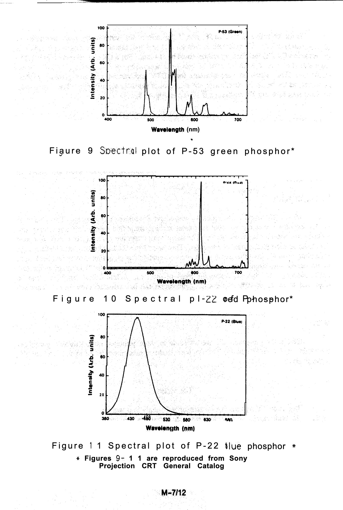

Nice, the FW900 is still being talked about today in 2025. Seems like CRTs are becoming huge...
I recently got into them last year with a JVC D Series and a Toshiba HD, and there is nothing like them. My kids say the CRT lookedd better than the Macbook Pro 2024 XDR screen that was driving the HDMI.
My personal opinion is that part of the appeal of CRT is the full spectrum of colours, reaching the edges of visible light—and getting into UV territory and on the verge of near-infrared.
We just got a Sony G90 and it's mesmerizing. We had guests staying over for a few days, and each morning, they jokingly (but serious) asked what we'd be watching later that night.

But it is why people switch, indirectly. People switched because the list of things that CRTs are better at has gotten smaller and smaller as time goes on, or the gap has lessened. It's directly related.
For example, I mentioned previously above that image quality for me was paramount over size/weight/cost/etc, so I started with CRT. Eventually digital passed CRT in terms of overall image quality so I switched, as did most people. There are exactly zero CRT projector manufacturers left for this reason. Some will argue it's because CRT is expensive to make which is true, but that's not why they're gone. There always niche markets for all high end products from fridges to cars to projectors. There are certainly enough extreme HT enthusiasts out there who will pay anything for the best image quality so a small niche of projector manufacturers to look after these people do exist, but none of the manufacturers are using CRT.
One example of such a projector is the Christie Eclipse which costs $350K and weighs 346 lbs for the projector head plus another 330 lbs for the RGB 3-laser unit which lights up 6 DLP (DLP? Yes) panel. More discussion here: https://www.avsforum.com/threads/christie-eclipse-projector-world%E2%80%99s-best-home-theater-projector.3155910/
Well known HT enthusiasts like Art Sonneborn own one and he certainly lives in the "image quality is king" camp and has deep pockets. He started with a stacked setup of two NEC PG series CRT projectors but now owns one of these.
More down to earth on the consumer front we have JVC and Sony who all produce high end projectors - none of which use CRT but ironically they do use a form of phosphor lit by laser. Want CRT like image quality? This is a good place to start. I run a JVC NZ7 myself which has JVC's third-generation BLU-Escent module with a blue laser diode array and yellow phosphor wheel to generate the red, green, and blue signals for the native 4K, 0.69-inch D-ILA imagers. Not the same as the phosphor we're used to however as the colour gamut is much wider than what we had with CRT.
Funny enough, CRT projectors have a much more limited range of colours than newer technology available today.
When CRT phosphor response was created (invented) many years ago it was done to meet the existing technology available at the time which was SDTV (Rec.601 gamut). Then HDTV (Rec.709 gamut) came along and it's extremely close to Rec.601.
CRT requires some colour filtering to get to Rec.601/Rec.709. Most better units are equipped with color corrected (filtered) red and green CRTs which achieve rec. 709 (HD) color coordinates, or they come very close. See this thread: https://www.curtpalme.com/forum_archived/viewtopic.php@t=5604.html
A well calibrated CRT projector should be able to reach to Rec.601 (SDTV) and Rec.709 (HDTV). In some cases colour filters are required or clear c-elements need to be replaced with tinted c-element (same result). You reduce light output of course when doing this. This is required because most CRT projectors were originally manufactured with clear glycol or clear red and green c-elements in order to increase the overall light output of the projector as the original use for many of these projectors was not for home theater. Those people wanted light output, not colour accuracy.
Now fast forward to today and we have UHD (Rec.2020) gamut and HDR-TV (Rec.2100) which are considerably larger gamuts and beyond the capacity of what CRT phosphors can deliver:
You can't get a CRT projector to do Rec.2020 / 2100 colour gamut. I just won't happen. The phosphors simply cannot resolve those colours no matter what you do. You need to map that Rec.2020 space back to Rec.709. Newer digitals however can do Rec.2020 / 2100.
Rec.709 (what CRT can do) covers 35.9% of the visible spectrum while Rec.2020 (what newer digitals can do) covers 75.8%.
