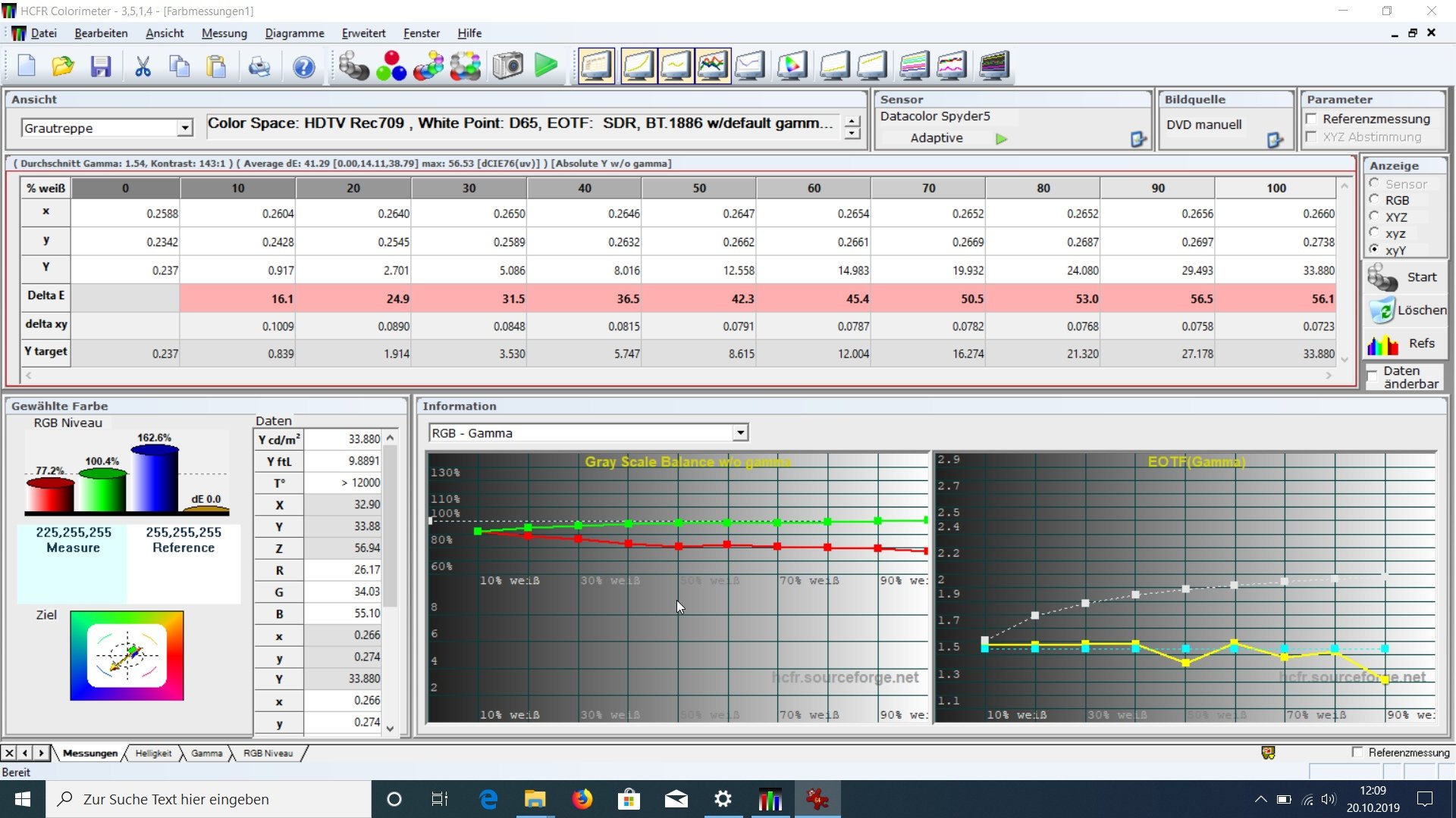

I did the calibration with following setup:
HCFR running at a Windows Laptop with an "Spyder 5" and latest HCFR Software.
Sat-Receiver that can play images with grey scale images 0...100%).
I did the initial reference measure (see picture). Spyder tells me it is far to blue and to less red. Although I think it is not to far away from beeing neutral I know that eye is not a good instrument for color. So I adjusted the 90% as example to be neutral. But - suprise - the image at TV is reddish.
I have no idea what might go wrong. Is my colorimeter damaged? What chances I do have to debug this. White paper is not reflecting. Something else that I can take as reference to check the colorimeter?
In setup is a calibration of Colorimeter mentioned, but don't know how to do and where to get data from.
And, second issue: It seems that gamma is extremly low, can this be true?
Thanks, and especially for the developer and community for this great tool.

Posted: Sun Oct 20, 2019 1:57 pm    Post subject:
It may be the Spyder5. Every Spyder meter before the newest SpyderX is not recommended as many tend to not be very accurate.
Read our meter FAQ here: https://www.curtpalme.com/forum_archived/viewtopic.php@t=11436.html
How old is your Spyder5? How was it stored? If it's old it may also have drifted.

As I understand this, a calibration on Laptop's screen (which affects Laptop only) can not have an effect to the TV (which is not connected with laptop).
The only what might happen is (unlikely), that the PC knows it does some calibration and think it has to take this into account receiving data from Spyder. Software can't does spyder reads data from own (calibrated) laptop monitor or from external TV.
The other thing that comes to my mind is, that Spyder has to be loaded with some driver/init data which might fail. Not sure how installation of Datacolor's software, DisplayCal and HCFR and drivers interfere.
I used the same Spyder with DisplayCal, found the images are on the warm side, but the "white" was far away from being as reddish as if I try to get a neutral point here.
I'll try to organice a second colorimeter and will repeat that. But that can take a while. Thanks for your help!

Used a different Colorimeter from a friend, as Spyder3. Ok, not high end - I know.
But it ends up same.
I am doing the DVD manuell way and give the Spyder an Image created by Irfanview. There I can adjust the 3 color channels.
I achieve to get R G and B to same 100% level - but surprise - the image I created looks reddish. I mean not a "warm white" but a real rose.
So there is something wrong how I use Software - but there aren't so many things to adjust ?!?
So what I did: Say new, select manual DVD and Spyder3 instead of simulation. As I have no configuration file I skip it. Then I start continous measurement and adjust the image below the Spyder as described above.
Posted: Tue Nov 05, 2019 4:36 pm    Post subject:
It could be many different things.
You could be using the software incorrectly.
You could be adjusting the display incorrectly.
Your display could have a broken CMS (colour management system) - this is actually very common.
Your meter/software may not be profiled correctly for the display type you're using.

Think I found the issue:
Take a second laptop and the results seems to be ok (so no reddish for 100% at each channel). Than I connect Spyder to my laptop - same result. So it is not a installation/driver/spyder - issue.
Than I let the spyder look to my Laptop - same result as above.
So it seem that my Laptop screen is so strange that calibration fails (for some reason). Mh - ok it is a very bad screen, TNT. Of course results are very dependent on viewing angle. But ... I can rotate it to each position - it never happens that a sensor calibrated image (reddish) looks grey.
So, it keeps not understanded isse: Somehow spyder is not compatible to my laptop screen (technology).
Posted: Sat Nov 09, 2019 2:32 pm    Post subject:
So the last point I mentioned:
"Your meter/software may not be profiled correctly for the display type you're using."
CHeers!
