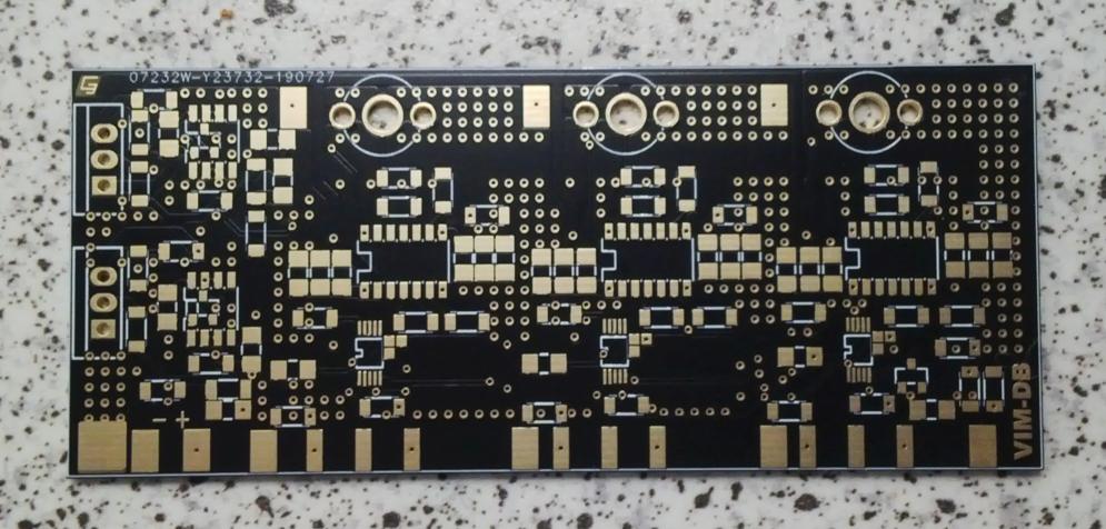

Not that modifying CRT projectors are still a hot topic, but I have to entertain myself with something...
Here is a new development waiting for trial.
This is a modification board specifically for Marquee projectors. This daughter board follows the conventional circuit topology like the original VIM: signal switch followed by a variable gain amplifier. But with all new components, this is not based on the AD834/835 multipliers anymore, instead a variable gain amplifier called VCA824.
Regarding bandwidth the previous VNB-DB boards were already as good as needed, but it is somewhat difficult to deal with as it needs the VIM, VNB, LVPS and HDM modified to various extent. While the later two is a recommended modification to any Marquee anyway, it is still somewhat demanding to carry out such modification.
This new board is aimed to overcome this weakness, it again contains all signal processing on a single PCB (including own, separate, low noise power supply), but this time located on the VIM, with retaining the miniRCA connectors it would be possible to upgrade the signal path in a simple way. The board is so much self contained that only minimal modification would be needed to the VIM: adding only three resistors and tapping certain control signals, and of course the video input.
The VCA824 multiplier has 700MHz bandwidth (even better than the AD834, while cheaper than that!) and offers easily adjustable gain (beyond unity), which was torublesome on both AD834-835. Also very low noise.
The signal switch is called TMUX154E, which also appears to be an excellent switch with good isolation (which is further augmented by double switching scheme), 900MHz bandwidth, while having low on channel resistance and low input capacitance.
Overall I'd expect even better bandwidth performance as possible with the VNB-DB but at a lower labour.
blank PCB waiting for populating the components
 Filesize:  111.25 KB
 Viewed:  12563 Time(s)

Fantastic , sounds very interesting.
It's great we Marquee owners still have things to look forward to.

so how long has this pcb to wait to be populated?
Posted: Wed Aug 07, 2019 10:55 am    Post subject:
As soon as I'll have my electronics stuff in the new house Razz

Big ups for this, absolutely great stuff!

The VNB-DB was designed for cross-platform (Sony, Barco, etc) operation in mind, although my first idea wasn't exactly the 1031 Razz
Regardless, so far I've only made VNB-DB for Electrohome and I believe it will stay like that, although the door is open for the possibilities Wink

The VNB-DB family was meant just like that. I've briefly evaluated the possibility adding Marquee VNB (the best possible neck card) to Sony and Barco. In fact I've almost finished -on theoretical basis at least- the needed modifications for fitting in to a Barco 909, and the Sony G90 way does not look impossible either. But without a test chassis (or a helper with deep understanding) it would be really hard to fully finish such project.
Have you ever built this for any Barco?
I haven't built it (yet), but worked out an easy and cheap way to power the Marquee VNBs in the Barco. I also have enough Marquee VNBs to supply such an experiment. I also figured out the needed modifications to interface the daughterboards to the Barco (using 909 style switcher and driver boards).
As usual, these ideas not necessarily mean it will work right away, so a 909 test chassis would be needed (what I don't have) to finalize such idea, or someone who can also understand what is going on the projector to some extent (and be able to take measurements and solder) so we could work out arising problems remotely at least.

any updates on the project, Gabor?
moved that vintage electronics stuff to the house?
Posted: Fri Aug 16, 2019 7:10 pm    Post subject:
Stuff is only partly moved, the Marquee is still over there...

Gabor, any chance of a pic of the populated board?
