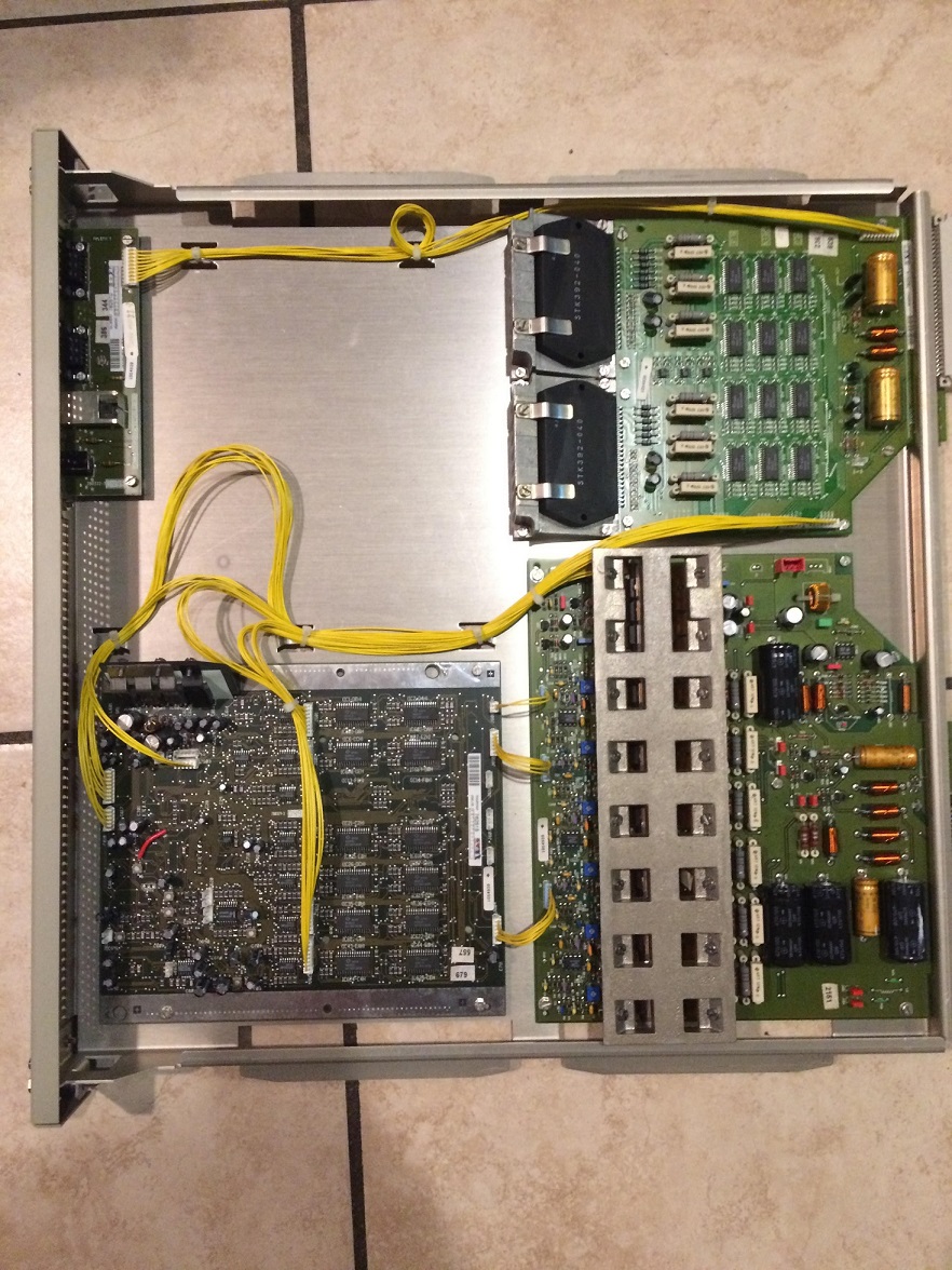

The convergence issue likely is the convergence driver board on the left side of the tray. I probably have some, although some of the board software versions are slightly different, even if the board numbers are the same.
The white stuff on the boards may be original, some boards had it for some reason. As long as it's not affecting the operation of the set, then you're fine.
Also, do all of the geometry controls work? If the green can get bang on, and all functions work on it, then the problem is convergence only. Top and bottom pin actually comes from the focus/H shift board, at least the signal that controls those commands does.

Is that the right convergence driver board for a 1208. It can't make out the part number but it looks like a very early version one that was used in late model 801?

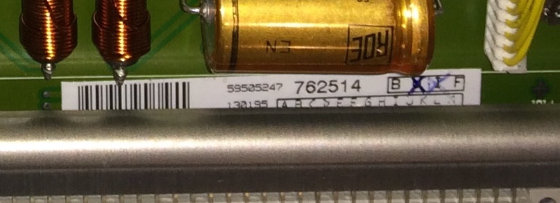

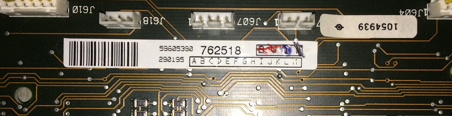

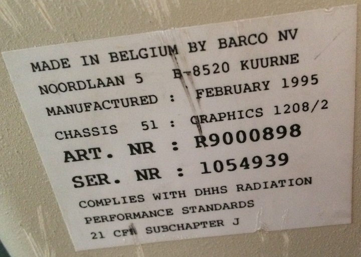

Here are some part numbers. These do seem to come up online a lot for an 808/808s. Not sure how similar they are to 1208.
Projector chassis
 Filesize:  132.17 KB
 Viewed:  3992 Time(s)
Stigmator? I think.
 Filesize:  81.53 KB
Convergence driver
 Filesize:  283.06 KB
Posted: Mon Aug 05, 2019 11:44 pm    Post subject:
Part numbers may be the same, but the firmware in the chips are different. May or may not work. Ideally you'll find one out of a 1208.
