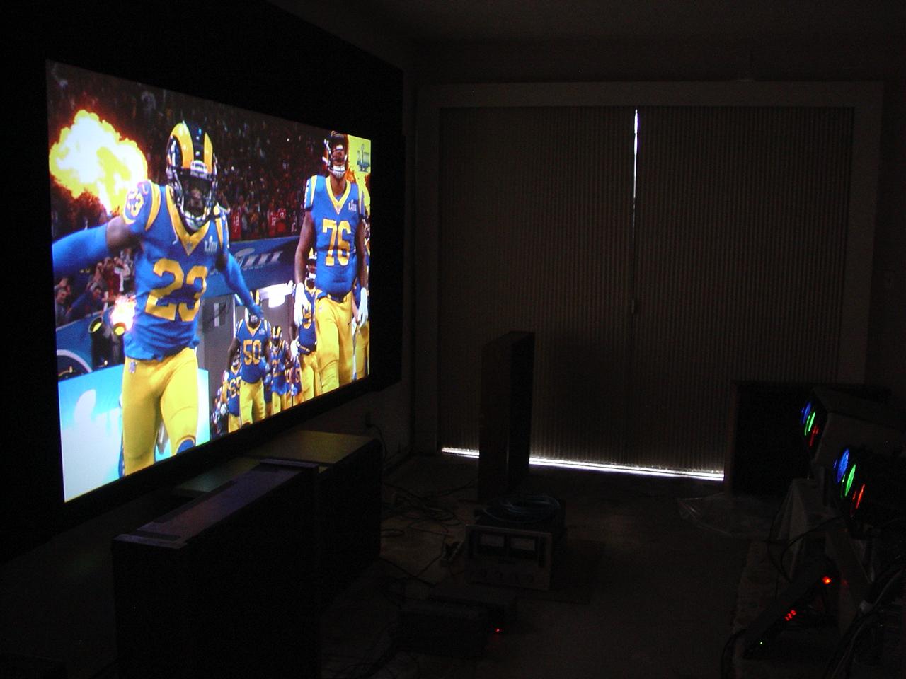

The throw will be around 1.0 your screen width with 16:9 and 20% overlap. The processors can be found used they are no longer expensive.
Setup is not that difficult. A processor like DiVentix has horizontal gray bars test pattern among others for ease of matching drives and G2s.
I have the most experience with blending (13 years) in this crowd, feel free to message me with questions.
My thread is here somewhere........"If You Don't Blend You Suck" LOL
Tim at E-Tech

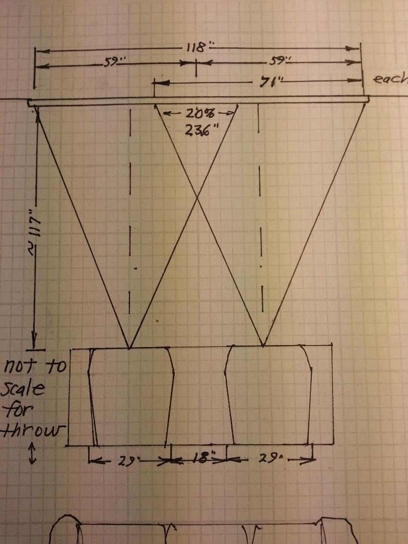

Guys
I sketched this for a recent proposal with two Marquee 9500s:
