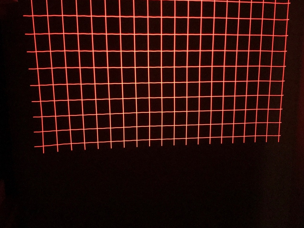

Hi all, i'm Stefano from Italy, i recently buyed a Barcoreality 909, and i have a problem with the horizzontal line in any frequency and resolution, all is in midpoint and i have already replace all board (without the vertical (i don't have it..)) including the convergence/astigmatism/focus board, but the problem persist, i attach a documentation:
If i disconnect the conv coil red/green/blu cable the problem disappears

The problem is the controller board, which are hard to find. I can repair that though, and have done so on a number of 909 controllers. Let me know if you want to send it in for repair.
Email me through the website please.
