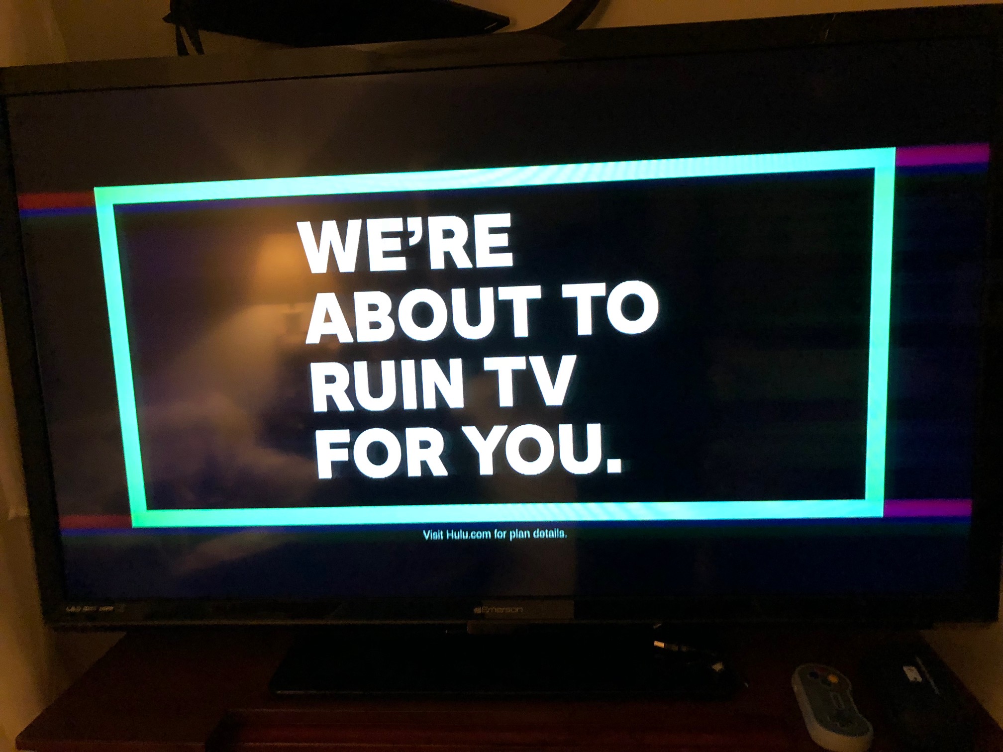

Still going strong no dropouts. Now i am moving on to focus on quality. The muxlab output has some unusual smearing of the image? See attachment, you ever seen anything like that? this happens on any video source and shows up on any connected tv. I tried 4 different muxlab 50058 baluns, so it either hates the cat6 cables I am using, or hates the output of the extron crosspoint scaler. see attached picture.
Going back to the tripp lite b136-101 baluns as they don't have this smearing just exhibit some ghosting, likely caused by the skew in the cat cable i am using.
