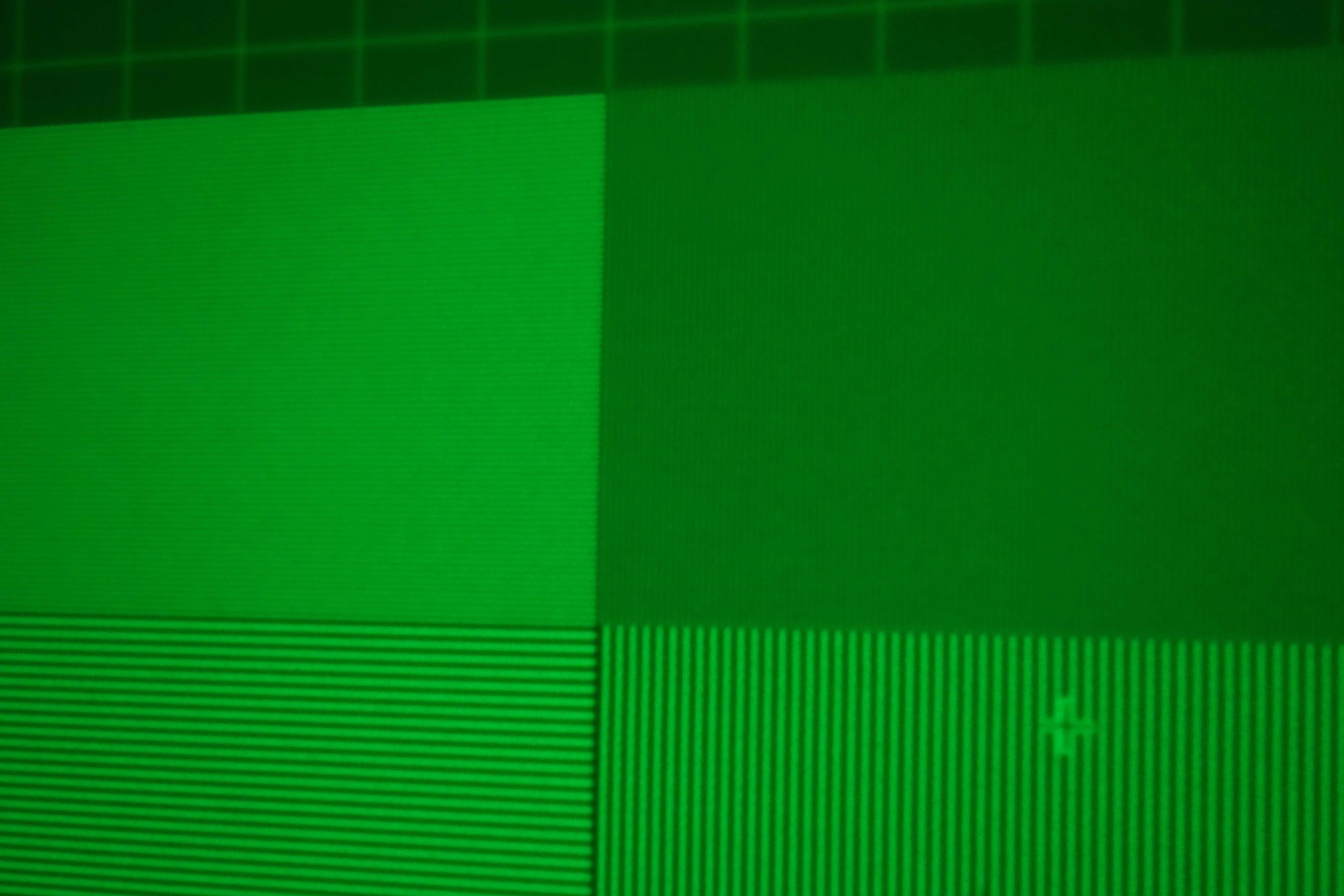

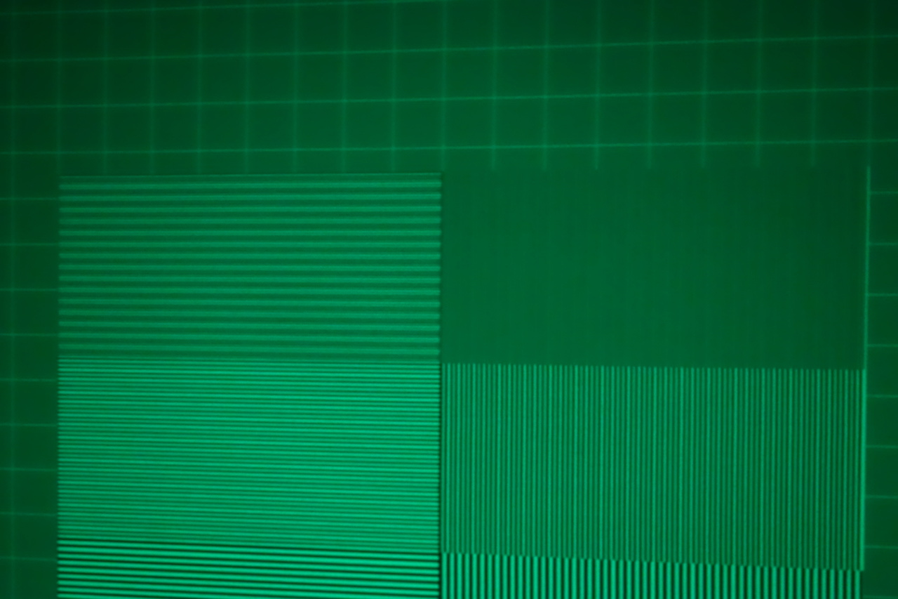

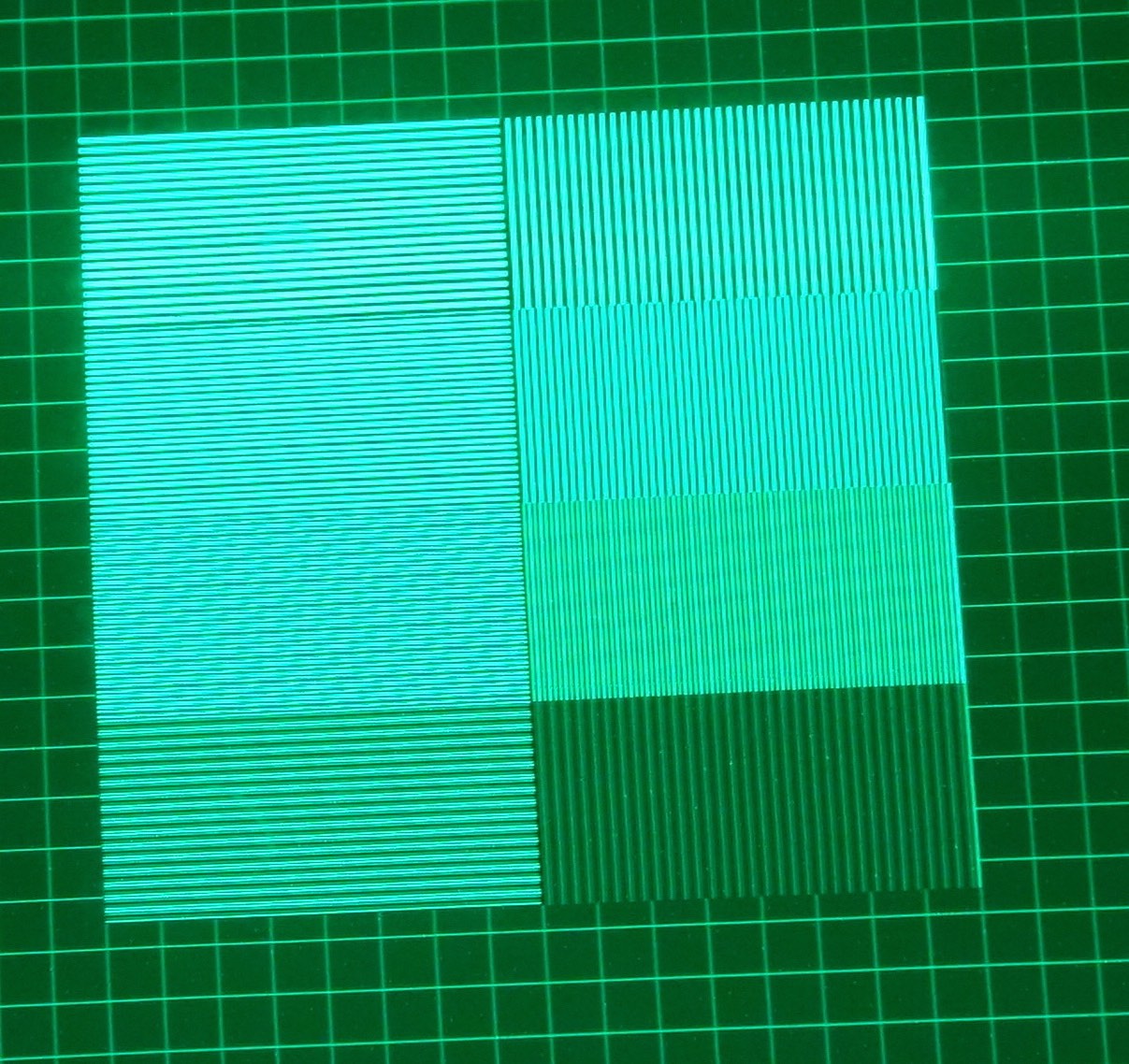

Hi All,
I have just ordered "THE MOD" from Gjaki.
I'll post here the before and after test shots. (green tube only)

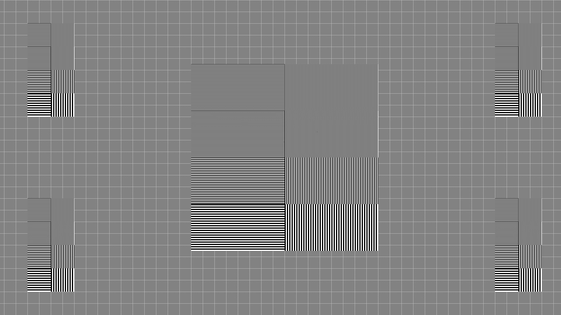

I'll attach also the test pattern that i've used.
test pattern is 1080x1920 and projector is projecting 1080x1920 50P
It'll take a while but I'm looking forward to it.
regards,
Ron
BEFORE green through lens
 Filesize:  327.21 KB
 Viewed:  13948 Time(s)
BEFORE test pattern on the screen
 Filesize:  231.29 KB
test pattern
 Filesize:  115.47 KB

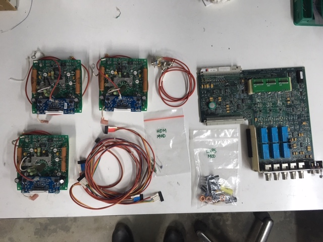

So my parts have arrived.
i'll keep you informed about the progress

The first pix aren't really accurate from what I am seeing, as the contrast level on the 'before' pix are way lower than the mod pix. Everything has to be on a level playing field to do a proper before and after comparison, but I too am looking forward to the pix.
Posted: Wed Mar 27, 2019 2:42 pm    Post subject:
Also, in the before picture some sort of scaling was going on in the source side (seen by the interference pattern on the 1:1 horizontal lines), which was confirmed later by Ron too.
AFAIK there are no modded pictures posted yet.

Posted: Wed Mar 27, 2019 6:08 pm    Post subject:

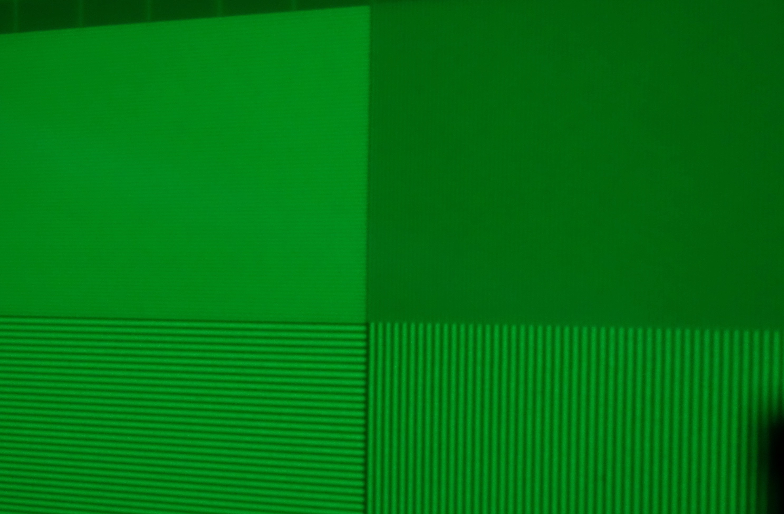

Hi it's me again:
I have installed all the boards and this is what the test pattern in the beginning of these thread looks like now.
1080p 50fps HDMI from MacBook Pro 2016 to Moome v3 external via vga to the projector
Although it doesn't look fully resolved I see clearly a better picture then before. It looks cleaner and sharper, especially with video/film material.
regards,
ron.
 Filename:  resolving.jpg
 Filesize:  475.92 KB
 Downloaded:  446 Time(s)

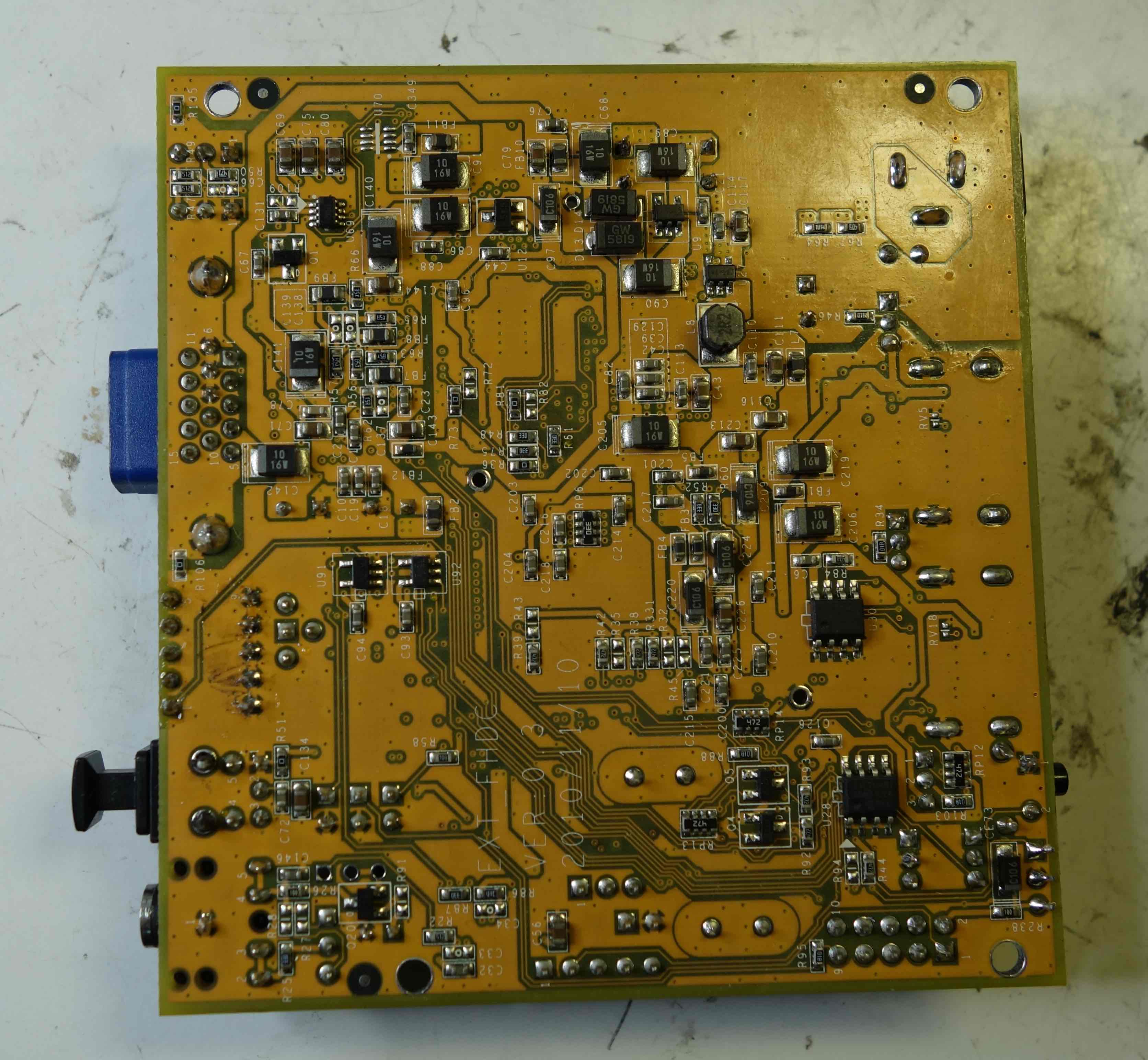

ronaldus
Joined: 25 Dec 2010
Posts: 183
Location: france
Posted: Thu Mar 28, 2019 6:11 pm    Post subject:
Hi Again,

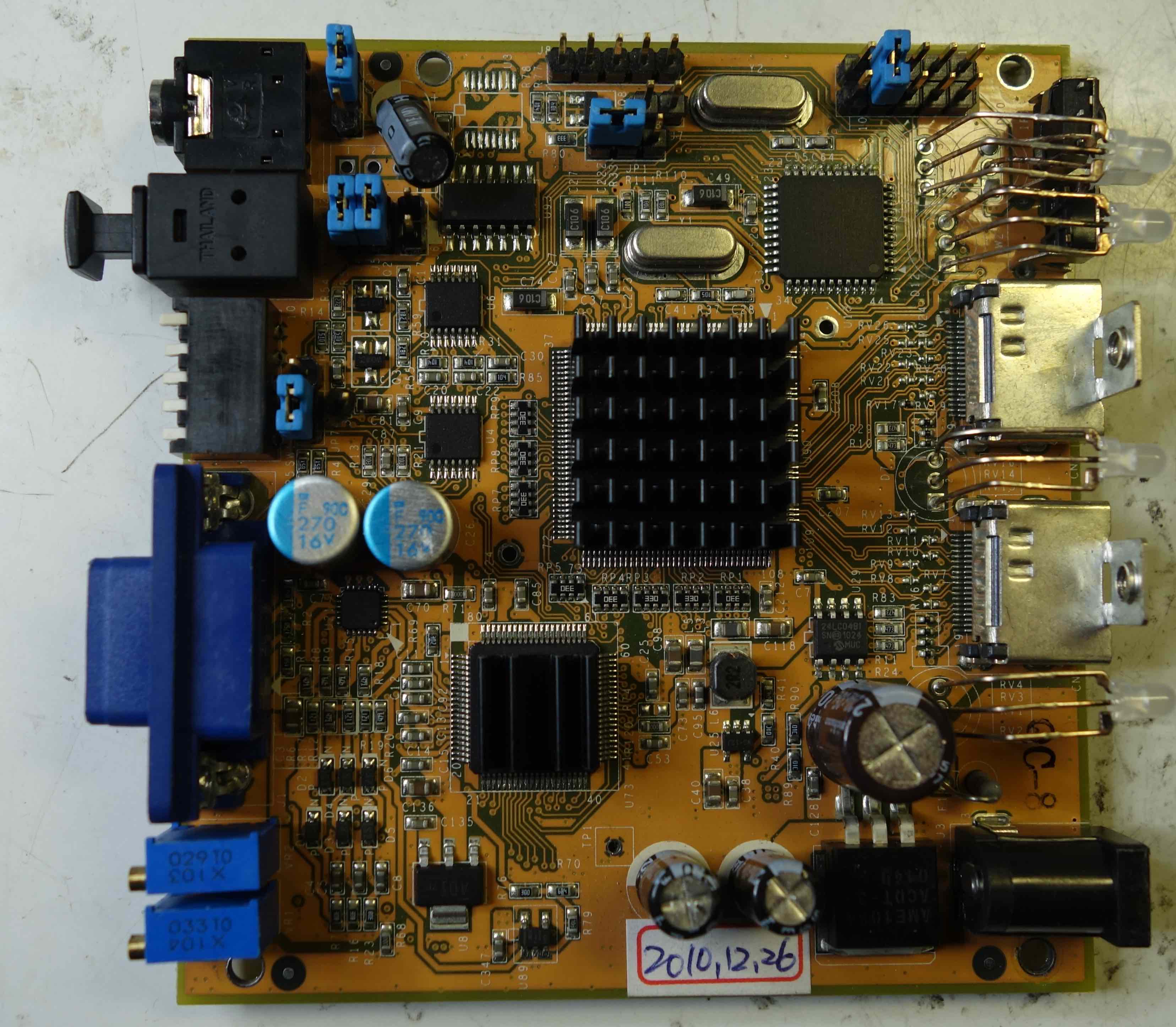

As promised two pictures of the moome PCB
 Filename:  MoomeBackSide.jpg
 Filesize:  480.24 KB
 Downloaded:  414 Time(s)
 Filename:  MoomeTopSide.jpg
 Filesize:  480.8 KB
 Downloaded:  407 Time(s)
Posted: Thu Mar 28, 2019 7:53 pm    Post subject:
I spoke to Craig on this. He said an earlier version of the external did have a roll off problem. The one showing looks very different from what I remember about the one Walter was working on, plus it does not have DAC's I'm familiar with.
If I were you I would get a slot Moome card and considering the improvement you saw and liked and move on. The primary reason for going with a modified card has been met, by your acknowledgement of improvements that you like.
When I was doing mods I stayed away from posting the smpte for this reason, and that's because it's difficult to properly evaluate video mods using that pattern, when other than the HDMI conversion device, I've seen BD players that also prevented the pattern from looking as it should.
And when you get the other Moome that goes in the slot, because that's most likely the one it was designed around, let Gabor know and let him walk you through the testing.

Posted: Tue Apr 02, 2019 6:59 pm    Post subject:
Hi everybody,
So I recapped the LVPS but Gjaki's mods for the standby circuit have not been done yet. I want to compare before and after.
I had one problem while recapping the board where the mains connector comes in: After the recapping and having double checked everything the LVPS didn't work correctly. The contrast was too low and there was distortion on the blue channel in the higher frequencies.
After scratching my head for one day I finally found it. After cleaning the board with an old brush two little hairs had got stuck under two pins of an opamp that was part of some feedback system. The two pins happend to be the + and - inputs of that opamp.
After taking them away everything was fine and I could start recapping the other board.
I have a picture of the testpattern after the recap and a small clip called shaking after recapping downloadable from the following link:
https://cernbox.cern.ch/index.php/s/o8vzBvPg3gTleQ1
If you look carfully at the end of the clip you can see some tiny pertubations in the horizontal lines around the end of the clip. It't hard to film but in reality it's a little bit more visible
I'll do the clip again after Gjaki's mods.
regards,
Ron.
 Filename:  resolving after recapping.jpg
 Filesize:  451.82 KB
 Downloaded:  392 Time(s)
