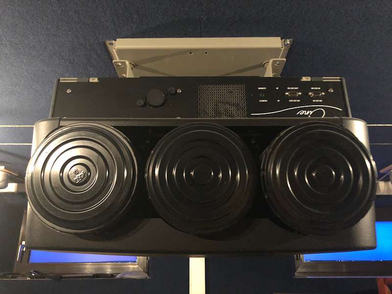

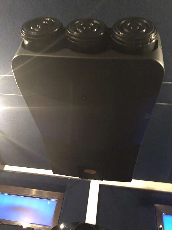

I only have two more pics to offer. Unfortunately i can't give you much more right now. I've seen this "Blackrange" model in a craigslist equivalent here in Europe, but I haven't contacted the seller yet. I can do so, if you tell me precisly what kind of information it is that I should request from him. I'm still a bit in over my head here with regards to the whole topic. When you say 'modules', do you just mean the tubes?
 Filesize:  27.42 KB
 Viewed:  16242 Time(s)
 Filesize:  45.13 KB

Indeed it looks like a barco 908, which has very advanced beam forming features, thereforre it should produce a very sharp picture (for what it is).
When checking a new unit always look at the tube condition without the lenses on the unit (you can find tube wear charts). If the tubes are burnt (worse than 7 on the chart) pass the unit.
As for the other questions, yes the unit seems to capable of 240Hz refresh rate, but this is much like a conventional CRT display, so it can only display what you send to it, it can't convert input resolution to another (apart from the possibility that this particular projector has a built in line doubler, but that is not what you are looking for)
