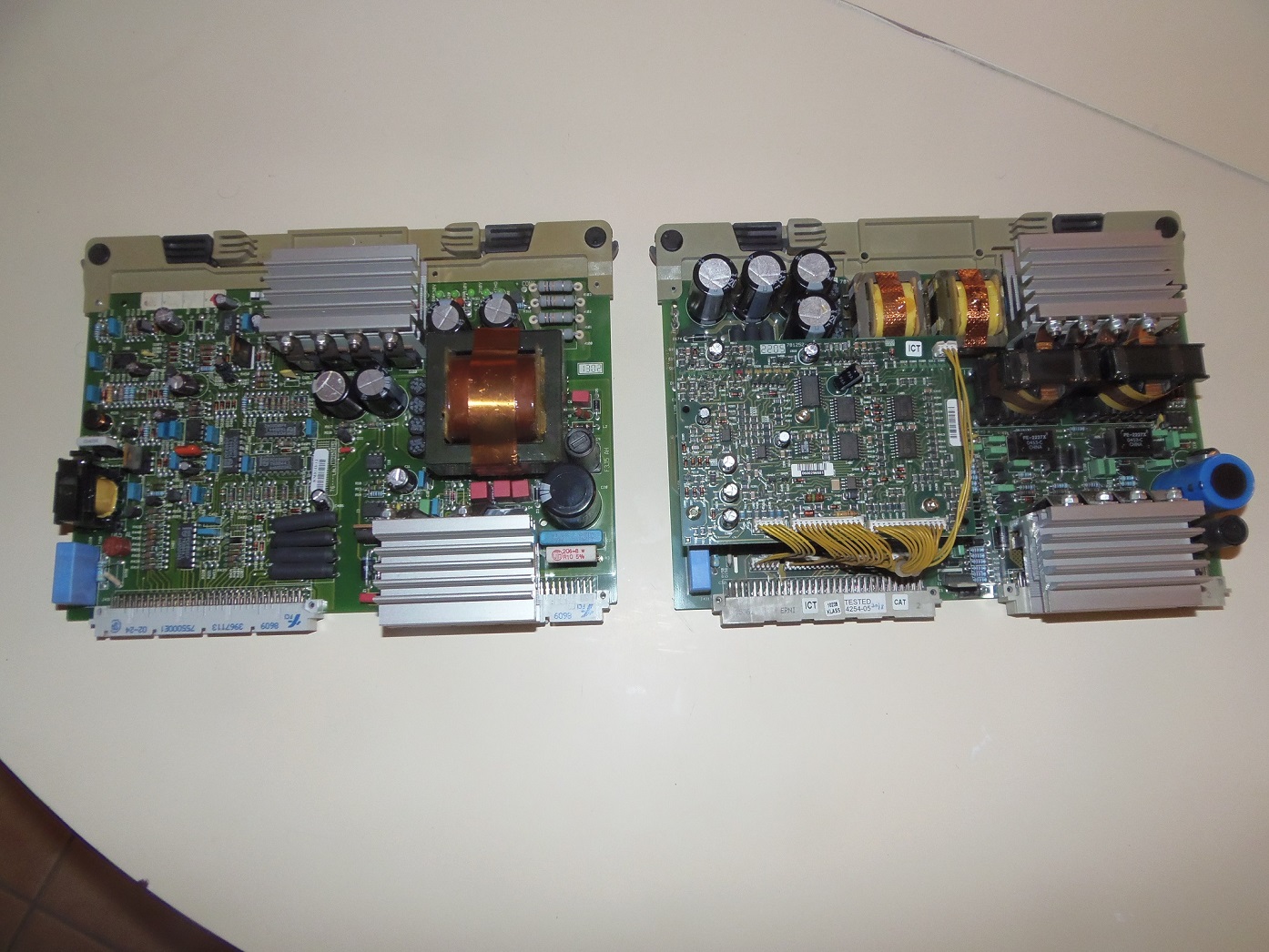

I've almost every board in spare with the PJ (yes that's a good lot :p ) BUT the reference on my spareboard is not exactly the same as the SMPS+G2 installed.
The installed SMPS+G2 board is R7631437 and SMPS is R7631427 ; and my spare is R763143-12 (no seven).
They look quite different.
(My spare SMPS is also R7631427) This seven looks quite an important upgrade.

Picture of the SMPS+G2 differences
SMPS-G2
 Filesize:  442.49 KB
 Viewed:  7033 Time(s)

You'll be fine with both versions, I use them too.
The added 7 it means a newer PCB design. If last digit is 5,7 or 9, is fully compatible. 1 till 4, not compatible.
