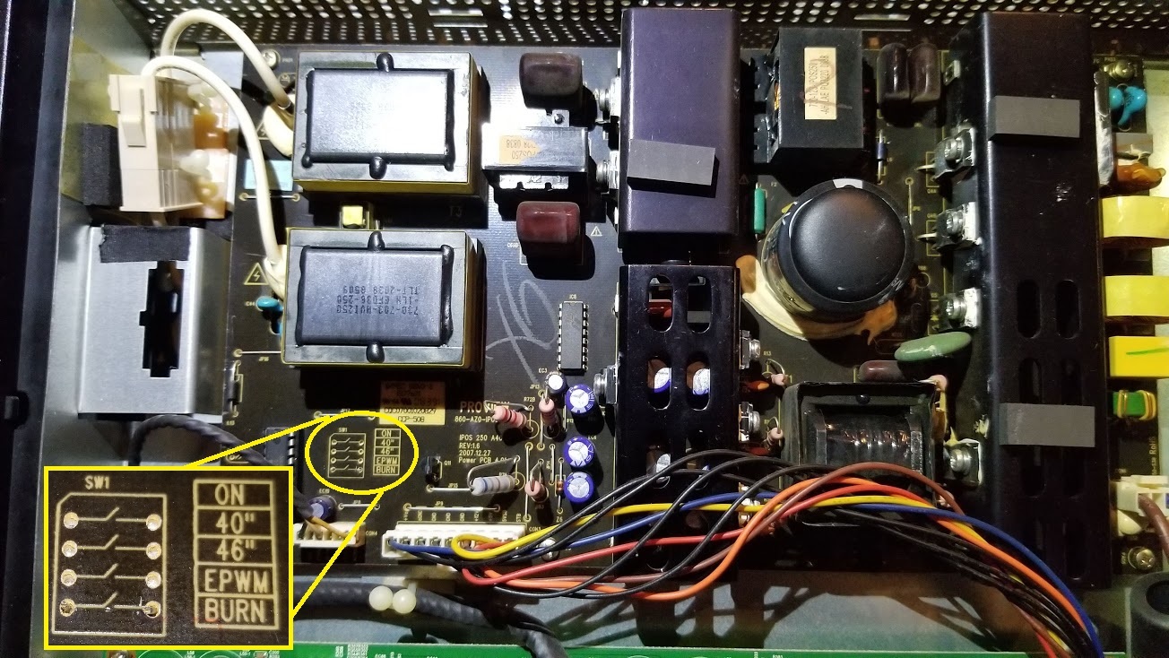

Well, here's the power supply board. I see a diagram of 4 switches (highlighted), but I don't see the switches themselves!! Am I missing something obvious?
It looks like there are thru-holes in that diagram. Am I supposed to stick jumpers in there??

Looks like the right board just no switch. Interesting. Why do those pads look funny on the burn section? Was there something there and cut off?

Seems some boards do and some don't have the dip switches. Maybe depends on the model its going into. The component top middle looks discolored compared to its partner. Maybe worth further investigation. The capacitors under the ventilated cover appear abnormal too, especially the right one.
Posted: Fri Nov 30, 2018 3:42 am    Post subject:
Jumper soldered on during the initial burn-in and the cut to set it to 'run' mode?

Posted: Fri Nov 30, 2018 4:27 am    Post subject:
That's my guess too. There are little cut-off bits of wire in those holes.
The two brownish things top-center are large capacitors. They're slightly different in color but neither one looks cooked.
I think the cap under the cover just had odd lighting. It looks fine. All of the electrolytics look good, no leaks or bulging.

Well then since there is no switch there I would try soldering a wire across the 2 burn pads and see if the tv works or not.
Posted: Fri Nov 30, 2018 7:16 pm    Post subject:
So, just across the BURN connections? Which is presumably "switch #4" ? What about the EPWM pads?
Any idea what shorting the BURN or EPWM connections actually does?

I wouldn't do that. The missing jumper wires is not why the TV doesn't work. It's not like the previous owner desoldered them. Wink The missing jumpers is most definitely normal.
In electronics often boards are etched for use in multiple (different) models. This model TV may not offer certain features so not all the parts were soldered on to the board, but the actual board with the copper traces will be the same across models. It's simpler/more cost effective to have one circuit board etched for 5 models instead of making 5 different board runs. In some models the circuit boards will appear empty or missing parts. Completely normal. It could also be that over the years they simplified the circuit by dropping certain parts but didn't bother to redo the board as that costs money. Again, completely normal.

Just do the burn one for now. Yes it would of been switch 4 if it were there.
Posted: Fri Nov 30, 2018 8:25 pm    Post subject:
Gary, see my comment above. Unless I'm misunderstanding the situation I don't see why you'd need to jumper things in the TV to get it to work. It's not like the previous owner 'un-jumpered' things and caused it to stop working.
Posted: Sat Dec 01, 2018 5:08 pm    Post subject:
Kal, I understand your caution. But consider that in its current state, the TV is a boat anchor. If I do nothing, it stays a boat anchor, and I'll have to pitch it. So I'm not worried about damaging it. As long as it doesn't set my house on fire, I'm willing to try possibly-crazy stuff to see if it helps resurrect it.
That said, I'd like some assurance that this is a reasonable thing to try. pch, can you explain what the BURN and EPWM jumpers are supposed to do, and why you think it might help the situation?
