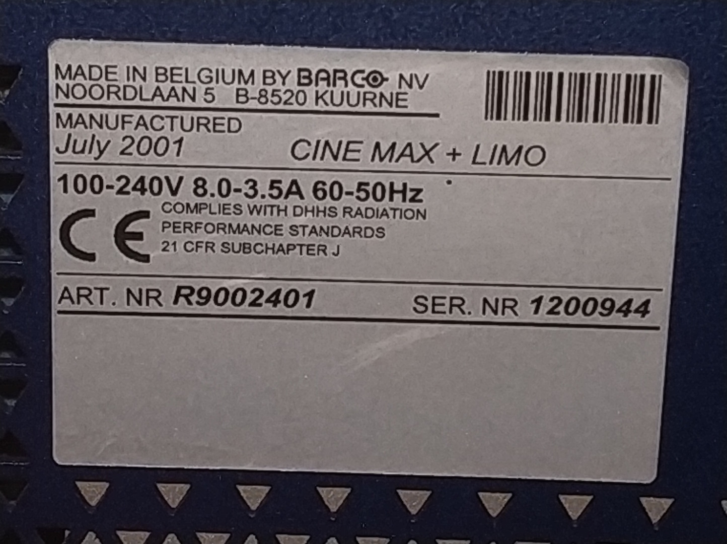

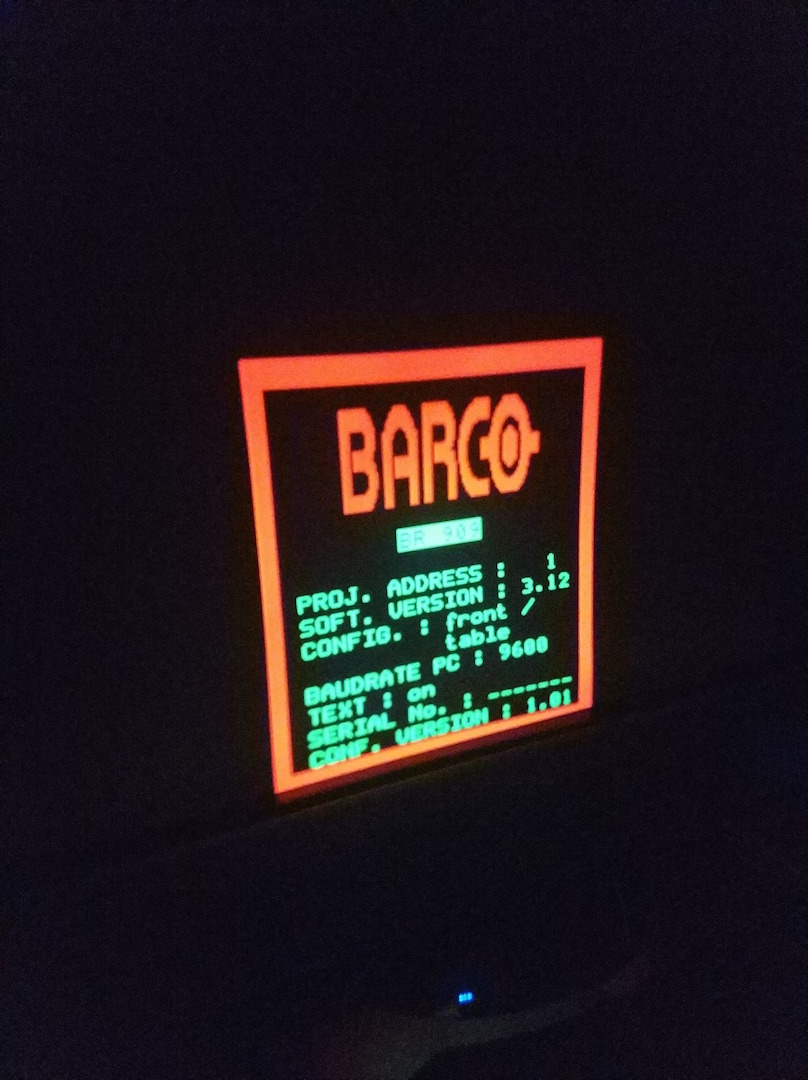

Hello.
I have a question: I bought a CineMax projector. It is in excellent condition with a runtime of 2600 hours. When checking with the seller, everything worked fine. I changed the location from the ceiling to the table and reset all settings to the middle position and reset the memory bank. After that, in the identification menu, it is called the BR909 and does not show its serial number.
What does it mean?

It doesn't have anything to do with the scan conversion, it means that the controller does not belong to the projector. It has been changed in the past with a spare part BarcoReality 909 controller. However, with the exception of the run hours not being genuine, there is no reason to be worry about. If the tubes are in good shape and the projector is working well, enjoy.

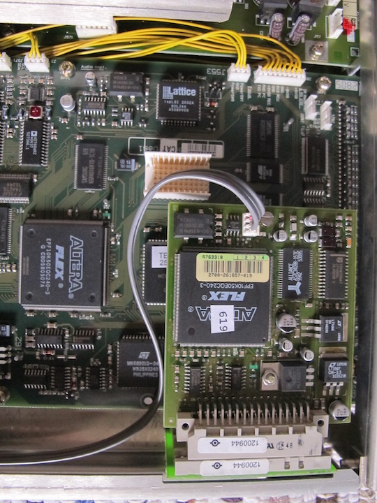

I still do not understand much in terms of what is a controller? When I bought, I looked at the menu - there was indicated CineMax and the serial number, if I'm not mistaken. And I don’t have the IRIS item in the menu, although the board and the lens are in place. The tubes are in excellent condition, only on the green there is a minimum burn- sure that the running time is genuine.
Unfortunately, I have not yet been able to configure it - it is very difficult for me.
 Filesize:  288.96 KB
 Viewed:  8943 Time(s)
Is it an IRIS board?

Controller board is the processor of the projector, the big card under the small one (iris controller) in your last picture. It is definitely not a Cinemax controller. Production of Cinemax was ceased in 2003 and the manufacturing date of your controller is July 2005. Again, no reason to worry. Same hardware, different software.
Check if the gray cable from the iris controller is also plugged into the lens-pcb, could be the reason you don't see the iris option in the menu.

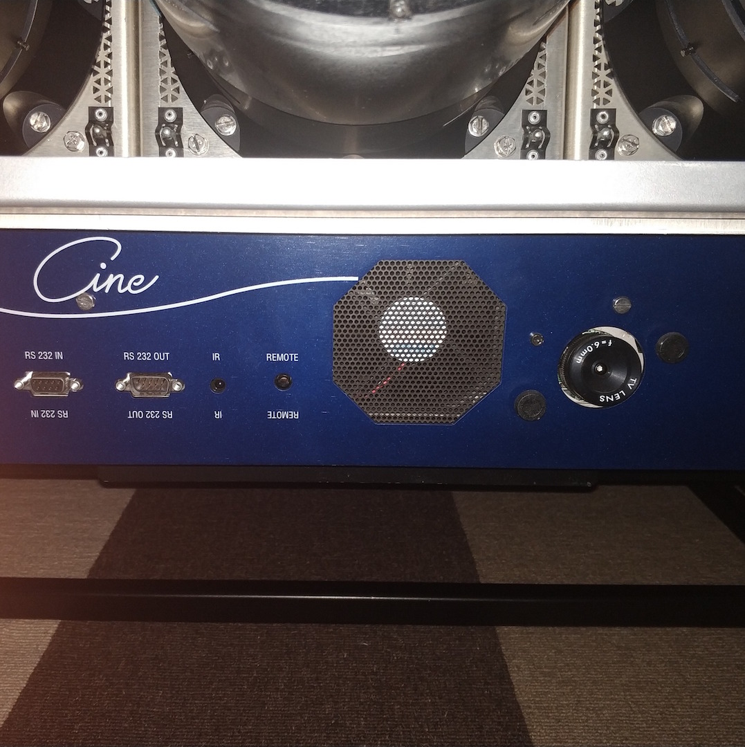

I checked the cable to the diaphragm - it is connected. Board IRIS is also in place.(Photo)
How did you determine the date of manufacture of the controller?

On the right-upper corner, you can see a white stamp with "2805" on it. It means the controller was manufactured in week 28 of year 2005.
Ok, if the iris cable is not loose, must be the mini card that's connecting the iris board with the controller. From your picture, it looks like the card is not firmly pressed into the controller slot. Normally, it is secured with two screws on the underside of the drawer.

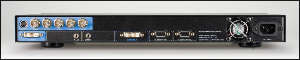

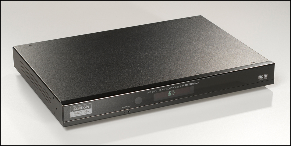

Will this processor be useful to me?
This is the Meridian DVP1080MF- I can buy it for $ 200

If you are running HDMI, I don't think you need any processor to start with. A lumagen scaler will add to the image quality, but until you have set up the projector, and have learned to do a full setup, I wouldn't complicate things with adding an external processor for now.
