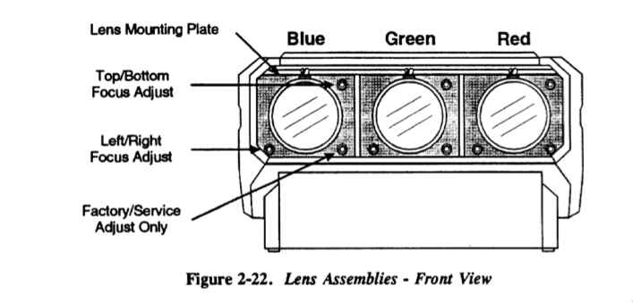

Posted: Fri Oct 12, 2018 3:36 am    Post subject:
Dang, messing up the forum postings.
I asked about this years ago.
This what I need adjusting.
From the 8500 manual.
Anyone recall the driver size and length needed to reach the bolt?
 Filesize:  104.4 KB
 Viewed:  3531 Time(s)
Posted: Fri Oct 12, 2018 5:06 am    Post subject:
"Bondhus.......James Bondhus" LOL
5/16 Allen, 9.5 inches. Cost you $30.00 mailed.
Posted: Fri Oct 12, 2018 5:33 am    Post subject:
I can't find mine now, but I made one from a couple of stock tool parts at Home Depot -- $15 or so if I remember right (but it's been over 10 years sooo...)
