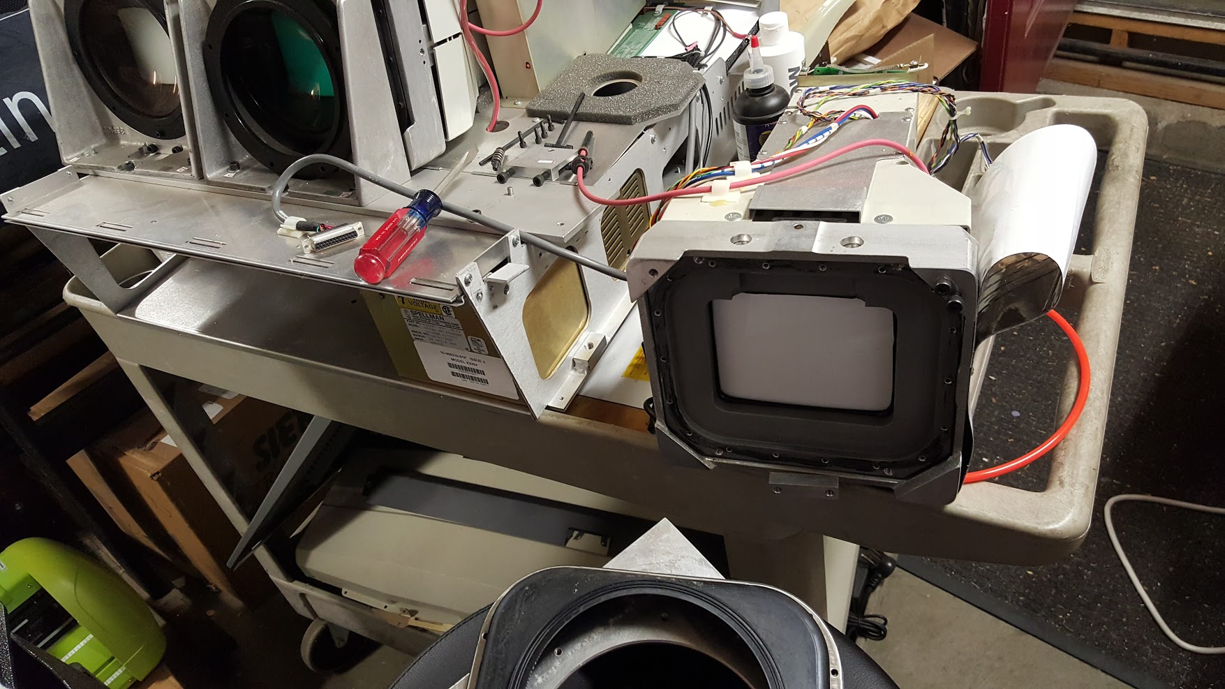

Posted: Sun Jul 15, 2018 3:46 pm    Post subject: A little CRT maintenence on the 8500LC
Ordered the bellows over a year ago and just haven't had time to install them.

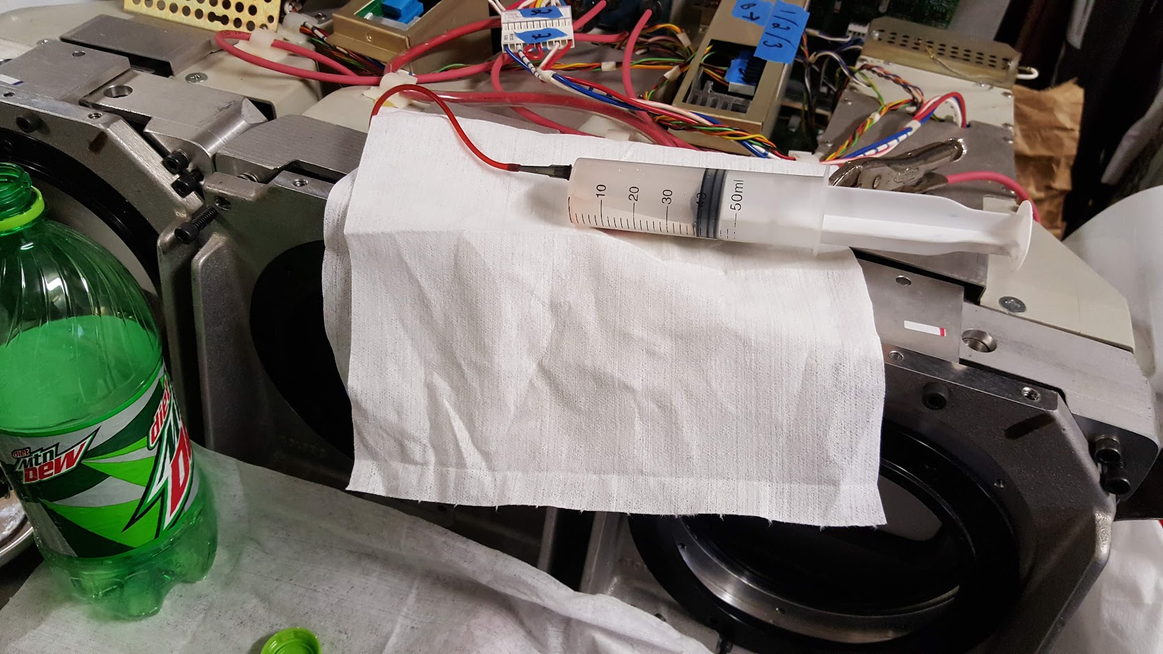

Posted: Sun Jul 15, 2018 5:42 pm    Post subject:
Sucking out the coolant.

Posted: Sun Jul 15, 2018 6:06 pm    Post subject:
Hello
Recommend cleaning the chambers with distilled water rinse, household ammonia soak, rinse again, and use fresh glycol. And get stainless steel fill hole screws if not already.
modelaratrod
Joined: 26 Jul 2011
Posts: 168
Location: Denver, CO.
Posted: Sun Jul 15, 2018 6:09 pm    Post subject:
Thanks Tim, will do. I've got new IceClear.
