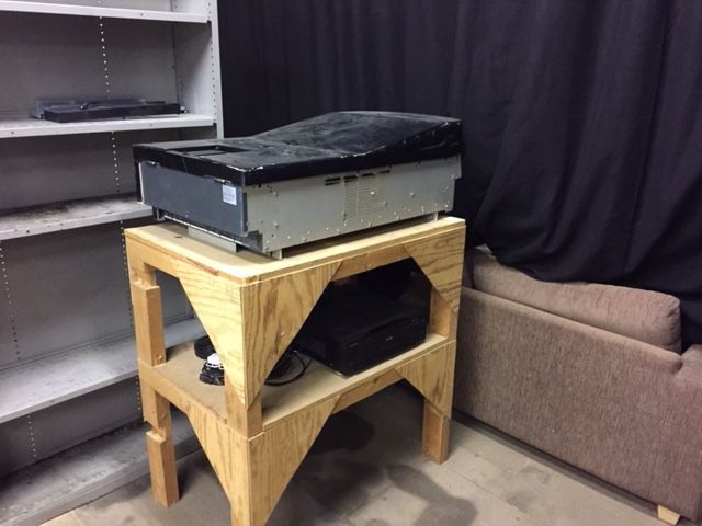

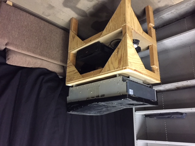

Set the 4:3 picture on the tube face to give reasonable margin to the edges and backed the projector until reasonable overlap to the screen and rose the back of it to center the image.

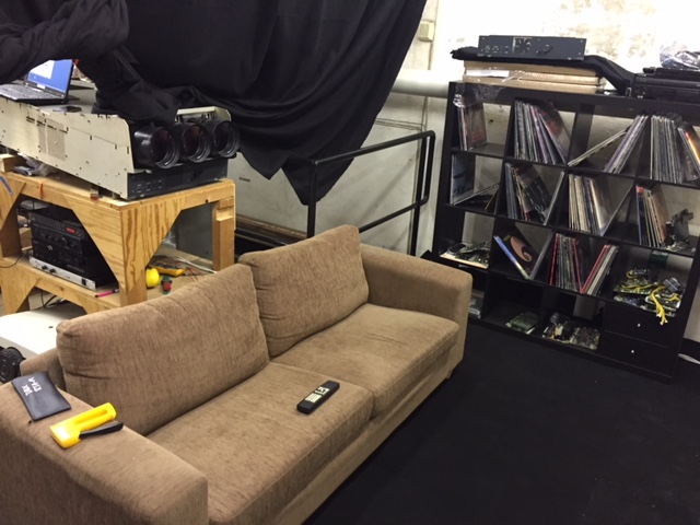

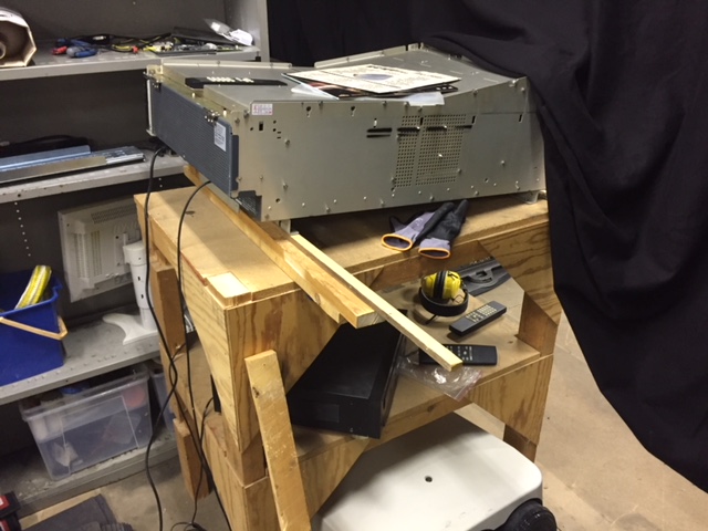

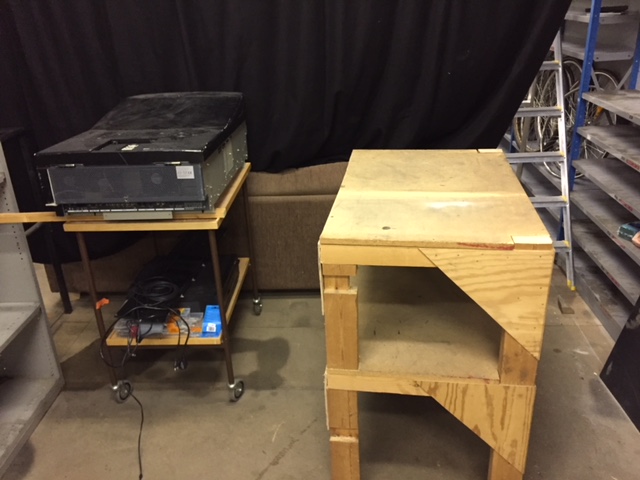

Some old shelves where destined for the scrapyard but I cut one of them down to fit the projector and one shelf for amplifiers, scaler, HTPC and LaserDisc player. Not really a thought though construction, but it does the job.

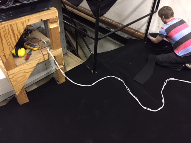

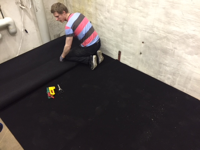

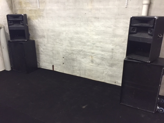

Sound:
Next step was sound and boy do we have a lot of old projects from when money was tight but time, energy and ambition was high back in our 20s. My old dual JBL 2226 15" cinema subwoofers has seen several parties in the past but they are not meant for the road since they are form an old cinema installation. On top we have our old LEM 12" horns with whopping 400 W RCF drivers, some plastic CD horn and piezo tweeters. Not what you would call HiFi and they have a very distinct "horn" sound in the midrange. They are however available an play as loud as you would ever need. Let's see if they will be replaced in the future.

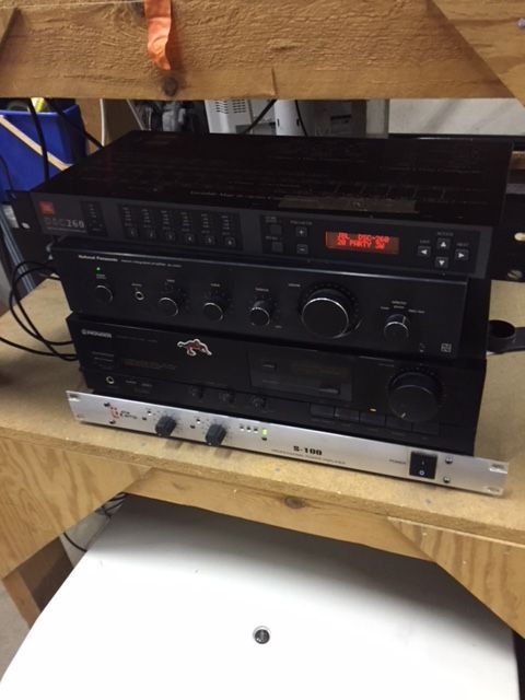

I have been saving an JBL DSC 260 three-way DSP based crossover for a long time now and the day finally came. Glorious rubber debounced buttons and a manual written by engineers to scare off the end user! I'm a big fan of parametric EQ on the output channels on crossovers and time-alignment which we made full use of to "de-horn" the sound of the midrange as much as possible. My friend has the best absolute pitch I've ever seen except for some savant kid on TV and it's truly amazing to see him at work with the EQ.

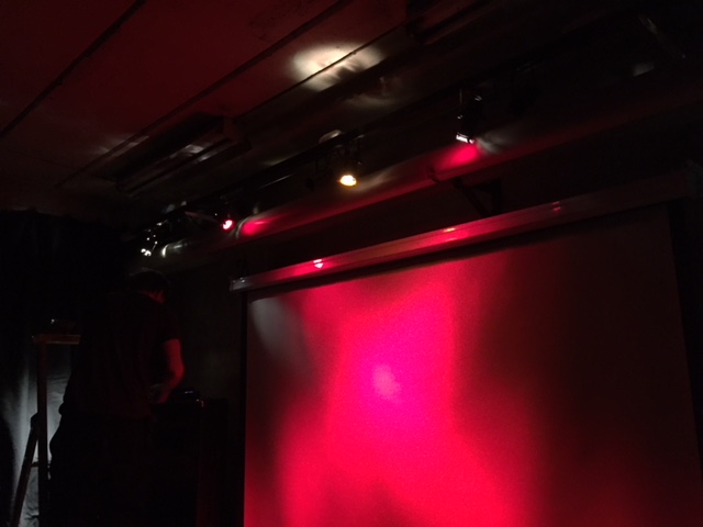

By this time, you could say we had a cinema going but it was time to break out the secret weapon which even rich cool inner-city kids girlfriends won't allow them to buy despite the latest 4K laser-pumped projector, wall to wall black carpets, thick black molton on the walls and black fabric for the ceiling! Carpet was the easiest part although it did warp a bit which we pushed under the sofa. It sucks shoe prints worst than an episode of CSI, so the cinema is a shoe-free zone.

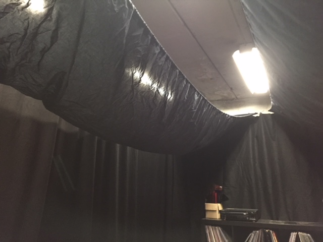

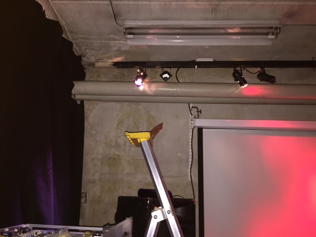

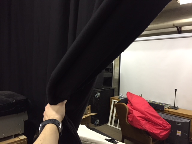

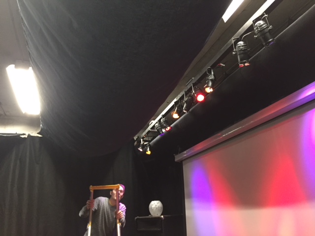

We ran steel cables across the ceiling an hung the black molton from it. Some pipework required a bit of tricks and custom cut pieces but they are properly wrapped in now.

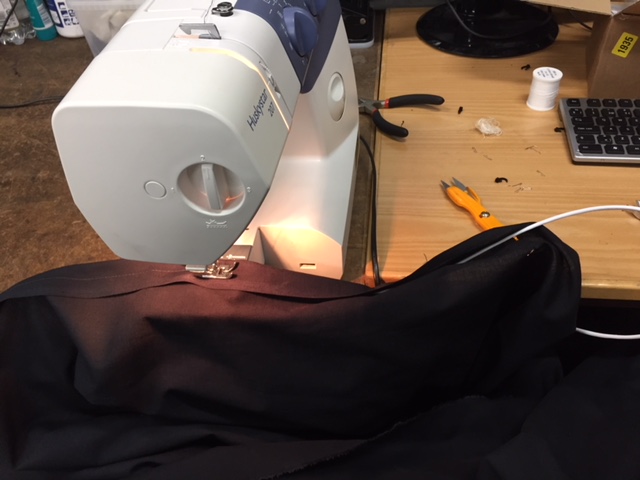

For the ceiling, I borrowed a sewing machine and folded in plastic cable/rope. Not sure about the English term for them, but they are hanging from the steel cables but orthogonality and we didn't cover the florescent fixtures so it's still possible to light up the place and do work. The cloth is a bit too shiny although it does dampen out light more than the white ceiling. We tried heaver cloth but we would need to make fixture points for it. Good enough for now.
By this time, it became very black and pausing and getting up for more popcorn or similar required a flashlight. I've seen several cinemas with colored lights on the screen before the show starts. We were a bit low on space to hang them from so we made a 45x45 mm wooden beam (what's the English term?) with PAR16 in various colors, painted everything black and connected it via remote control.

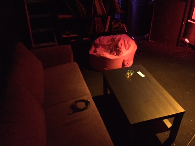

Got a black IKEA LACK table. Cheapest there is. And black. Win-win.

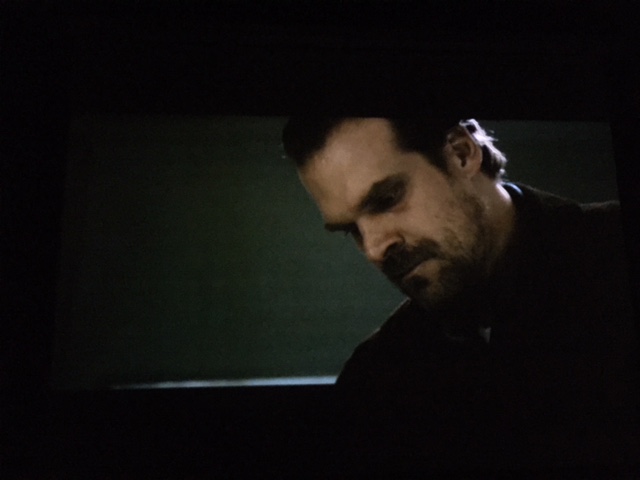

Mobile phone camera image of how it looked. The black levels is a problem. Dark gray dissapears as black and convergence is a problem.

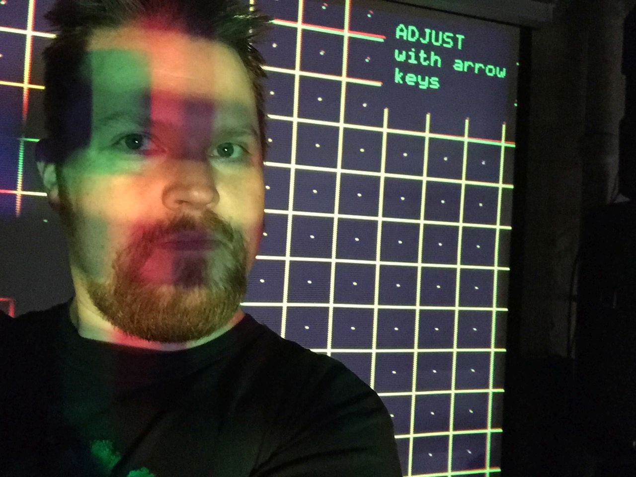

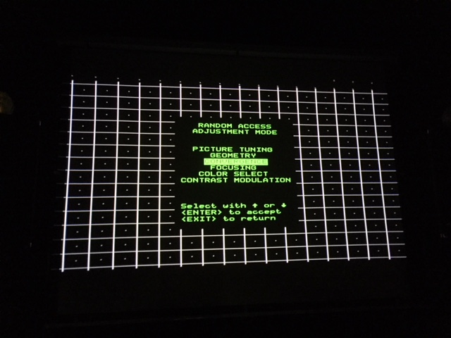

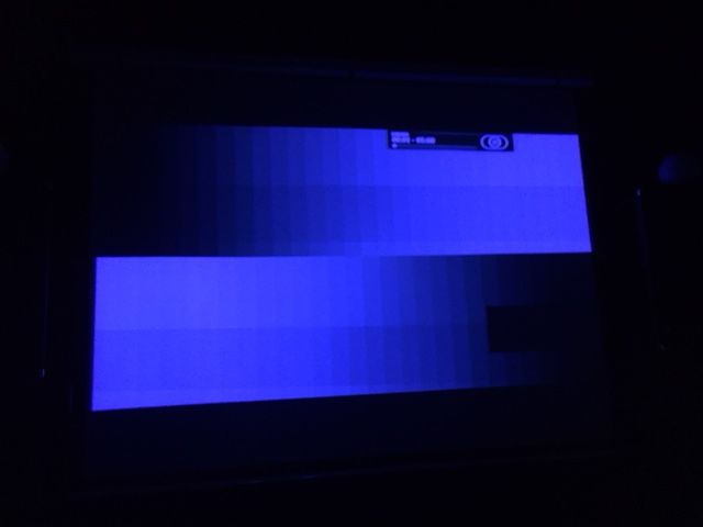

We watched several movies in this configuration, but I was never really happy with the convergence. When I had an entire day off, I installed Decibels old 120 MHz neckboards which he sold me several years ago, reset everything to mid position and adjusted the analog red and blue V and H shift and H size (is there an V size?) and made reference markers outside of the screen to help me level everything. Paid more attention to the electronic astigmatism and got a much sharper image.
I spent some time displaying a gradient for each tube and tuned the gain and offset to the best I could. No external CMS, just what's available to me. Dark gray didn't get the gamma boost it needs, but better.

Images to come, but we where blown away with the black level. When something faded to black, you lost perception of the room. A bit unreal at first Smile
As bright as you would ever need it considering the pitch black environmen.
Front fan is just a few dm form your ear. I will try to make a shroud for it. It's too open at the moment in order to the IR eye reception.
Unless there is too much black-white contrast in the same image, it's FREAKIN' CINEMA IMAGE QUALITY. It has a "softness" to it which you just don't get with digital.
Corner focus could be better.
Ghosting due to AC.

Amplifier and crossover
 Filesize:  42.6 KB
 Viewed:  10919 Time(s)
First test :-)
 Filesize:  164.6 KB
 Viewed:  10932 Time(s)
Setting image width
 Filesize:  37.58 KB
 Viewed:  10937 Time(s)

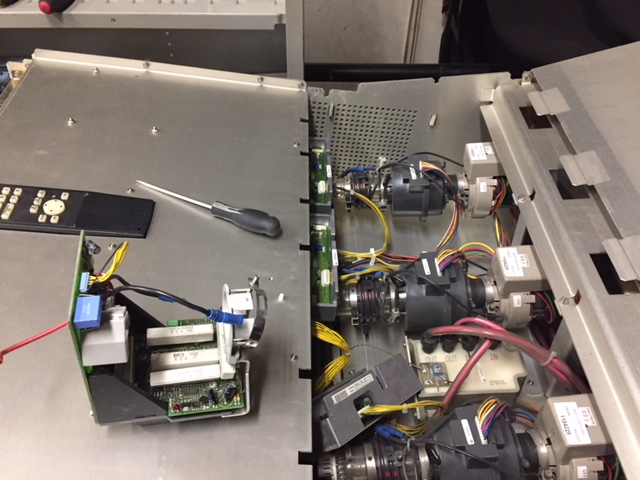

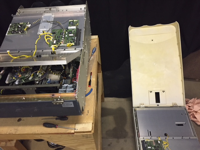

Salvaging parts form the BG808s to the BD808s. A motherboard transfer made it an effective BG.
 Filesize:  100.08 KB
 Viewed:  10938 Time(s)

Just FYI on the speakers:
1) I'd get rid of the piezo tweeters, and use a dome tweeter.
2) I use EAW speaker cabinets, two double 15s per side, and the LCR are 12" with a horn. Can't remember the model. I found with the automatic setup in both the Onkyp and the Pioneer receivers that I've used, they do the eq perfectly, and my fronts and overall theater are very natural sounding.
If you're happy with things now though, then leave it. If you don't have a surround receiver, I am going to sell off my high end Pioneer 7.1 receiver soon. It's now a 'preceiver' as the power amps were shot and removed, but the DSP and preamp outs work fine. Original remote included. Will post in the buy/sell in the next month.

Sewing
 Filesize:  76 KB
 Viewed:  10922 Time(s)
Ceiling install
 Filesize:  64.41 KB
 Viewed:  10925 Time(s)

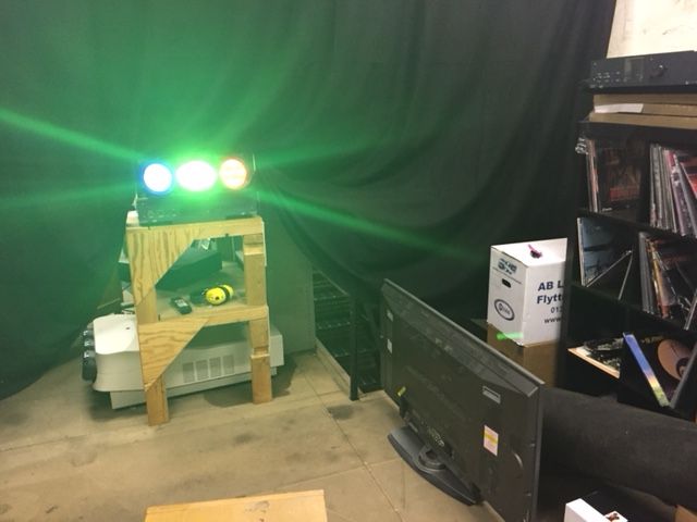

Lights in action
 Filesize:  56.07 KB
Colored lights on the screen, installation
 Filesize:  71.6 KB
Laserdisc collection and sofa
 Filesize:  109.42 KB

Posted: Sun May 06, 2018 3:10 pm    Post subject:
I like the fact you put the projector and cart on the ceiling. Did you do that just so you could watch Stranger Things and make the upside down right side up? Laughing
The upside down
 Filesize:  96.13 KB
 Viewed:  10907 Time(s)

Gradient
 Filesize:  13.99 KB
 Viewed:  10884 Time(s)

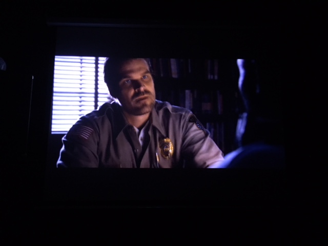

Stranger things, after calibration
 Filesize:  53.07 KB
 Viewed:  10891 Time(s)
After re-calibration
 Filesize:  87.25 KB

IKEA LACK table
 Filesize:  68.71 KB
