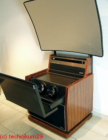

Posted: Mon Apr 23, 2018 2:54 am    Post subject:
For a total retro feel try this:

Yeah, the Sony kp5010 looks really cool and would fit the feeling I want in the room. But I guess it don't will give the image quality I want.
