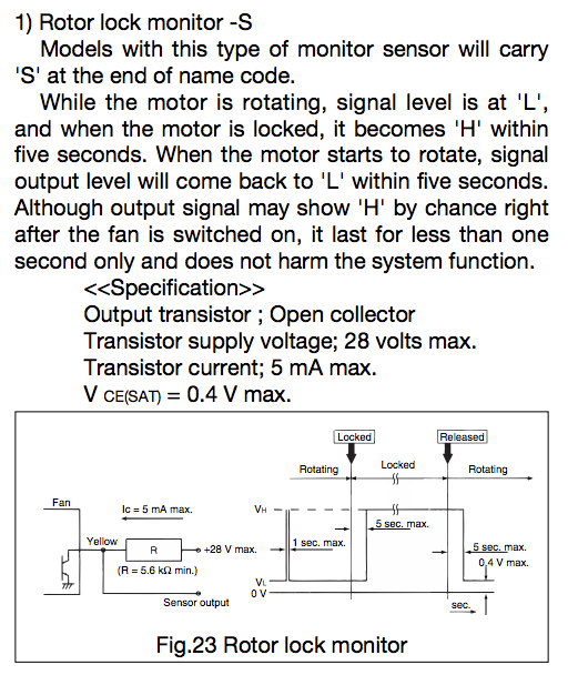

Concerning the front fan itself, I got the specifications from another thread and noticed it was an "S" type. So the signal line (the 3rd wire) does not carry a speed signal, but a "fan locked" signal. Thats why some people reported problems with the SilenX fans as these do only carry a speed signal. The stock fan has a low signal only when the fan is running. Other fans have high/low signals depending on fan position, so when they get locked theres a 50% chance the projector will continue to operate.

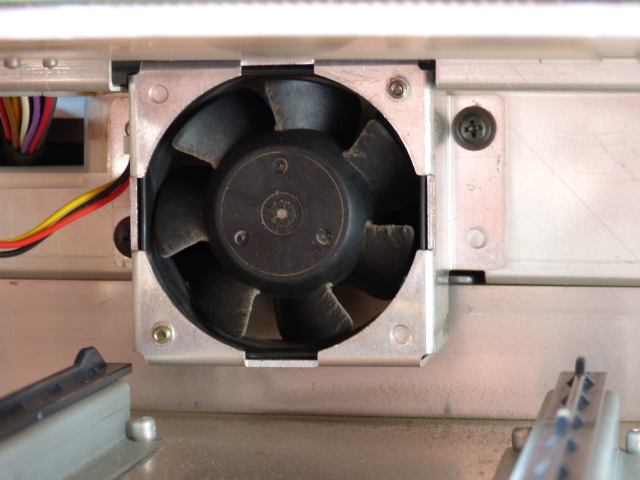

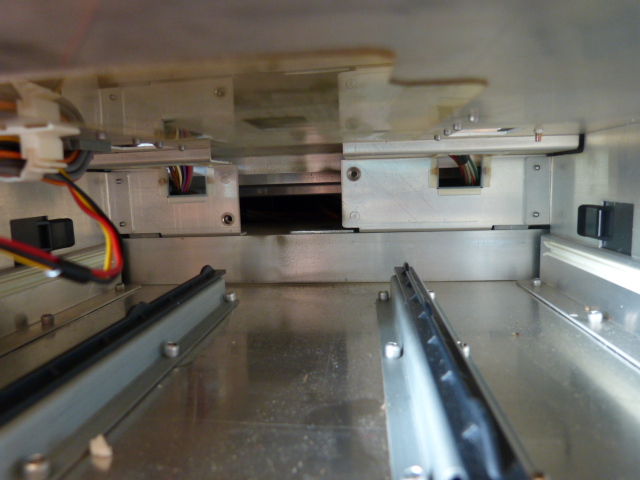

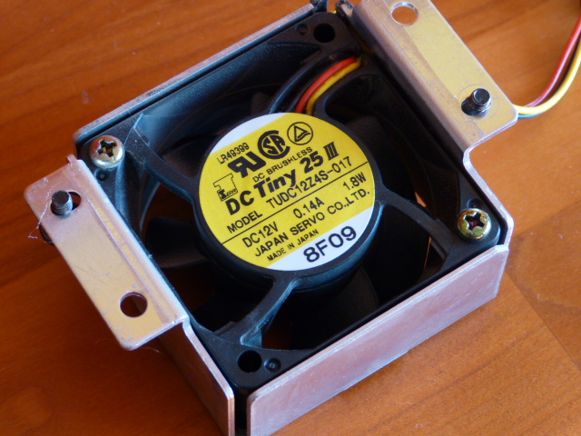

Here are some pics of the front fan.
- still mounted in the cabinet (you can see the dirt below the fan)
- unmounted (with modell number ...S)
- the remaining (small!!) hole
What I found out so far:
- the fan, mounted in a cardboard funnel of 15x15cm and 50cm long produced 0,3-0,4 m/s at the end, running with 12V.
- the hole the fan is pushing the air through is RIDICULOUS! Some 40% of the fan is working against a surface! And behind the hole are cables in all directions. Not good for the airflow, neither for the acoustics.
- when holding the running fan between fingers it has a distinct whining noise and it vibrates a lot!
cheers
Martin

I had a closer look at the fan opening. There's another obstacle on the top side (see the pictures) just behind the enclosure, giving roughly 60% of the surface of the fan that is working directly against a surface!! When I leave the fan out the surface for the airflow through the hole increases since the fan itself can only passes air around its motor, and this motor sits right in the middle of the remaining opening. I estimate the surface available for airflow being at least 100% larger once the fan is out! BTW, there are openings for cables that can be seen on the upper right and left of the enclosure, where air could be sucked back in (back to the fan), further diminishing the fans efficiency.
