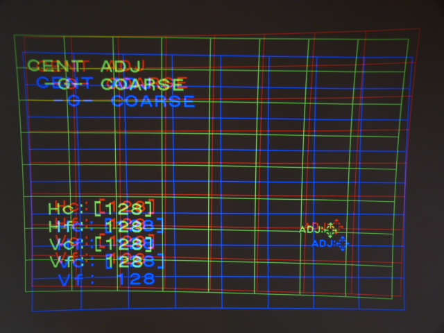

Hi all,
here is a picture I took after having set everything to 128 (except focus controls), before aligning the tubes.
I wonder if it is normal that the blue tube is a so much lower than red and green. Is there a mechanical part or a trimpot somewhere where I can manipulate vertical position / size before applying software controls? Like the 3 adjustments for horizontal witdh.

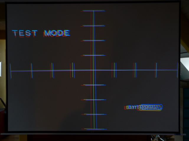

The second picture (actually the first in the post - how can I swap these?) has been taken after tube lineup and first setup of size and position. No linearity / pincushion / keystone / zone.
I watched the CRT setup-video. Its for a G70, so very familiar to mee by now. Yet a slightly different approach, but well explained and rather intuitive. The only thing I didn't understand is that it seemed he never actually adjusted the projector height - the image was vertically out of center (too high) all the time he did the adjustments. I must have missed the moment where he either adjusted the vertical position values, or raised the back of the projector.

AFryia
Posts: 965
Posted: Sun Mar 18, 2018 4:05 pm    Post subject:
Apfelmousse wrote:
Hi all,
That actually looks very good.
Are you maximizing the raster size or using the factory conservative sizing? If you plan on maxing the raster you will want to make sure that the raster is centered on the tube, and not touching the edge.
Yes in my experience vertically the tubes rarely line up. Yes there is a pot but don't mess with it, just use the electronic controls.
Have you performed a quick Scheimpflug adjustment? When you adjust lens flapping the image on the screen will shift slightly. I would adjust lens flapping; mechanical toe; and vertical tilt in a couple iterative steps. If you don't you will require more electronic adjustment to get the geometry right.

Posted: Sun Mar 18, 2018 5:13 pm    Post subject:
At that stage everything has been set to 128, so no raster maximization yet. The later picture with the correct lineup uses maximum raster. That's why I had to photograph the whole screen, not just part of it Smile Size values are close to max, around 240-250.
Which pot? (Trust me, I'm tech savyy. You may send me a PM...)
That's a really good advice, thanks. I did touch Scheimpflug to see what happens, but that was prior to watching the setup-video so I did not really understand how to align it properly. BTW, Scheimpflug adjustment seems to be way easier on the G90 than on the G70 as the G90 does not require loosening any screws.

In terms of vertical alignment and the trim pots. On Barco Projectors there are two trim pots on the vertical and horizontal boards for green and red. I would think the same would exist on your projector. You should find those that adjust the vertical for both blue and red. Green is usually the reference colour so there is no adjustment.
Apfelmousse
Joined: 26 Apr 2014
Posts: 74
Posted: Mon Mar 19, 2018 9:01 am    Post subject:
I had a closer look last time when I adjusted the horizontals (there are 3 alignments, accessible through the top cover) but could not find anything similar for vertical. Some boards carry dozens of trimpots, but without names. I'm still quite lost in the dazzling Sony-style array of boards without meaningful names like SA, SB, YA.... (transcripts from Japanese writing?).
Will have to check the service manual, perhaps I'll find something there.
