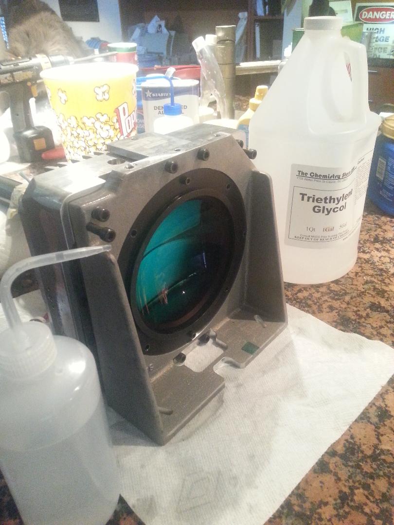

I had to clean up three tubes this week, there was a thick film inside of the C element. Common Ammonia works really well at a fraction of the price of CLR. Soak for an hour and shake a bit, that's all it needs. And rinse with distilled water.
