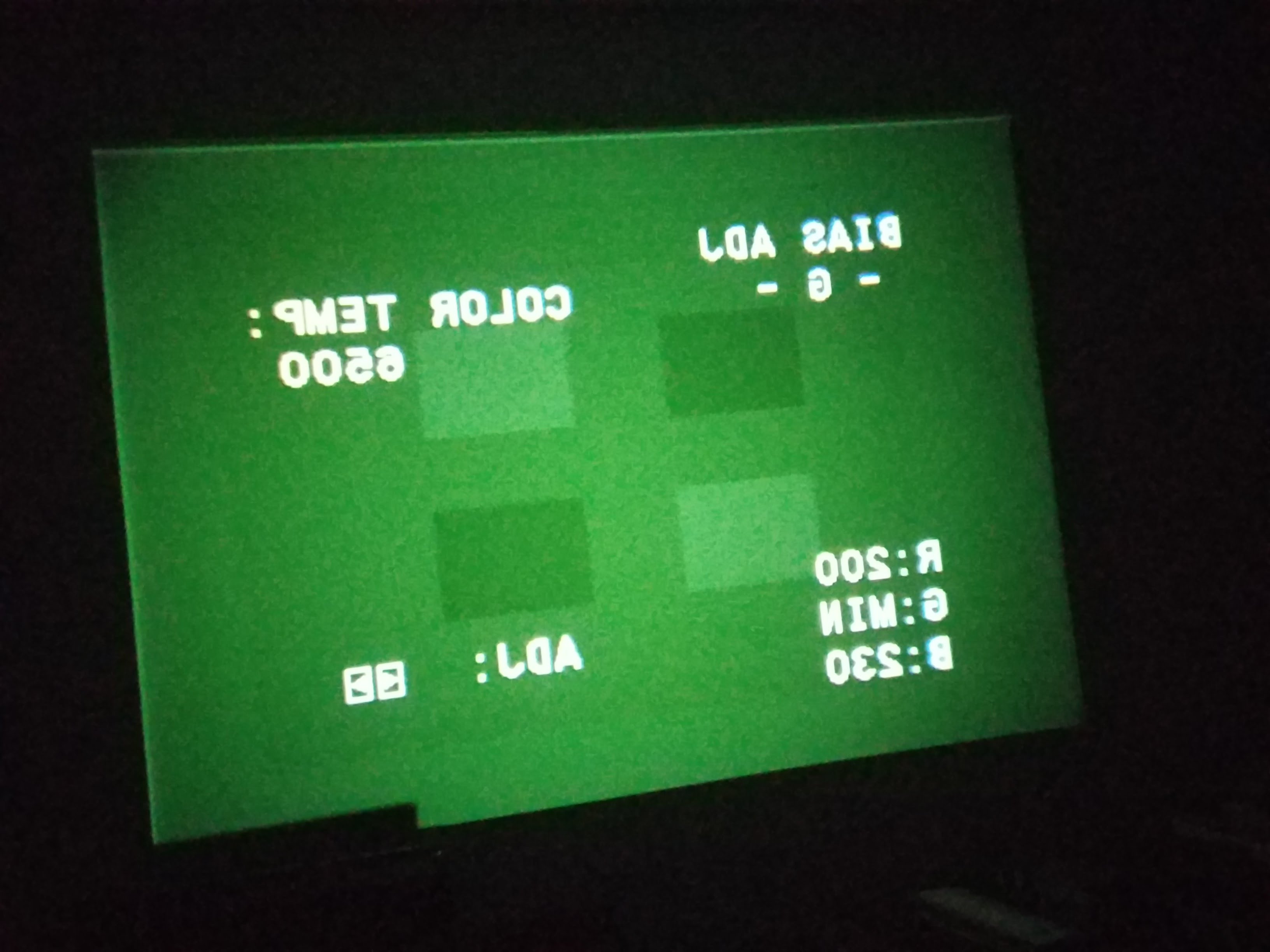

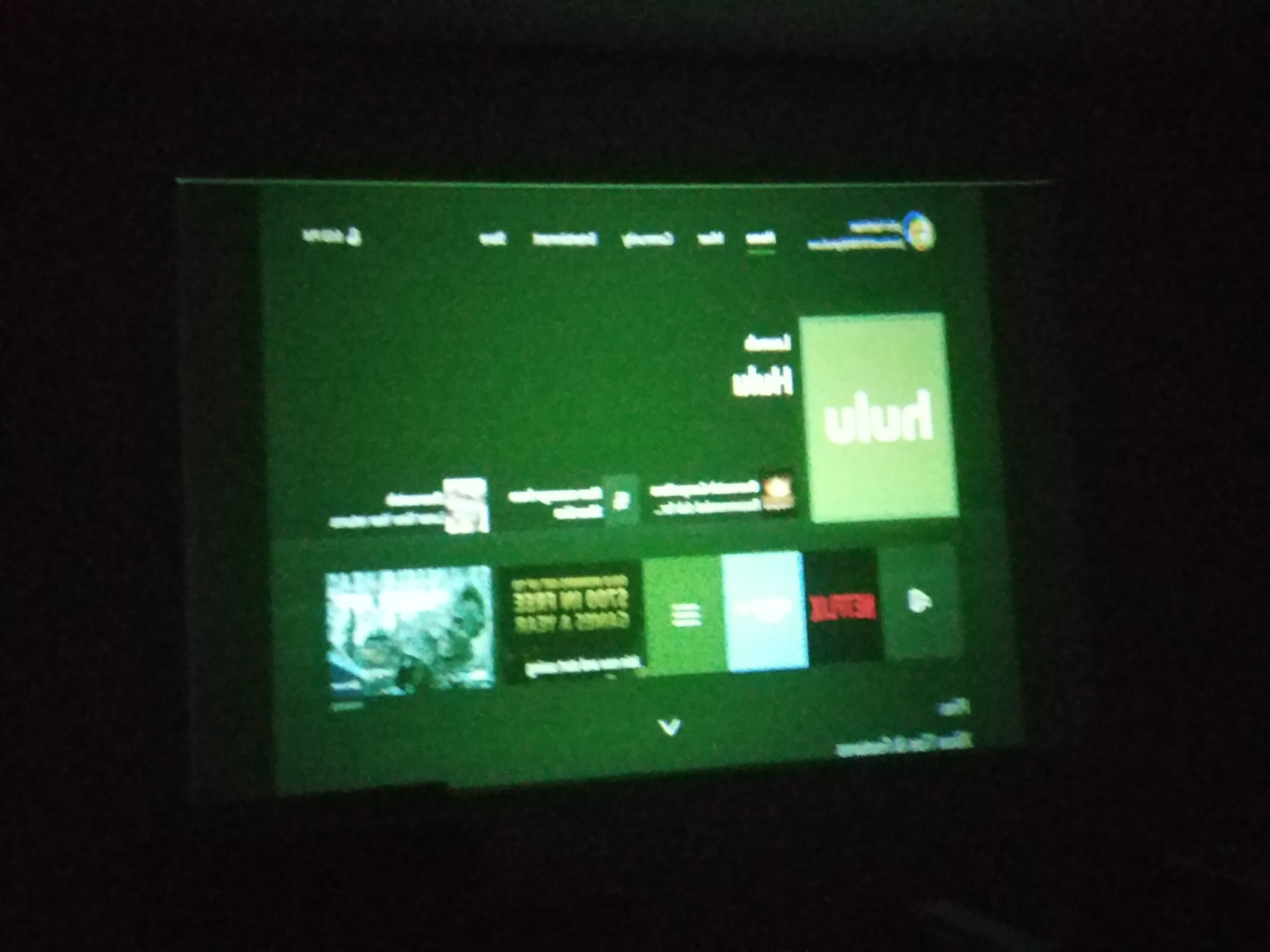

Posted: Thu Feb 08, 2018 5:26 pm    Post subject:
Look at the internal test patterns first. ARe they tinted green? If so, there's something wrong, or out of whack with the internals of the set. If the test patterns are fine, then I'd suspect an issue with the RGB input board, or something with your source.

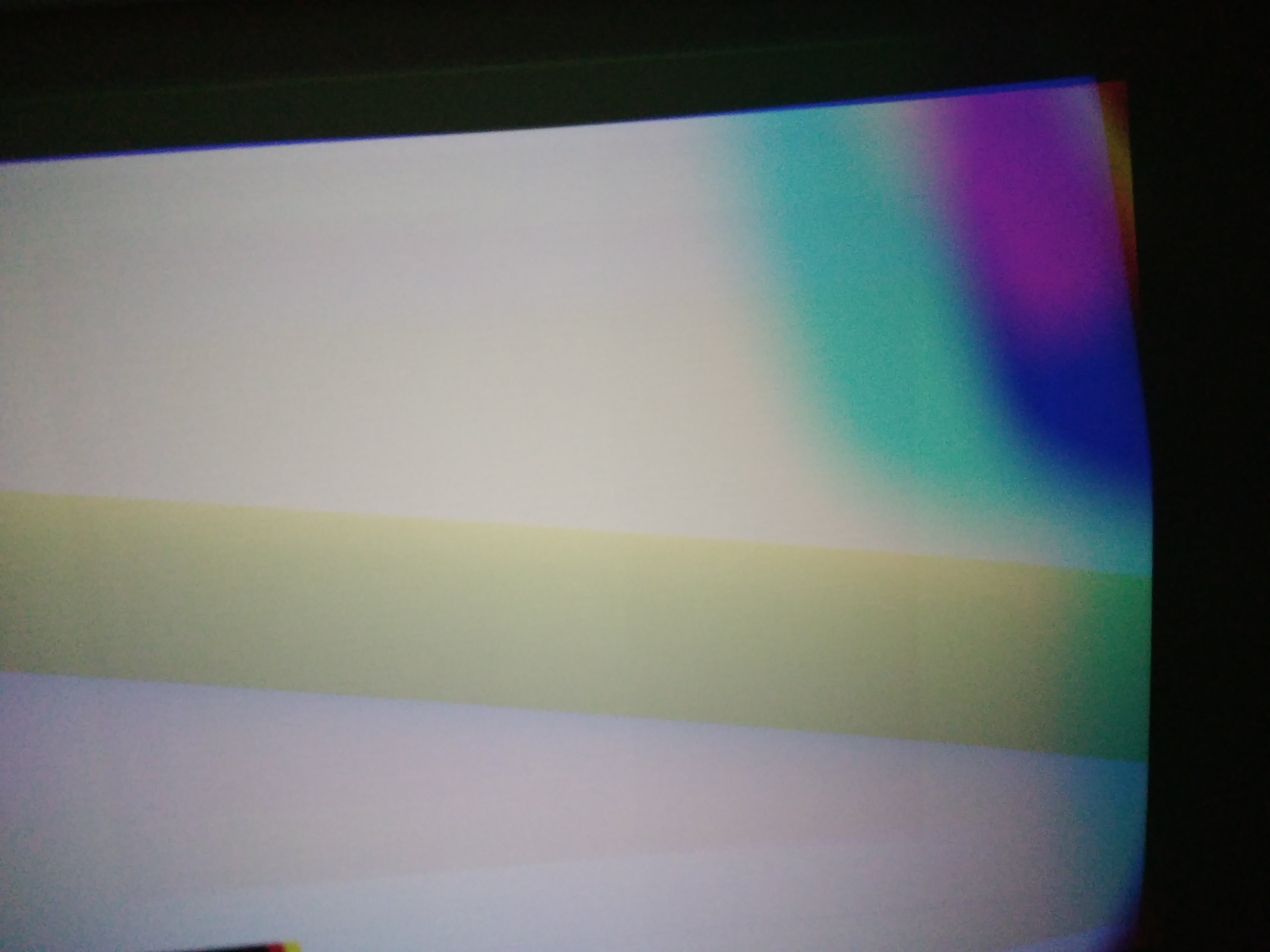

Posted: Fri Feb 09, 2018 12:09 am    Post subject:
Thanks for the tips so far
I took some pictures of the image it is putting out right now
They are not the best pictures but as the one picture shows even with the bias which i think is brightness turned all the way down the image still looks very green.
 Filename:  IMG_20180208_185313.jpg

rosenbush
Joined: 14 May 2010
Posts: 94
Location: Brownsville Texas
Posted: Sat Mar 24, 2018 1:59 am    Post subject:
May be the problem on the Red & blue Tubes? too dimm?
