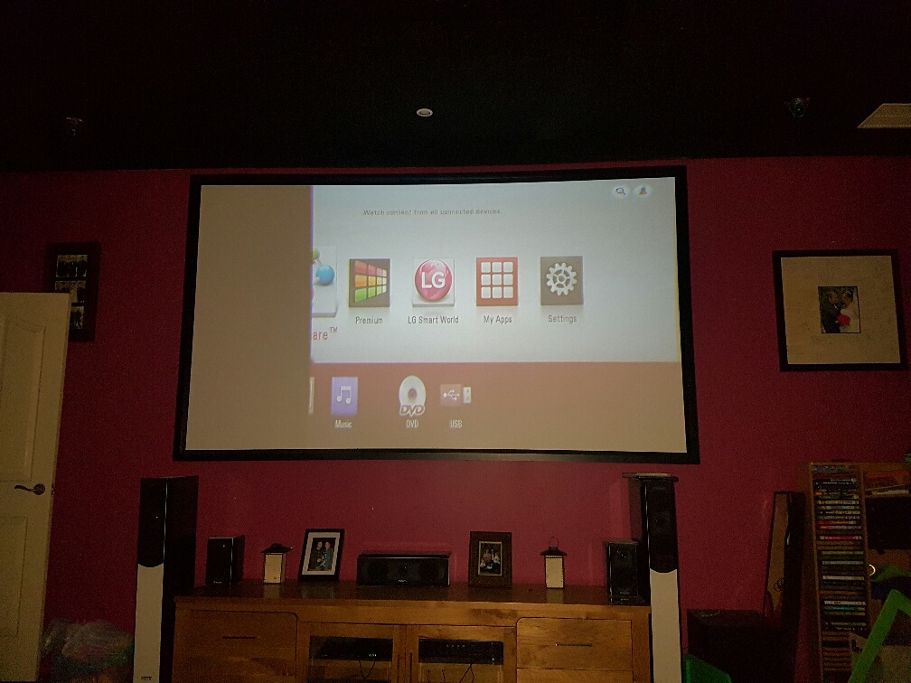

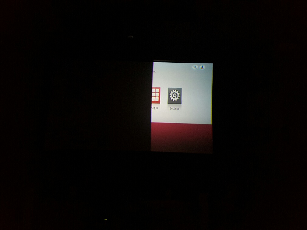

Hi i have a barco 808 and when i fire up the projecter the picture is taking longer than usual to appear and then when it does appear i only get half the picture initially but after time the picture will start to appear coming from right to left i have attached some pics

Posted: Thu Jan 18, 2018 11:32 pm    Post subject:
Check the 17 volt supply test point on the power supply, and adjust as required. I think it may be off. The main website shows how to do it.
if that's not it, then check your blanking settings in the geometry menu. Worst case, your vertical board may be bad, as that's where the blanking is located.
