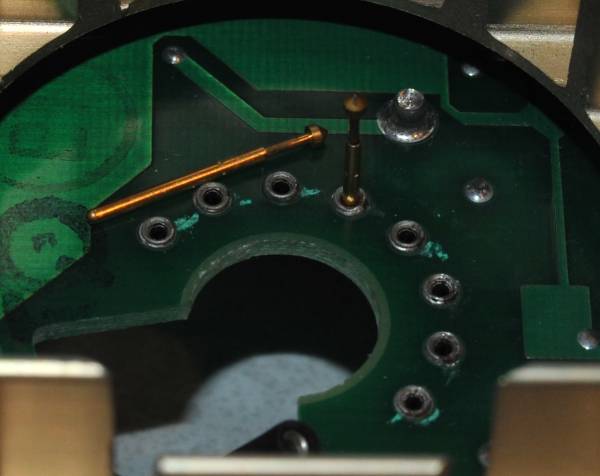

Pogo pin is just the right diameter for a socket, but about 5mm too long. Depends on how deep you'd have to go though. Did you say that pin has its own lead though? The length problem goes away but you'd have to find a way to hold it in place. I've sanded down the tip to a needle point to get through solder mask to get at programming pins.. love these little things.
Other than that, I don't know.. If enough of the pin is still sticking through the glass you can try to crimp a bare female pin connector around it to extend a new pin. Then secure with epoxy.
Good luck.
