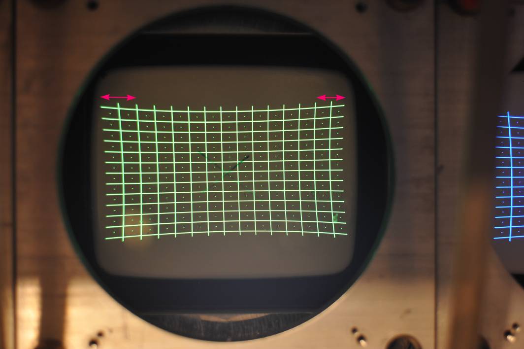

Attached is a test pattern. All projector settings are nulled, no blanking. I only set the flare/astig/focus on the green tube. The distance between vertical lines starts wide on the left and gradually gets closer together on the right. The right side horizontal scan also seems to stop short of the full image width, and there is a bright bar on the last "pixel" column (doesn't show up well in pictures). In the past I've just set the blanking to 1 and it gets hidden. This is true of all 3 colors.
I usually have to either shift the image on the raster or shift the screen. If I put the test grid center point on the screen center point, then the left side hangs over the border and the right side comes up short. The screen is aligned pretty close to perfect (and besides, the linearity problem can be seen on the tube face).
Is this fixable? Or just something to put up with for owning a mid-tier CRT?

I'm quite sure the bright line on the edge is normal for a 8000.
As for the linearity, while everything at midpoint see if unplugging the corresponding convergence yoke makes any difference? If not, then it's the HDM.

What about using the horizontal linearity controls in the geometry menu?
Or is it that the 8000 doesn‘t have them?
In this case, a chassis upgrade to a 9500 would be a big plus...

Indeed the Horizontal linearity adjustments were introduced with the CLM V3.3 software, which was well past M8000 times.

Yep, no horizontal. I got excited when I saw a screenshot somewhere that had vertical and horizontal and thought I hadn't noticed it while looking at the backwards image on my tube face. Alas, there was only vertical.
Removing convergence didn't help. I can live with it. I might be upgrading soon! Thanks gjaky and barclay.

Well, you can also put the 8" tubes right into your 9500 chassis with the mounting plates from the 8000 until (if ever) you replace the 9" tubes, this is something like a 1 hour work (not including projector mounting issues)
