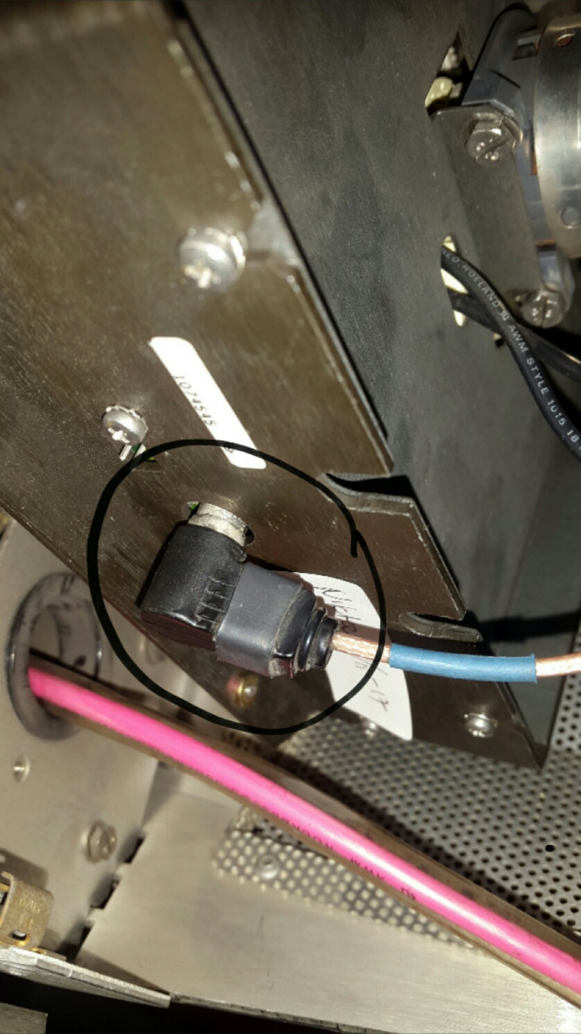

Posted: Sat Dec 02, 2017 3:42 am    Post subject:
sukwoto wrote:
Not if there is a glow at the base of the tubes. That's just incorrect advice.
As I mentioned before, you now have to get in there with a meter and measure voltages to see where you are missing a signal from.
Would you please to explain " 6 volt supply coming from the main power supply (SMPS) that goes to each 762292 board to supply the filament voltage"...which one cable should be checking
Thank you
checking this cable?
 Filesize:  303.57 KB
 Viewed:  3952 Time(s)
Posted: Wed Dec 06, 2017 5:15 am    Post subject:
sukwoto wrote:
Thank you
That cable would be for video not a cable for voltages. The cables that carry voltage are located at the other connector that runs from the mother board (Frame) to that RGB amp. They are usually yellow wires on Barco projectors (except 9 series). I don't have a manual for that projector so I can't say which wire it would be.
