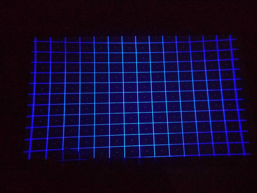

Posted: Tue Dec 05, 2017 12:55 pm    Post subject:
CJ, the issue is not optical, I've checked the tube face and I see the same thing.
I replaced the caps today and noticed that I can get a tighter focus on the tubes! However, the blue problem persists. The left and right zone of the focus doesn't make any change to picture at all. I tried swapping the blue and red cables going to the focus module and the distortion moved to red. Obviously there's a problem in the board, but I'd really like to figure it out as I've gone and recapped the thing now.
Thanks, Eemil

dvh99
Joined: 25 Dec 2009
Posts: 2158
Location: nederland
Posted: Tue Dec 05, 2017 3:11 pm    Post subject:
swap the focus connector from the blue and green and see if the problem goes from the blue to the green tube.
if so some fets needs to be replaced iirc on the fgm.

Posted: Tue Dec 05, 2017 3:59 pm    Post subject:
If you can't adjust any outer zone focus, you have no focus signal getting to the dynamic winding.
Central focus is only a DC signal going to the static winding. All outer zone focus is a waveform amplified on the focus board and sent to the dynamic winding.
It's not impossible that you may have a bad focus yoke with an open dynamic winding but I've never actually seen that happen. The focus signal power level is low and unlikely to burn out a dynamic winding.
Move the focus plug to the green channel and when you then try to adjust green focus, see if blue focus changes.

Great idea Dvh! I don't see any darkening on the fets but I'll go and test them!
CJ, Tube & coils seem fine. As I said when I swapped the connectors I could tighten the dynamic focus areas on blue.
Eemil

Small update: tested the mosfets, all returned good. Wanted to confirm this so quickly swapped green and blue channel's fets Laughing
Anyhow, that fixed nothing.
Gjaky: I'm sure that's not the case as swapping the cables between tubes gives nice focus for blue and any color thats connected into the blue channel on FCM gets the unresponsive dynamic focus.
Just too bad that I don't have a swap FCM. Sad

Posted: Tue Dec 05, 2017 7:17 pm    Post subject:
OK.
Maybe is this applies to you?
http://www.curtpalme.com/docs/ElectrohomeMarqueeTechnicalBulletin_Tb98-02.pdf
Meemil
Joined: 25 Mar 2016
Posts: 96
Location: Finland
Posted: Tue Dec 05, 2017 8:00 pm    Post subject:
gjaky wrote:
OK.
Good catch! I think I've seen this before but totally dismissed it. Laughing
This actually applies to me because I have issue 1 FCM! I'll check the components mentioned.
Thanks a ton!
