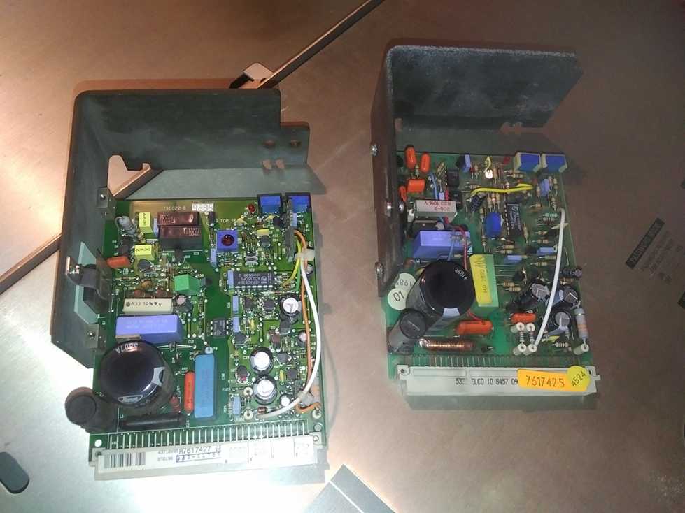

Reason for mentioning the acquired 1200 is because I want to try swapping parts between it and the 808s. Below is a photo of the 808s EHT on the left, the 1200 EHT on the right. They don't look identical, but fairly similar, is it possible for me to try the 1200's EHT board in the 808s?
If that fails then I'll try the 1200's HV quad in the 808s, if able?

EHT boards from 808s on the left, 1200 on the right

Posted: Tue Dec 11, 2018 1:54 am    Post subject:
I can't remember if you can swap them or not, sorry, I think you can, but it's been so long since I've tried it, but I don't know for sure.
Posted: Tue Dec 11, 2018 9:20 am    Post subject:
They are interchangeable. If i recall correctly you have to resolder a jumper on the frame for the later EHT. If you don't change the jumper the EHT will not operate.
That jumper change should be somewhere in the forums.

Swapping with this EHT board, I did it successfully, some time ago.
http://www.curtpalme.com/forum/viewtopic.php?p=441134 was this thread but about another issue...
The quad R761743 too. It is just don't fit the the mounting hole properly, but it's the same as the 091 quad.
Robin
