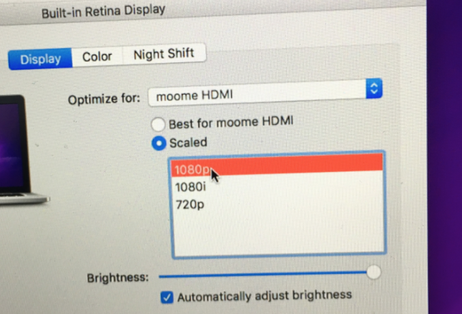

Configuration #1 Macbook Pro set to 720p (tried 1080 as well) through HDMI cable to Moome input directly. Moome is recognized by MBP and best setting is chosen. Moome input port chosen by external switch which moves through the 4 inputs when pressed.

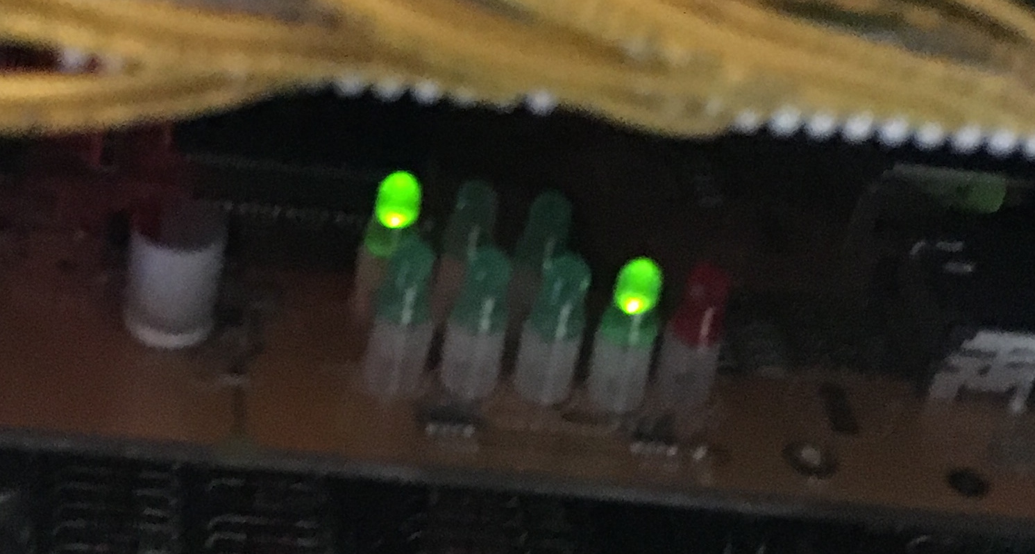

REMOTE CONTROL DOES NOT CONTROL INPUTS....is that not an indication of a board failure?

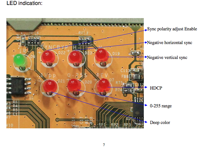

LEDs on board are different from LEDs in manual in color and number. This is the state of the LEDs as shown in the photo.
Without Moome I can run Port 5 from RGBHV and from Port 3 I can run RGBHV as well.
This is from the manual
 Filesize:  386.74 KB
 Viewed:  16654 Time(s)
The state of the LEDs, note number and color are different from manual.

Posted: Thu Sep 21, 2017 5:05 pm    Post subject:
Hello, Barry:
when you use the HDMI remote controller,
you need aim to the control kit, and turn the H- V- LED light up refer the manual step.

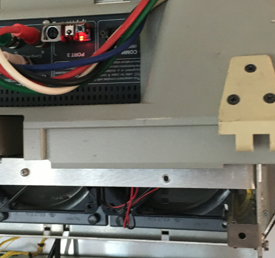

The projector IR port is adjacent to the dongle (assume that is the control kit) so it also sees the IR from the remote and the red LEDs on the projector control card react when I press the remote button so I know it is sending something for sure.
The MacBook pro is communicating and recognizing the Moome card when input 1 is selected using the switch on the dongle. When using the remote to change inputs there is no click and the moome input port does not change.
NOTE: IR port for projector in in the lower right below the dongle. Normally I an about 3' away and both should be getting IR signal.
 Filesize:  438.1 KB
 Viewed:  16642 Time(s)
MacBook Pro when on input 1 shows it recognizes and communicating with Moome card.
 Filesize:  439.75 KB

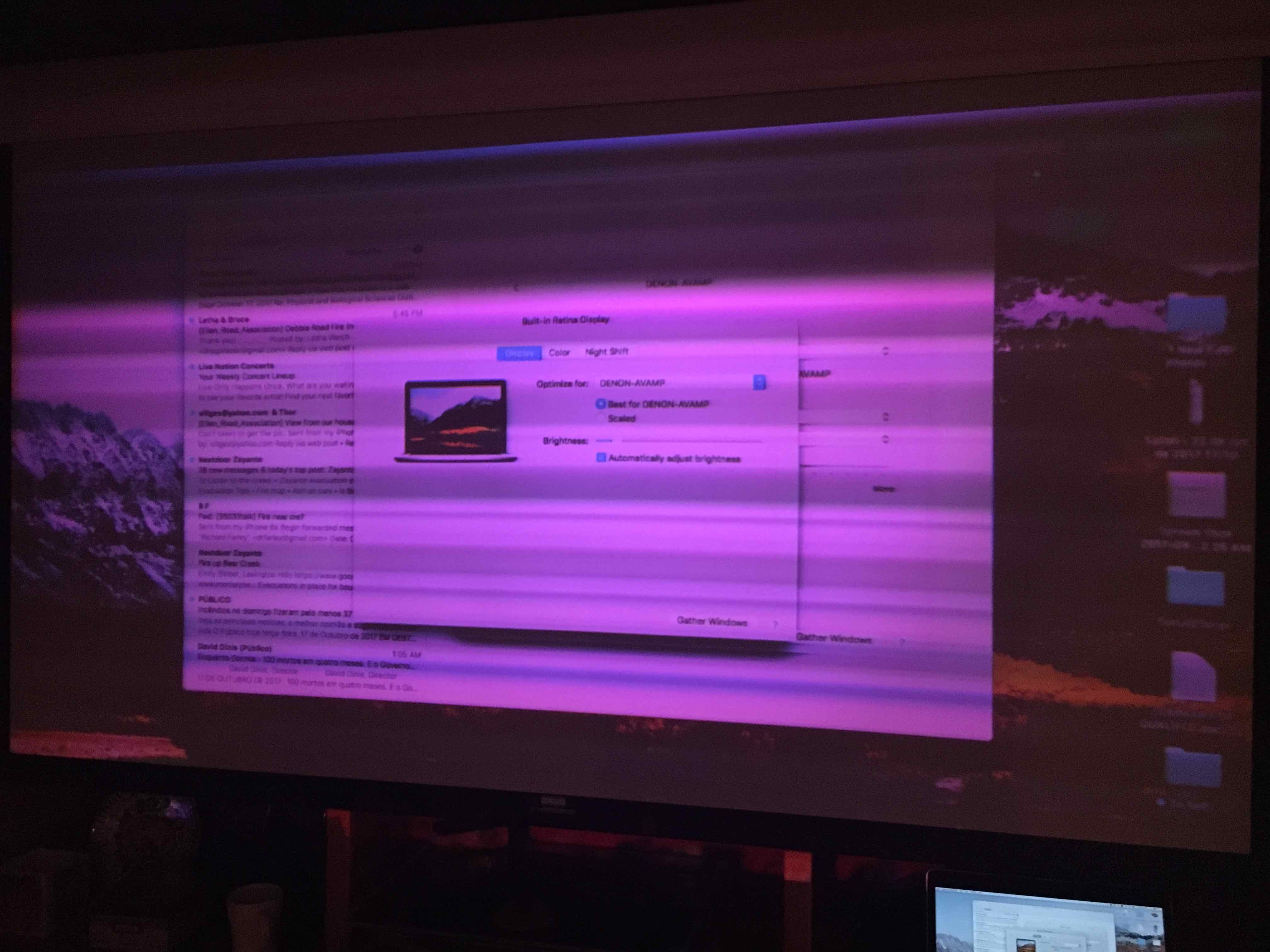

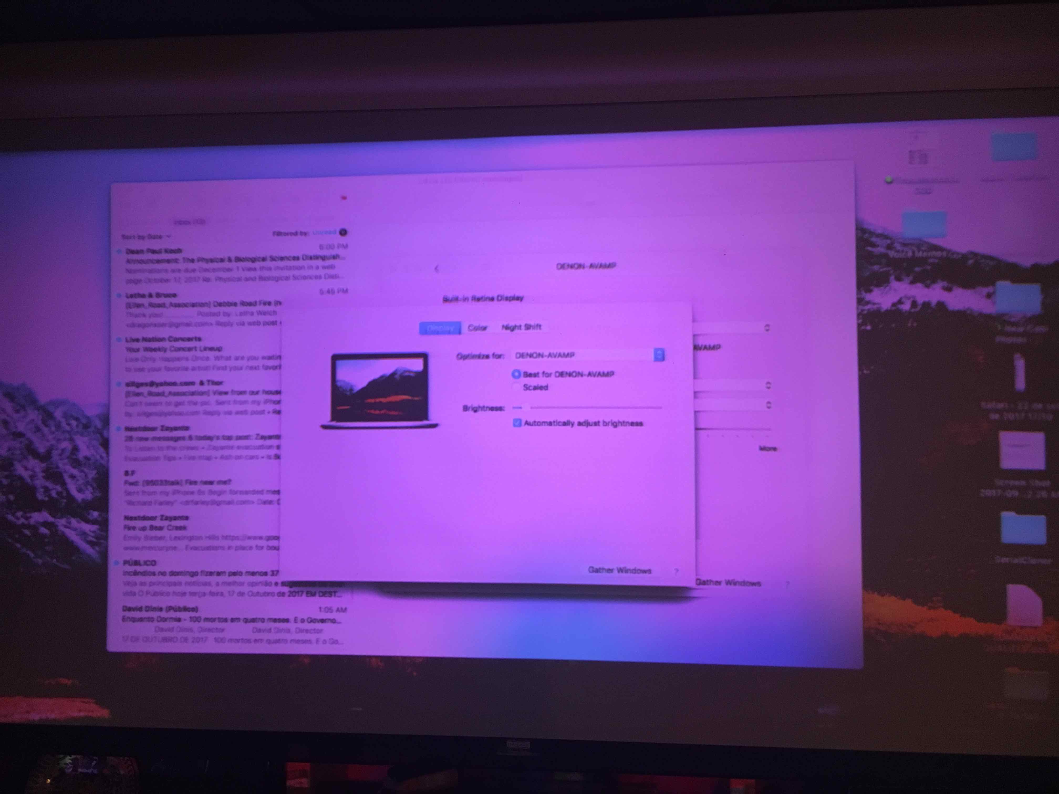

I go through horizontal sync polarity issue with the new Moome card (first was clearly defective). As I stated I first tried and got an image using the MacBook Pro HDMI output directly. I then switched to the Lumagen Vision HDP as shown:
MBP-HDMI > Denon AV Amp > Distribution Amp/ Stripper > Lumagen Vision HDP > DVI Out > Moome Port 1 input. (Lumagen set to 1080P, Horiz is about 60Hz)
The only change form what I usually use is that I no longer go RGBHV > Barco Port 3
I do get my image but it had horizontal bars and color shift to magenta (see pic)
I played with the Horizontal Phase and was able to get rid of the bars but not the color issue. (see pic)
After adjusting Horizontal shift.

This was before adjusting Horizontal phase

Please try a different color space on the Lumagen.
Barco Cine 9 the one and only
Posted: Wed Oct 18, 2017 11:59 am    Post subject:
Yep. That's not a flat image, that's a completely incorrect image (wrong colour space). It's pink.

Yup, it was color space mismatch. The Lumagen is set for RGB444 and the Moome was not. I suspect I flipped through the color space options when debugging my lost picture and left it on the wrong one. I can see the colors are back and just need to wait for dark tonight to further adjust. Thanks guys!

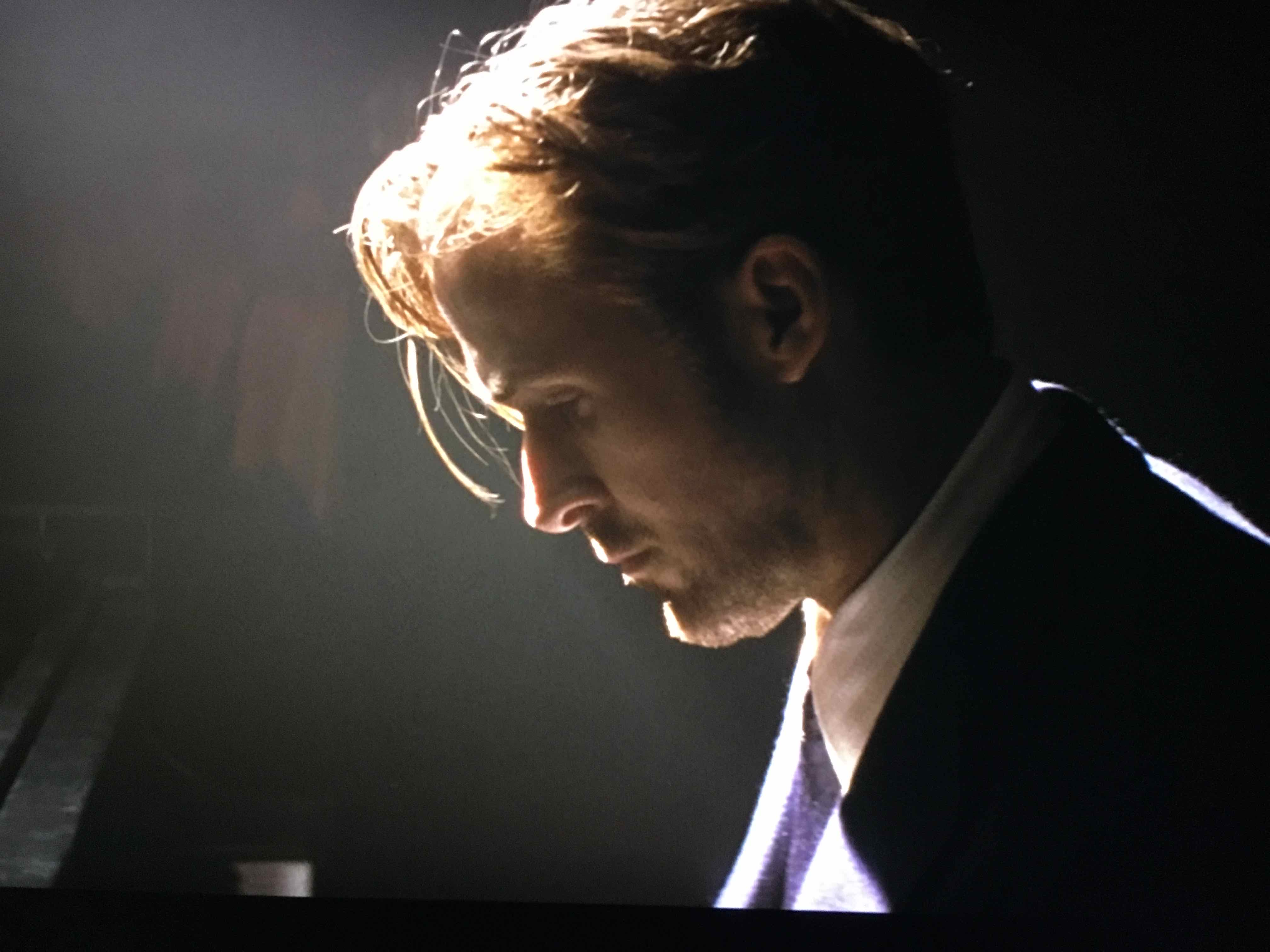

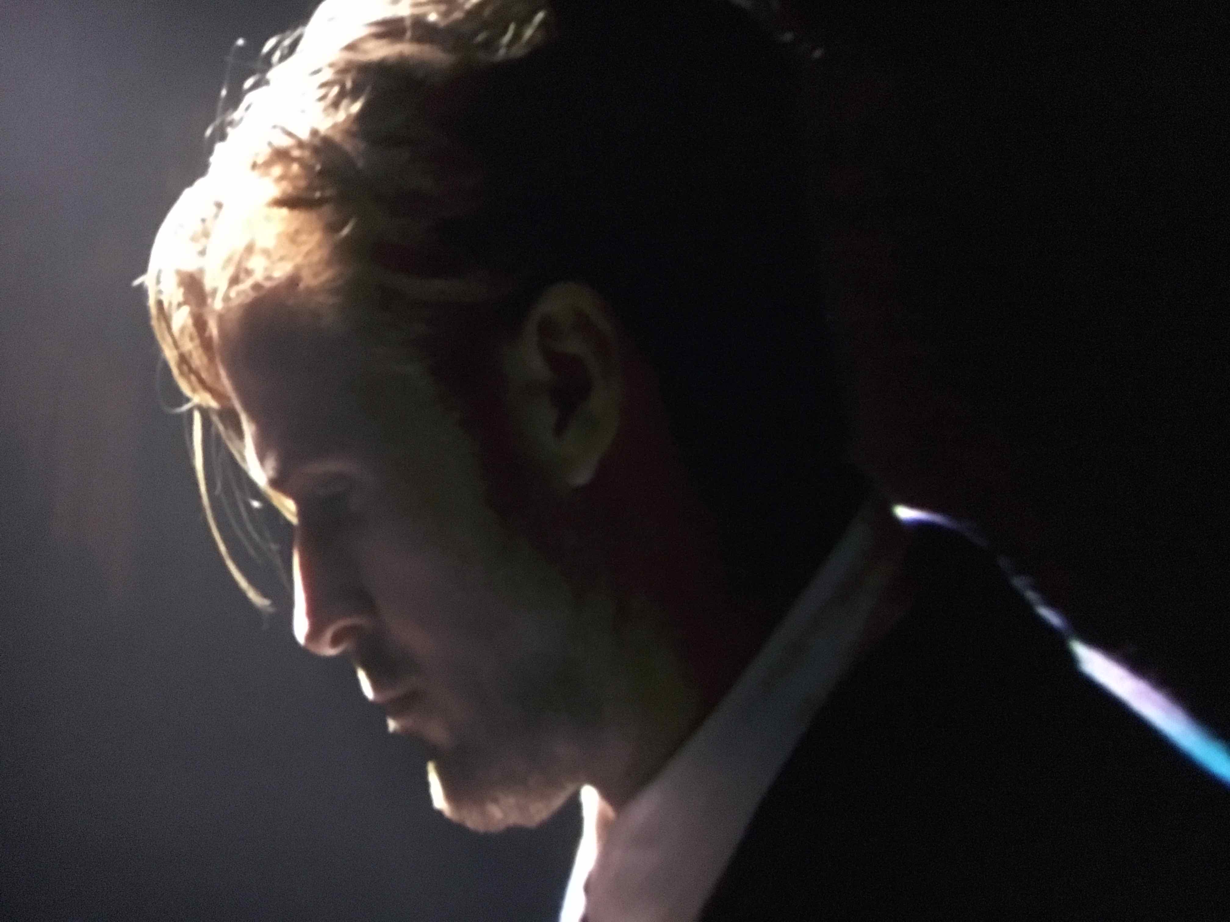

I am still running through the adjustments to get the Moome to work with the LumagenHDP and MacBook Pro. After endless playing with the projector (Barco 1209) Contrast and Brightness along with the more flexible controls in the Lumagen I have reasonable picture for movies. It still needs some work getting it to sparkle more. Interestingly, when displaying the Mac screen there is a lot of white crush when movies seem optimized. I am not sure why that is as it did not show that what went driven by Lumagen analog stages.
A second issue I noticed I would normally attribute to compression artifacts. In some dimly lit spaces there is and odd flattening of the image and color that one does not see on the computer screen. Am attaching both pics. Look at the neck area and side burns. One had reddish blotching, the other has normal details. If is much more obvious in person. No adjustments I could find would affect this. Any ideas?
This is same but from MacBook Screen
 Filename:  IMG_6465.jpg

Picture on the screen, not red blotches lacking detail on the side burns and neck
