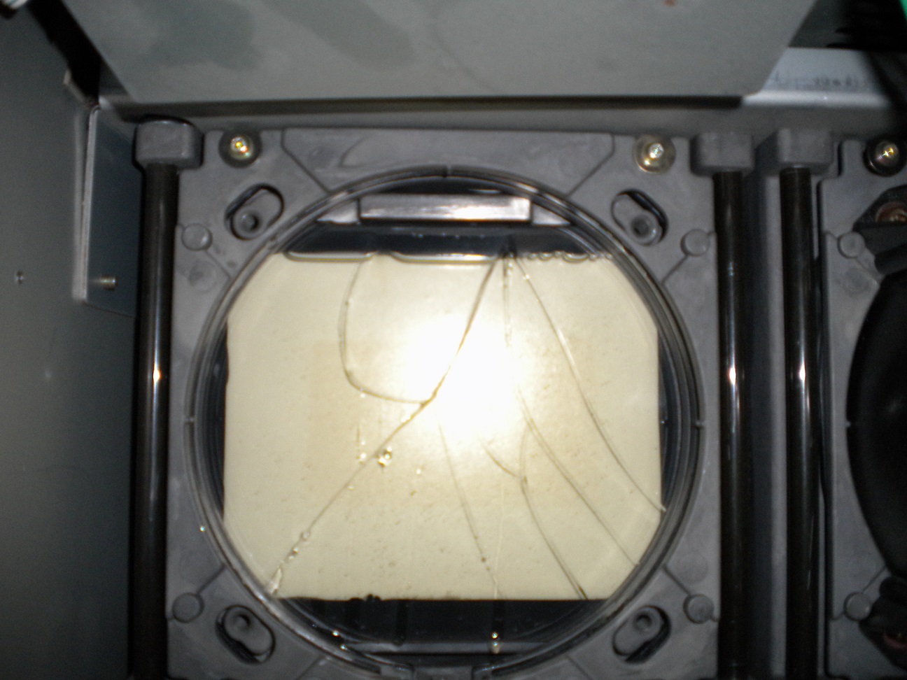

Hi folks,
last night the nightmare became true. Crying or Very sad
I started a project https://circuit-board.de/forum/index.php/Thread/24473-Wechsel-von-R%C3%B6hre-auf-CRT-Beamer/ to use my projector for old game consoles and during setup the glas of the blue tube (P16LJE909BMB) cracked. I don't know why - the temperature was realy fine and i think it was because of the age of the projector.
I searched for a replacement but didn't found anything. Is there any chance to get a blue tube for this projector or is this the end?
I hope someone can help me. I live in Austria and here it is hard to find any replacement for CRT projectors.
 Filesize:  286.68 KB
 Viewed:  6132 Time(s)

Are you sure the tube itself also got broken? Most of the time only the front glass breaks, that is the lesser problem as it can be replaced more easily (but still PITA).

Ok. I didn't know that only the front glas can also be broken.
A little from the glycol was running out. i will check that at home.
How can i repair the front glas?

Because of the ceiling mount the glycol shouldn't got in contact with any circuit.
So to replace the front glas - can i go to my local glazier's workshop? Should i use glas or polycarbonate?

Now I must disassemble the blue tube for replacing the glas. I have read the guide but how difficult is it? Do i need to get the projector on the floor or can it be done on the ceiling?
Posted: Thu Sep 14, 2017 6:13 pm    Post subject:
You need to separate the blue tube from the set, but you can do that with the projector on the ceiling at least.
Removing the broken glass is easy, removing an intact glass without damage is more difficult Wink
Posted: Thu Sep 14, 2017 7:52 pm    Post subject:
that most likely happened due to excess pressure in the glycol. While you have the set apart, also pull the green and red tubes, and bleed the excess pressure from the tube via the sealed Philips screws on the side of the front housing.
